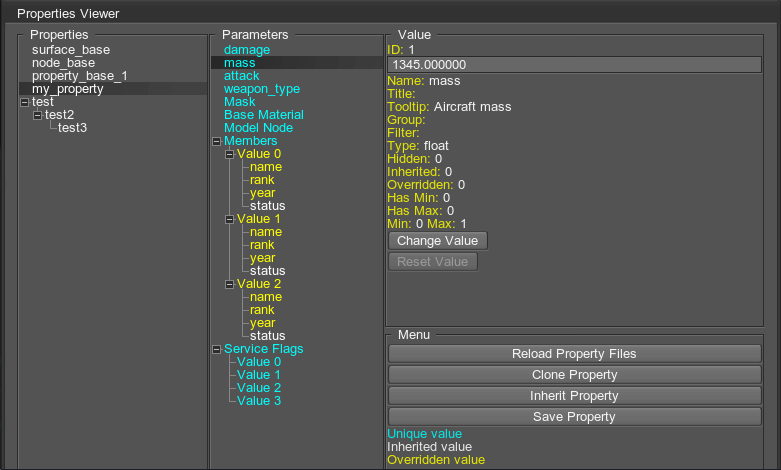

To illustrate how properties and their parameters are managed let's make a simple viewer for all properties in the project as well as for their parameters. Our viewer will have the following features:
  • View the list of all properties used in the project.
  • View the list of parameters of the currently selected property. Inherited, overridden and unique parameters are displayed in different colors.
  • Change the value of the selected property parameter.
  • Reset the value of the selected property parameter.
  • Inherit a new property from the selected one.
  • Clone the selected property.
  • Save the currently selected property to a file.
  • Reload all properties.
We can add the the following *.prop files to the data folder of our project to check our viewer:

Below is the source code in C++ implementing our Property Viewer. You can copy and paste it to the corresponding files of your project.

	gui->addChild(window->getWidget(), Gui::ALIGN_OVERLAP);
	vbox2 = WidgetVBox::create(gui);
	window->addChild(vbox2->getWidget(), Gui::ALIGN_EXPAND);
	hbox = WidgetHBox::create(gui);
	vbox2->addChild(hbox->getWidget(), Gui::ALIGN_EXPAND);
	properties_gb = WidgetGroupBox::create(gui, "Properties");
	parameters_gb = WidgetGroupBox::create(gui, "Parameters");
	hbox->addChild(properties_gb->getWidget(), Gui::ALIGN_EXPAND);
	hbox->addChild(parameters_gb->getWidget(), Gui::ALIGN_EXPAND);
	properties = WidgetTreeBox::create(gui);
	parameters = WidgetTreeBox::create(gui);
	properties_gb->addChild(properties->getWidget(), Gui::ALIGN_EXPAND);
	parameters_gb->addChild(parameters->getWidget(), Gui::ALIGN_EXPAND);
	vbox3 = WidgetVBox::create(gui);
	hbox->addChild(vbox3->getWidget(), Gui::ALIGN_EXPAND);
	value_gb = WidgetGroupBox::create(gui, "Value");
	value_gb->setWidth(300);
	value_gb->setHeight(300);
	value_gb->arrange();
	menu_gb = WidgetGroupBox::create(gui, "Menu");
	vbox3->addChild(value_gb->getWidget(), Gui::ALIGN_LEFT);
	vbox3->addChild(menu_gb->getWidget(), Gui::ALIGN_EXPAND);
	label.append() = WidgetLabel::create(gui, "");
	label.last()->setFontRich(1);
	value_gb->addChild(label.last()->getWidget(), Gui::ALIGN_LEFT);
	value = WidgetEditLine::create(gui);
	value_gb->addChild(value->getWidget(), Gui::ALIGN_EXPAND);
	for (int i = 0; i < 12; i++)
	change = WidgetButton::create(gui, "Change Value");
	value_gb->addChild(change->getWidget(), Gui::ALIGN_LEFT);
	reset = WidgetButton::create(gui, "Reset Value");
	value_gb->addChild(reset->getWidget(), Gui::ALIGN_LEFT);
	reload = WidgetButton::create(gui, "Reload Property Files");
	clone = WidgetButton::create(gui, "Clone Property");
	inherit = WidgetButton::create(gui, "Inherit Property");
	save_prop = WidgetButton::create(gui, "Save Property");
	menu_gb->addChild(reload->getWidget(), Gui::ALIGN_EXPAND);
	menu_gb->addChild(clone->getWidget(), Gui::ALIGN_EXPAND);
	menu_gb->addChild(inherit->getWidget(), Gui::ALIGN_EXPAND);
	menu_gb->addChild(save_prop->getWidget(), Gui::ALIGN_EXPAND);
	info = WidgetLabel::create(gui);
	info->setFontRich(1);
	info->setText(
		"<font color=00ffff>Unique value</font><br>"
		"<font color=ffffff>Inherited value</font><br>"
		"<font color=ffff00>Overridden value</font><br>");
	menu_gb->addChild(info->getWidget(), Gui::ALIGN_LEFT);
	prop_info = WidgetLabel::create(gui);
	menu_gb->addChild(prop_info->getWidget(), Gui::ALIGN_LEFT);
	// setting callbacks for UI elements
	properties->addCallback(Gui::CHANGED, MakeCallback(this, &AppSystemLogic::properties_changed));
	parameters->addCallback(Gui::CHANGED, MakeCallback(this, &AppSystemLogic::parameters_changed));
	change->addCallback(Gui::CLICKED, MakeCallback(this, &AppSystemLogic::change_clicked));
	reset->addCallback(Gui::CLICKED, MakeCallback(this, &AppSystemLogic::reset_clicked));
	reload->addCallback(Gui::CLICKED, MakeCallback(this, &AppSystemLogic::reload_clicked));
	clone->addCallback(Gui::CLICKED, MakeCallback(this, &AppSystemLogic::clone_clicked));
	inherit->addCallback(Gui::CLICKED, MakeCallback(this, &AppSystemLogic::inherit_clicked));
	save_prop->addCallback(Gui::CLICKED, MakeCallback(this, &AppSystemLogic::save_prop_clicked));
	refresh_properties();
/// method refreshing properties
void AppSystemLogic::refresh_properties()
	properties->setCallbackEnabled(Gui::CHANGED, 0);
	properties->clear();
	item_prop.clear();
	// recursive function iterating through all children properties and building property hierarchy
	std::function<void(int, const PropertyPtr &)> attach_children = [&, this](int parent, const PropertyPtr &prop_parent)
		for (int k = 0; k < prop_parent->getNumChildren(); k++)
			PropertyPtr prop = prop_parent->getChild(k); prop->setParameterInt(0, 1); prop->getParameterPtr();
			if (prop != prop_parent && prop->getParent() && prop->getParent() == prop_parent)
				int child = properties->addItem(prop->getName());
				properties->addItemChild(parent, child);
				item_prop.append(child, prop);
				attach_children(child, prop);
	// building property hierarchy
	for (int i = 0; i < Properties::get()->getNumProperties(); i++)
		PropertyPtr prop_base = Properties::get()->getProperty(i);
		if (prop_base->isBase())
			int parent = properties->addItem(prop_base->getName());
			item_prop.append(parent, prop_base);
			attach_children(parent, prop_base);
	properties->setCallbackEnabled(Gui::CHANGED, 1);
/// method refreshing property parameters
void AppSystemLogic::properties_changed()
	parameters->setCallbackEnabled(Gui::CHANGED, 0);
	// clearing the list of propety parameters and updating values displayed
	parameters->clear();
	value_gb->setEnabled(0);
	for (int i = 0; i <= 12; i++)
		label[i]->setText("");
	item_param.clear();
	int item = properties->getCurrentItem();
	if (item == -1)
		parameters->setCallbackEnabled(Gui::CHANGED, 1);
		return;
	// getting a property from the list in accordance with current selection
	PropertyPtr prop = item_prop[item];
	// getting a root parameter of the selected property
	PropertyParameterPtr pp = prop->getParameterPtr();
	// recursive function iterating through all parameters of a property
	std::function<void(int, const PropertyParameterPtr &)> add_parameters = [&, this](int parent, const PropertyParameterPtr &p)
		for (int i = 0; i < p->getNumChildren(); i++)
			PropertyParameterPtr child = p->getChild(i);
			int child_index = parameters->addItem(child->getName());
			parameters->setItemColor(child_index,
				vec4(
				itof(child->isInherited()),
				1,
				itof(!child->isOverridden()),
				child->isHidden() ? 0.5f : 1.0f));
			item_param.append(child_index, child);
			if (parent != -1)
				parameters->addItemChild(parent, child_index);
			add_parameters(child_index, child);
	// building the hierarchy of parameters for the selected property
	add_parameters(-1, pp);
	// preparing property information
	String pi = String::format("\nName: %s\nPath: %s\nInternal: %d\nStructs: %d\n", prop->getName(), prop->getPath(), prop->isInternal(), prop->getNumStructs());
	// adding all structures defined in the property (if any)
	for (int i = 0; i < prop->getNumStructs(); i++)
		pi += String::format("%d) %s\n", i, prop->getStructName(i));
	// displaying property information
	prop_info->setText(pi.get());
	parameters->setCurrentItem(-1);
/// method refreshing information about the currently selected property parameter
void AppSystemLogic::parameters_changed()
	// checking if any property parameter is selected
	int item = parameters->getCurrentItem();
	if (item == -1)
		return;
	value_gb->setEnabled(1);
	// getting the parameter from the list in accordance with current selection
	PropertyParameterPtr p = item_param[item];
	int i = 0;
	label[i++]->setText(String::format("<font color=ffff00>ID:</font> %d", p->getID()));
	label[i++]->setText(String::format("<font color=ffff00>Name:</font> %s", p->getName()));
	label[i++]->setText(String::format("<font color=ffff00>Title:</font> %s", p->getTitle()));
	label[i++]->setText(String::format("<font color=ffff00>Tooltip:</font> %s", p->getTooltip()));
	label[i++]->setText(String::format("<font color=ffff00>Group:</font> %s", p->getGroup()));
	label[i++]->setText(String::format("<font color=ffff00>Filter:</font> %s", p->getFilter()));
	String s;
	// displaying parameter's type
	if (p->getType() == Property::PARAMETER_ARRAY)
		s = String::format("<font color=ffff00>Type:</font> array "
		"[<font color=ffff00>Size:</font> %d, <font color=ffff00>Type:</font> %s]", p->getArraySize(), p->getArrayTypeName());
	else if (p->getType() == Property::PARAMETER_STRUCT)
		s = String::format("<font color=ffff00>Type:</font> struct [<font color=ffff00>Struct Name:</font> %s]", p->getStructName());
	else
		s = String::format("<font color=ffff00>Type:</font> %s", p->getProperty()->parameterNameByType(p->getType()));
	label[i++]->setText(s.get());
	label[i++]->setText(String::format("<font color=ffff00>Hidden:</font> %d", p->isHidden()));
	label[i++]->setText(String::format("<font color=ffff00>Inherited:</font> %d", p->isInherited()));
	label[i++]->setText(String::format("<font color=ffff00>Overridden:</font> %d", p->isOverridden()));
	label[i++]->setText(String::format("<font color=ffff00>Has Min:</font> %d", p->hasSliderMinValue()));
	label[i++]->setText(String::format("<font color=ffff00>Has Max:</font> %d", p->hasSliderMaxValue()));
	s = "";
	if (p->getType() == Property::PARAMETER_INT)
		s = String::format("<font color=ffff00>Min:</font> %d <font color=ffff00>Max:</font> %d", p->getIntMinValue(), p->getIntMaxValue());
	else if (p->getType() == Property::PARAMETER_FLOAT)
		s = String::format("<font color=ffff00>Min:</font> %f <font color=ffff00>Max:</font> %f", p->getFloatMinValue(), p->getFloatMaxValue());
	else if (p->getType() == Property::PARAMETER_DOUBLE)
		s = String::format("<font color=ffff00>Min:</font> %f <font color=ffff00>Max:</font> %f", p->getDoubleMinValue(), p->getDoubleMaxValue());
	else if (p->getType() == Property::PARAMETER_SWITCH)
		s = String::format("<font color=ffff00>Switch Num Items:</font> %d", p->getSwitchNumItems());
	value->setText(p->getValueString().get());
	reset->setEnabled(p->isOverridden());
/// change button on_click event handler
void AppSystemLogic::change_clicked()
	// checking if any property parameter is currently selected
	if (item == -1)
		return;
	// setting the value of the currently selected property parameter and refreshing information
	PropertyParameterPtr pp = item_param[item];
	pp->setValue(value->getText());
	refresh_info();
/// reset button on_click event handler
void AppSystemLogic::reset_clicked()
	if (item == -1)
		return;
	// resetting the value of the currently selected property parameter and refreshing information
	pp->resetValue();
	refresh_info();
/// reload button on_click event handler
void AppSystemLogic::reload_clicked()
	// reload all properties and refreshing information
	Properties::get()->reloadProperties();
	refresh_info();
/// method refreshing property and parameter information
void AppSystemLogic::refresh_info()
	// getting current indices of property and parameter selection
	int item_pr = properties->getCurrentItem();
	int item_pa = parameters->getCurrentItem();
	// setting current items and updating information displayed
	properties->setCurrentItem(clamp(item_pr, -1, properties->getNumItems() - 1));
	properties_changed();
	parameters->setCurrentItem(clamp(item_pa, -1, parameters->getNumItems() - 1));
	parameters_changed();
void AppSystemLogic::clone_clicked()
	// checking if any property is selected in the hierarchy
	if (item == -1)
		return;
	// cloning the selected property
	PropertyPtr p = item_prop[item];
	PropertyPtr p_clone = p->clone();
	p_clone->setName(String::format("%s_cloned", p->getName()));
	// refreshing information displayed
	refresh_info();
/// inherit button on_click event handler
void AppSystemLogic::inherit_clicked()
	if (item == -1)
		return;
	// inheriting a new property from the selected one
	p->inherit()->setName(String::format("%s_inherited", p->getName()));
	refresh_info();
/// method saving the currently selected property to the "my_test_prop.prop" file
void AppSystemLogic::save_prop_clicked()
	if (item == -1)
		return;
	// saving a property to the specified file
	p->save("my_test_prop.prop");
int AppSystemLogic::update()
int AppSystemLogic::render()
	// Write here code to be called before rendering each render frame.
// end of the main loop
int AppSystemLogic::shutdown()
	// Write here code to be called on engine shutdown.
int AppSystemLogic::destroy()
	// Write here code to be called when the video mode is changed or the application is restarted (i.e. video_restart is called). It is used to reinitialize the graphics context.
