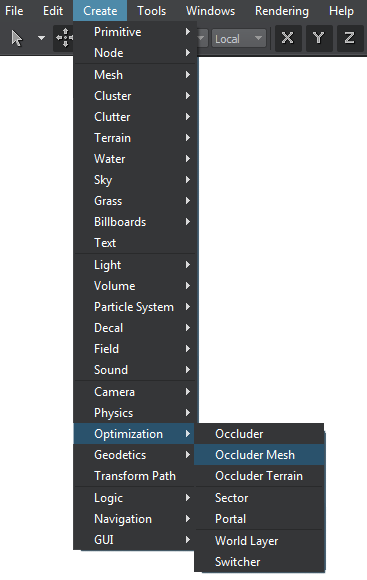

When the mesh is prepared, you can add the occluder mesh to the scene via UnigineEditor:
  2. On the Menu bar, click Create -> Optimization -> Occluder Mesh.
  3. In the file dialog window, choose a mesh (*.mesh) on which the occluder will be based.
  4. Place the occluder mesh in the world and specify the required parameters for it.

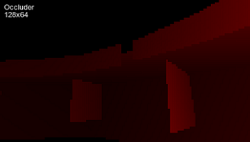

To display the buffer that is used for occluders displayed in the viewport, pass 1 to the render_show_occluder console command.

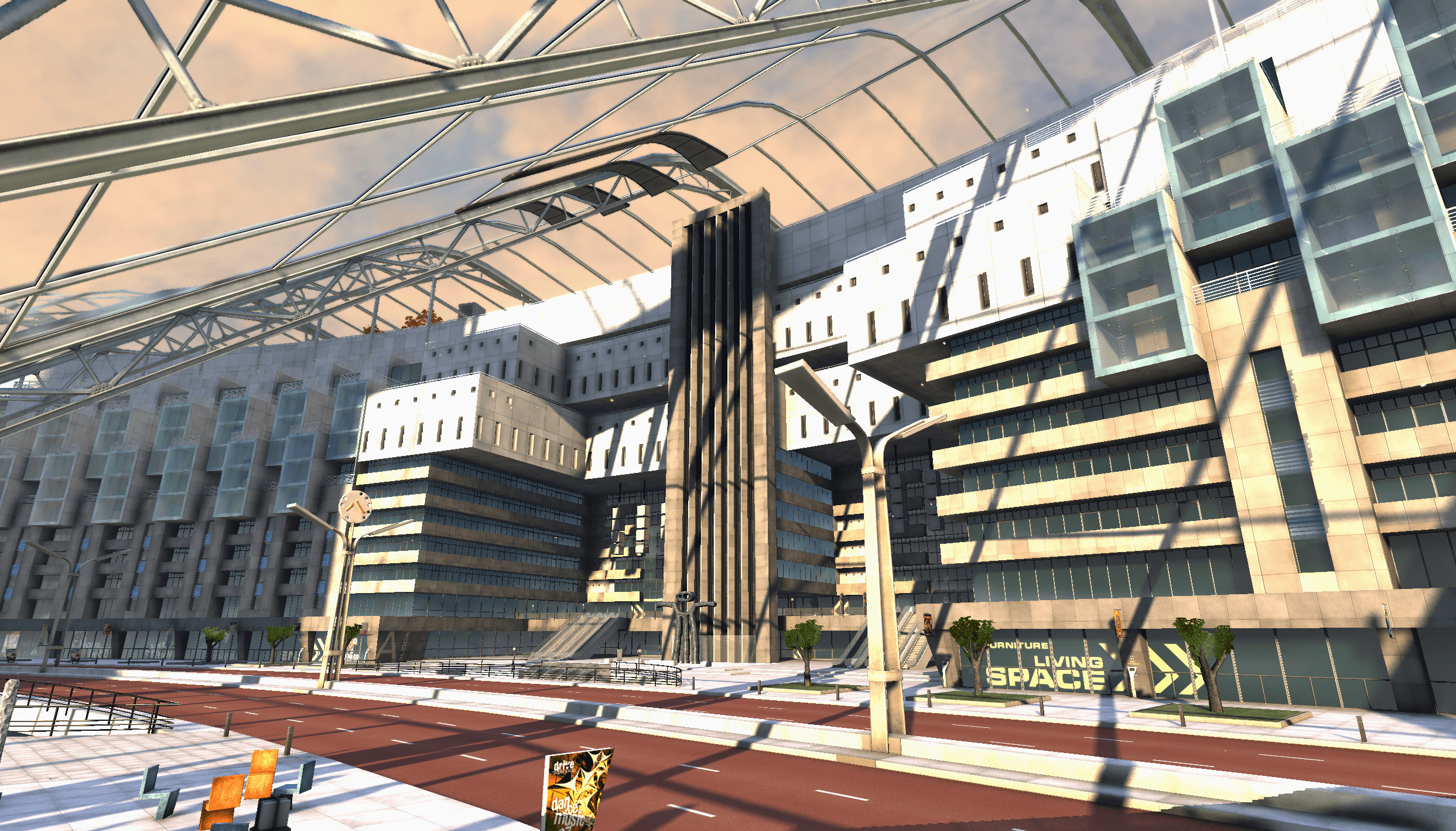

For example, if you have a building that occludes some objects' surfaces, you should prepare a simplified mesh to be used as a base for the occluder mesh instead of using the detailed mesh.
A mesh that represents a building and contains a lot of details

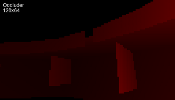

An occluder that is based on the simplified mesh and is rendered into a separate buffer with a low resolution

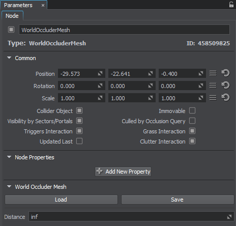

In the Node tab of the Parameters window, you can adjust the following parameters of the occluder mesh:
Distance Distance between the camera and the bounding box of the occluder, at which the occluder mesh becomes disabled. For example, you should disable the occluder at a certain distance if it stops hiding the objects and their surfaces in order to increase performance. By default, the inf value is used.
