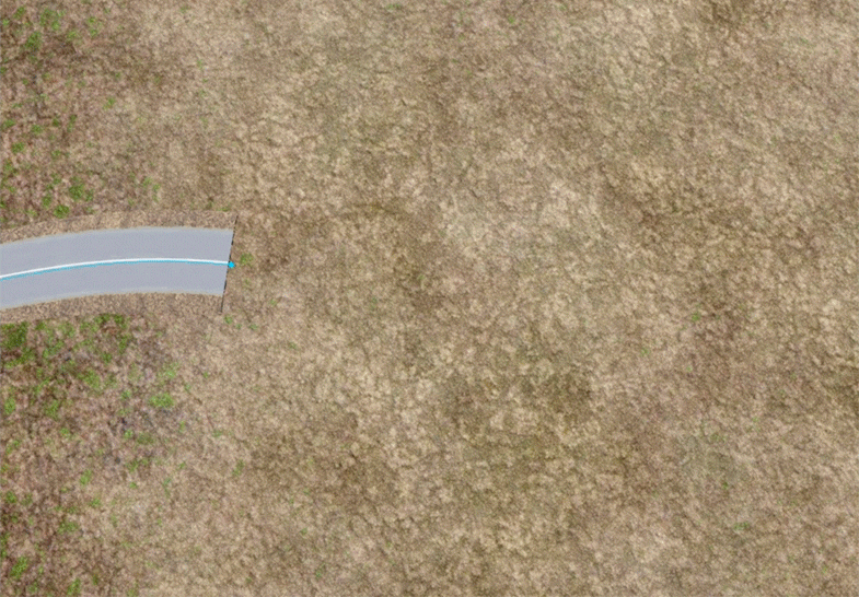

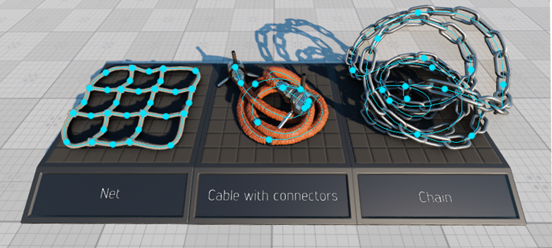

World spline graph is a convenient and performance-friendly method to place specified nodes (called source nodes) along a spline graph (its vertices and edges). It is not a single-purpose object designed just to create roads. It can also be used for ropes, chains, pipes, and any objects, having a form that follows a curved path. It is designed to help artists quickly build various complex structures from typical basic elements placed along spatial curves, such as pipes and tubes at an oil refinery, for example.

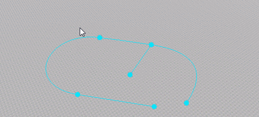

A spline graph is determined by a set of points p0, p 1, ... p n and a set of edges or segments (cubic Bezier splines), that connect some or all of these points.
Each segment is determined by a starting (pSTART ) and an ending (pEND ) point, as well as tangent vector coordinates at these points, which determine the curvature of the segment (tSTART and tEND respectively). Points, that are shared by more than two segments are called junctions.

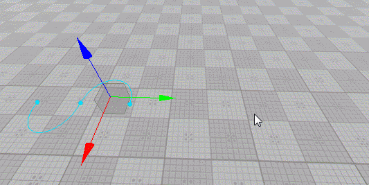

Coordinates of the UP vector are additionally stored for each point of the segment. This vector is used to define orientation of nodes placed along the segments of the spline graph. By default this vector is parallel to the Z axis. The UP vector does not affect the curvature of the spline segment itself.
UP vector adjustment.

    • world_spline_graph/ropes - ropes, chains and cables

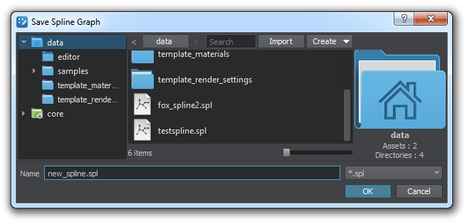

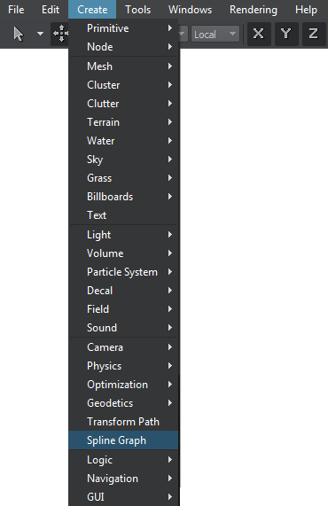

Creating a World Spline Graph#
To create a new world spline graph, do the following:
  2. Specify a name of existing spline file (*.spl) to be used for the new world spline graph or a new name to create your spline from scratch.
  3. Edit the spline graph by managing its points and segments.
  4. Assign desired source nodes to points and segments of the spline graph.

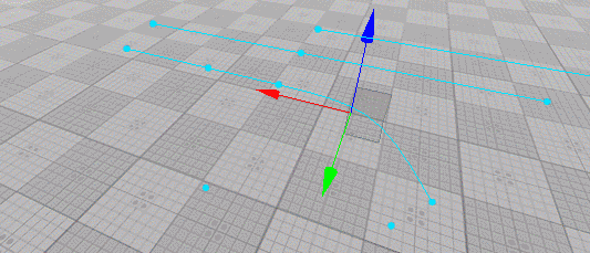

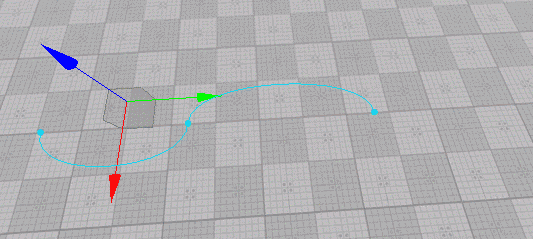

Adding a New Point#
New points are added to the spline graph by cloninng existing ones. To add a new point do the following:
  1. Select the world spline graph.
  2. Select the desired point, which you to clone (Move manipulator will appear).
  3. Press Ctrl + D on the keyboard (a new point will be created).
  4. Use the Move manipulator to position you new created point.

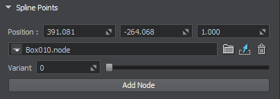

Adjusting Point's Position#
To adjust position of a point do the following:
  2. Select the desired point (Move manipulator will appear).
  3. Use the Move manipulator as you would do to move a node.

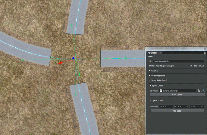

You can also adjust the position of the selected point via the Spline Points section of the Parameters tab:

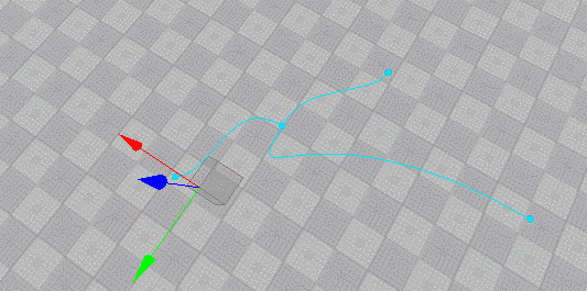

Adjusting Point's Tangent#
Tangents control the curvature of the spline segment. To adjust tangent at a point do the following:
  3. Select the desired tangent (in case the selected point is shared by multiple segments, several tangents will be displayed for it). As you select a tangent the Move manipulator appears next to it.
  4. Use the Move manipulator as you would do to move a node (the form of the corresponding segment will change).

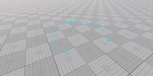

Merging Points#
Sometimes it might be necessary to merge certain points (e.g. to close a spline). To merge two or more points into one do the following:
  2. Select points you want to merge with a region selection tool or one-by-one while holding the Shift key pressed.
  3. Right-click on a point you want to merge selected ones into and choose Merge To This Point.
  4. All points will be merged into one shared by the segments, to which the merged points belonged.

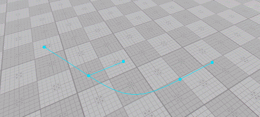

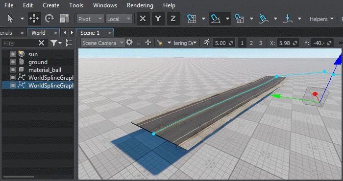

Adding a New Segment#
To add a new segment to the spline graph do the following:
  2. Select the starting point for the new segment to be added (Move manipulator will appear).
    • To create a straight segment, you should drag the manipulator in the direction of the tangent at the starting point.
    • The new added segment uses all settings (assigned nodes, placement modes and parameters) of the previous one.
You can also clone segment(s) by selecting them and moving with the Shift key pressed, or pressing Ctrl + D and placing the clone with the Move manipulator.

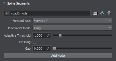

Workflow for Segments#
To assign a source node to selected segment(s) do the following:
  • Select the desired segments(s).
  • Click Add Node in the Parameters tab.
For each of the source nodes assigned to the selected segment(s) the following settings are available for adjustment via the Parameters tab:
Node Path to a *.node file containing a source node.
Forward Axis Defines which axis of the source node is to be oriented along the spline.
    This mode is the most performance-firendly.
  • Tiling - multiple instances of the source node are placed along the segment. The number of instances is determined by the sizes of the segment and the source node and the value of the Gap parameter.
  • Adaptive - a combination of the previous two resulting in multiple instances of the source node placed along the segment. Some of these instances may be stretched depending on segment's curvature.
UV Tiling Enables tiling of the source node's textures in the Stretch placement mode.
Available for Stretch placement mode only.

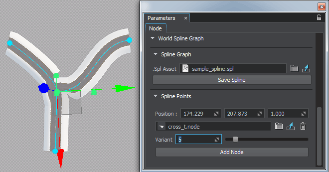

Workflow for Points#
To assign a source node to selected point(s) do the following:
  • Select the desired point(s).
For each of the source nodes assigned to the selected point(s) the following settings are available for adjustment via the Parameters tab:
Junctions#
Junctions should interact with all entering segments properly providing seamless transitions. For this puprose ObjectMeshSkinned source nodes are used.
Source nodes to be used for junctions must comply with the following requirements:
  • Joints of a junction in the UnigineEditor must have their Y axes oriented from the center of the junction to the edges of the corresponding branches.
  • Outer joint of each junction’s branch must be placed exactly at the center of its outer edge, weights for outer vertices of the branch must be maximal for the outer joint (i.e., outer vertices of the branch are affected only by the outer joint).
  • As junction and segment are represented by separate meshes, textures and their UV maps must ensure seamless junction-segment and segment-segment transitions.
  • A segment may have junctions at both of its endpoints, Therefore the texture used for the segment must be symmetrical, at least its edges.
    • A junction as well as a road segment must be represented by a pair of meshes (embankment and the road itself). Embankment mesh is used for smooth blending with terrain surface. Just enable the Terrain Lerp state for the material assigned to embankment.
    • To ensure correct deformation of segments and junctions triangulation for the road and embankment must match. This prevents penetration of meshes into each other when moving spline points up and down.
