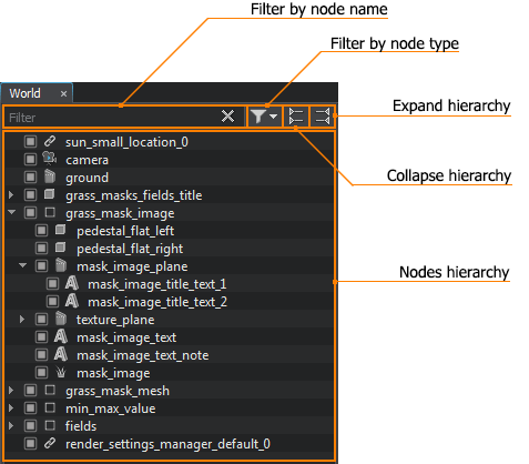

In Unigine, nodes are organized in a hierarchy that can be managed via the World Hierarchy window.
World Hierarchy Window

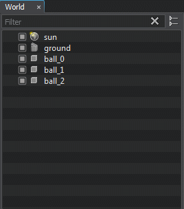

This window contains all nodes existing in the current world. Some nodes can be instances of the asset files: meshes, sounds, terrains, instanced nodes, or nodes stored in the *.node files.
When you add a new node to the scene via the Menu Bar (the Create menu) or by dragging it from the Asset Browser, this node is automatically added to the nodes hierarchy and displayed in the World Hierarchy window.
The World Hierarchy window allows filtering nodes by name and by type, collapsing nodes hierarchy (showing only the parent nodes and hiding the child ones), expanding nodes hierarchy (showing all nodes added to the world), rearranging, reparenting, cloning, renaming, deleting, and grouping the nodes.
To open the World Hierarchy window, choose Windows -> Toggle World Hierarchy in the Menu Bar.

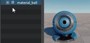

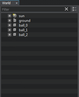

Toggling Nodes#
To toggle a node on and off, left-click the checkbox next to it. If the flag is unchecked, the node will not be rendered.
Toggling a node on and off

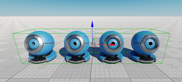

You can also enable and disable a group of selected nodes:
Multi-selection toggling
A node can also be disabled and enabled in the Parameters window.

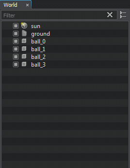

Renaming Nodes#
To rename a node, right-click it, choose Rename in the drop-down list, and type a new name.
Renaming a Node

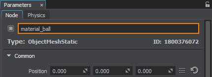

A node can also be renamed in the Parameters window:
Renaming via Parameters Window

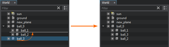

Rearranging Nodes#
To move a node to a specific position in the hierarchy, drag it with the left mouse button pressed.
Moving a Node in Hierarchy
The position in the hierarchy, where the node will be placed, is highlighted with the white line:
Highlighted Position

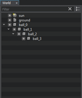

Setting Up Nodes Inheritance#
Nodes in the scene have hierarchical arrangement: each node (parent node) can have multiple children (child nodes). It allows you, for example, to change the transformation of several nodes only by transforming the parent node.
To collapse or expand the list of child nodes, click the arrow to the left of the parent node.
You can also collapse all child nodes in the World Hierarchy window by clicking , or expand the list to see all nodes in the World Hierarchy by clicking .

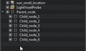

Making a Parent Node#
To make one node a parent for the other node (or several nodes), select both the parent and the desired child nodes, right-click the parent node, and choose Make Parent in the drop-down list:
By using this option, you can perform reparenting for the hierarchy tree branch: select the target branch, right-click the desired parent node and choose Make Parent in the drop-down list. It produces the following:
  1. The new-made parent is always placed at the root level of the hierarchy.
  2. The child nodes positioned at the different hierarchy levels are placed at the same level.
Reparenting Nodes

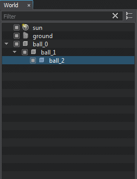

Making a Child Node#
To add one node as a child to the other in the hierarchy, or reparent a node, drag it holding the left mouse button to the desired parent node.
Adding a Child Node
The parent node to which the node will be added, is highlighted with the white frame:
Highlighted Parent Node
You can also move a node to a specific position alongside the child nodes of the desired parent: the node will be added as a child to this parent node.
Moving Node As a Child

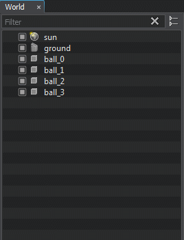

Unparenting a Node#
To detach a node from its parent, right-click it and choose Unparent in the drop-down list:
The node is detached only from its direct parent and placed at the same level as the former parent.
Detaching a Node from Its Parent
To reset inheritance of a child node (i.e., detach it from all parents and place at the root level of the hierarchy), simply drag it to the corresponding position in the hierarchy.

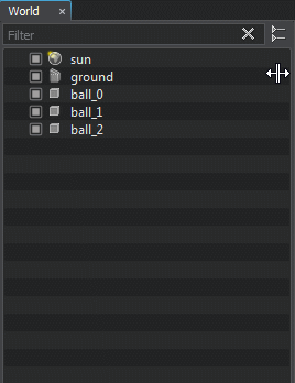

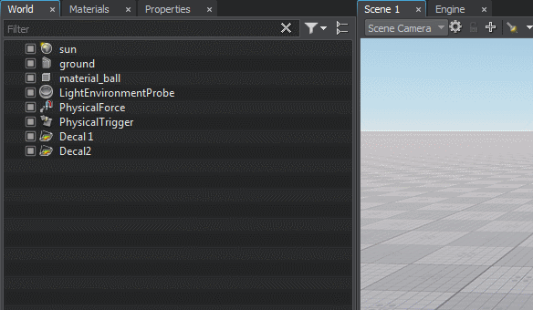

Filtering Nodes#
Filtering nodes simplifies managing nodes in a large world. You can select which node types to display in the World Hierarchy window: click and choose the required node types.
You can temporary show all objects by clicking Enable All. At that, the current filter settings will be preserved.
Filtering Nodes
