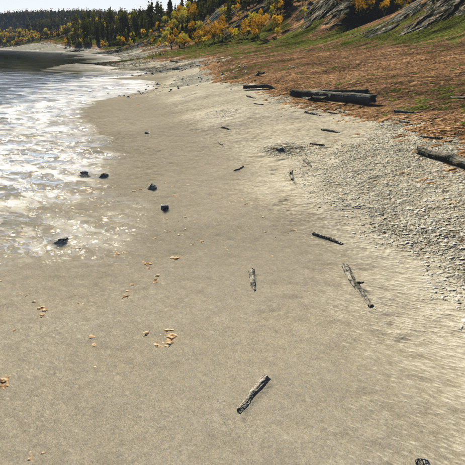

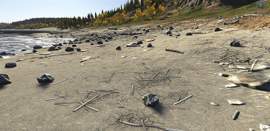

The World Clutter node allows scattering a set of identical nodes (node references) randomly across the scene practically in one click. There is no need any longer to position, scale, and rotate every single object by hand and constantly mind the performance factor. World Clutter automatically places nodes in the scene with random parameters, all of which can be efficiently controlled, and renders them only around the camera. WorldClutter object is used to scatter non-geometry objects, such as decals, particles systems, and so on. But if you want to scatter identical meshes, it is better to use Mesh Clutter.
Unlike World Cluster, World Clutter scatters objects procedurally and therefore even more memory-efficient. At the same time it means that scattered objects cannot be moved.
World Clutter is used only with reference nodes, because when the world is loaded they are scattered around the camera much faster.

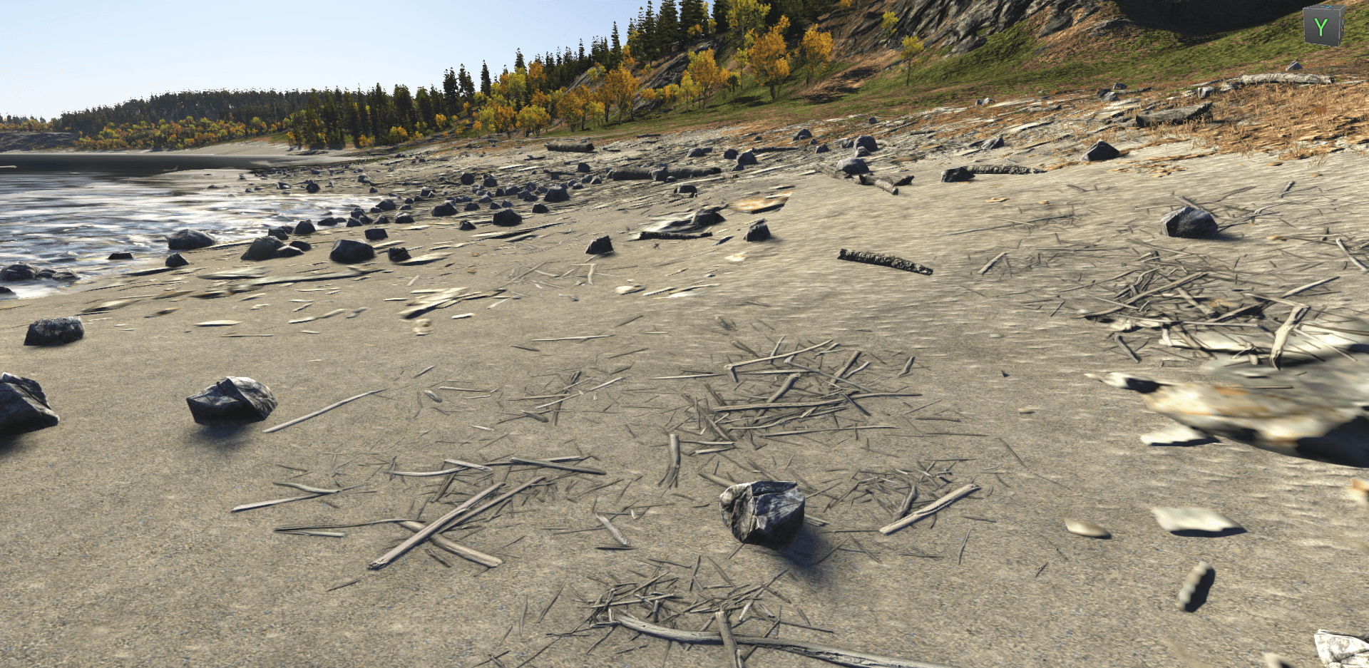

Scattered wood chips in the Port Angeles demo created using World Clutter.

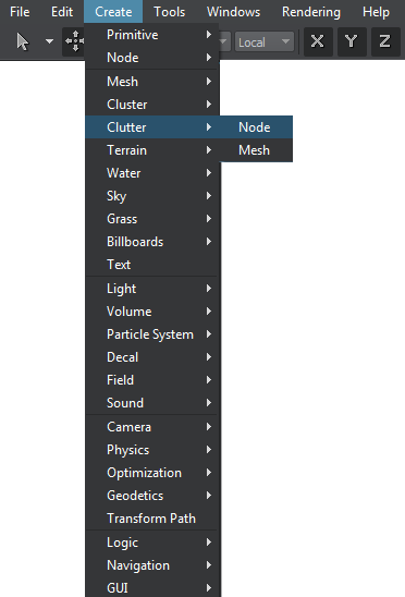

To create the World Clutter object, do the following:
  1. Add a World Clutter node: on the Menu Bar, choose Create -> Clutter -> Node.
  2. Locate the world clutter on the scene.

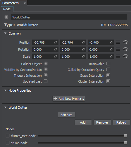

Objects in a Clutter are node references that are scattered throughout a definite area and for each of which the probability of its appearing is controlled.
Node references that are contained in the clutter
List of node references in the World Clutter
Probability slider The higher the probability, the more often a node reference can be seen compared to other Clutter objects. Let's say, we create a coast with wood chips and algae. We create wood chips decal and algae decal and save them as *.node files (create a NodeReference file). If the probability slider for algae is near to zero, the coast is thick with wood chips and only several algae are seen among them. Changing the probability of appearing does not affect the number of rendered objects, it only specifies the proportion between several clutter objects.
  • If the probability is set to zero, the object is not rendered at all.
  • If there is only one object in the Clutter, the probability parameter (except when it equals zero) is ignored and the object occurrence depends solely on the density.
Add Add a reference node to the list of Clutter objects.
Remove Delete all selected node references from the list. To select an object, a box near it should be checked.
Reload Reload all the node references in the Clutter. After a node reference was edited, the saved changes are not automatically applied to the same nodes scattered by the Clutter. It happens because a reference node after being loaded once is copied from the internal cache, which allows creating a lot of copies really fast. Reload option updates this cache and the changes in objects parameters come in effect.

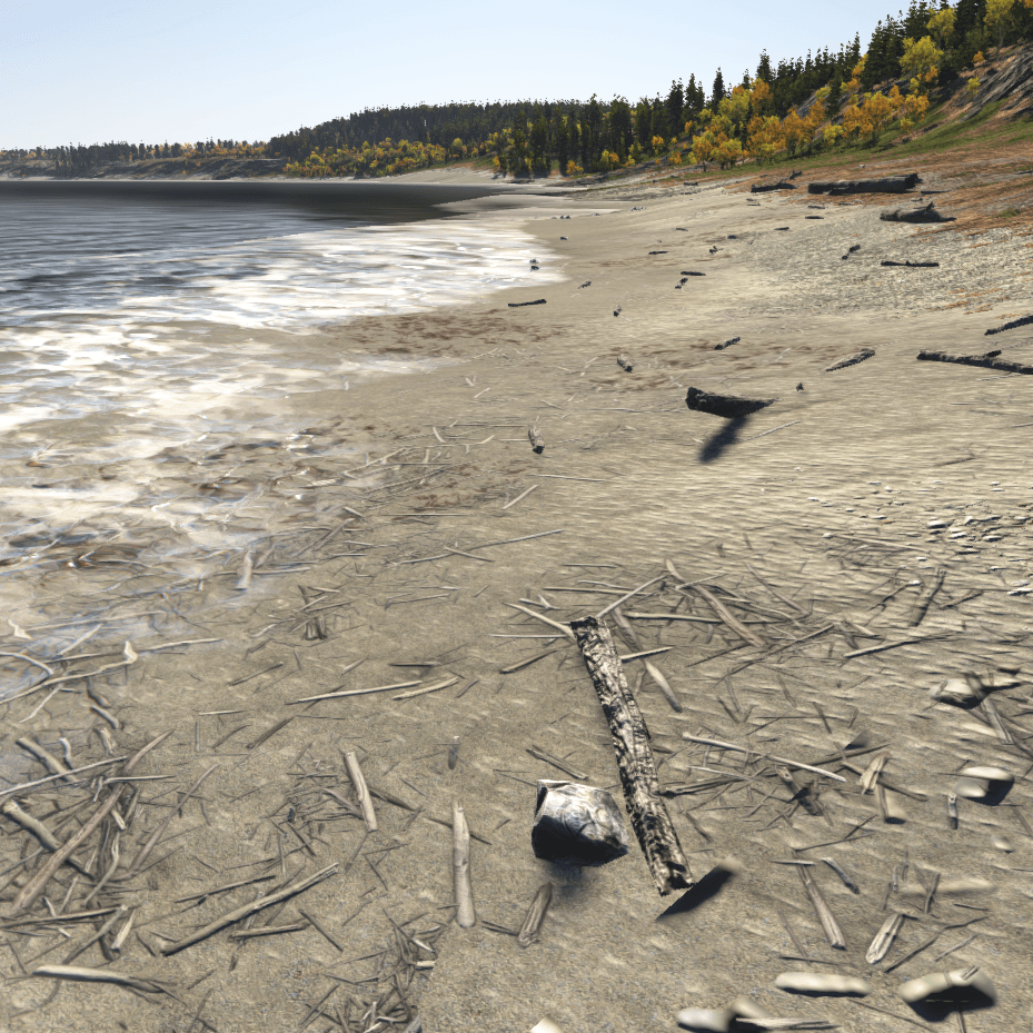

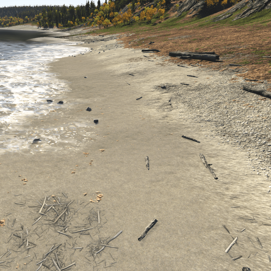

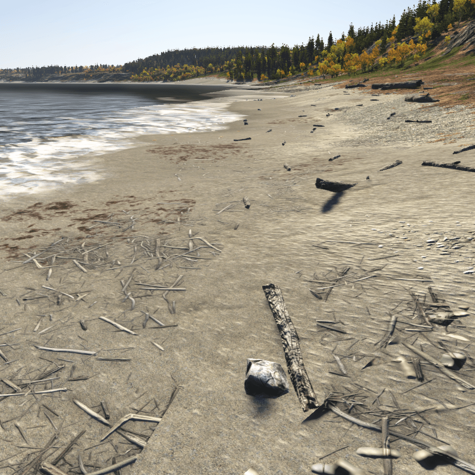

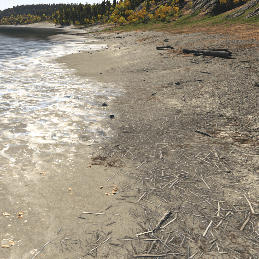

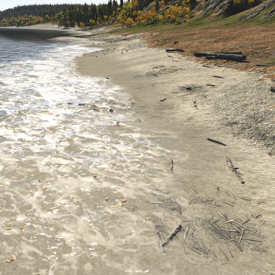

Density Density specifies how many objects there are per square unit. In case there are more than one object in the Clutter, probability will be taken into account, but will not change the resulting number of all rendered objects.
  • If the density value is too high, objects can be penetrating each other.
Lower Density
Lower Density
Higher Density
Higher Density

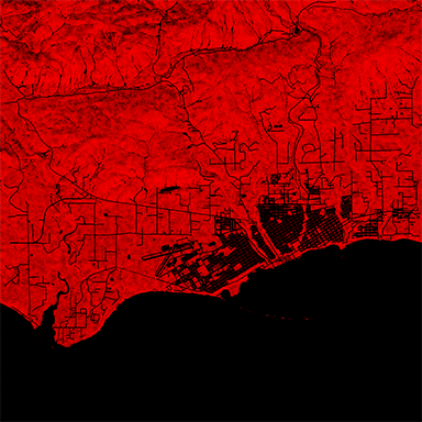

Having objects uniformly scattered in all directions and places is naturally not very convenient. Instead of creating a number of small World Clutter nodes that cover a limited location, a big one can be used with a mask.
Image Mask Areas across which the objects are randomly scattered and areas where there will be no objects from the list. For example, on the terrain a mask allows to scatter rubbish across certain areas, while leaving other places free of it
When the image mask is not set, the default mask with maximum mask values will be used. The maximum mask value is 255.
  • The mask is one-channel texture (R8). If there are more channels in the provided mask, they will be ignored.
    • Zero color value specify the areas without Clutter objects.
    • The higher the color value is, the more objects there are in this area and the denser they are positioned.
    • Color value of 255 means the density is as specified in by the corresponding parameter.
  • Masking is done for all objects that are contained in the Clutter list.

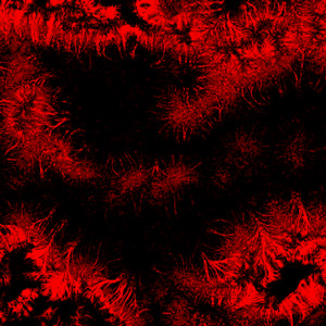

World Clutter mask for scattering
