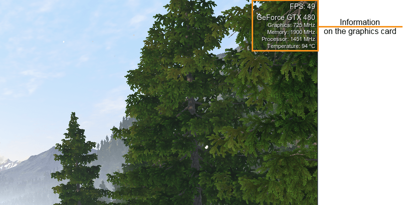

A GPUMonitor plugin allows monitoring the graphics card temperature and per-frame information on the chip frequency (if available).
The information provided by the plugin is displayed in the upper right corner.
GPUMonitor info

GPU Information#
The following information is available for GPU:
Graphics Core clock, i.e. frequency, at which the GPU is running.
Memory Memory clock, i.e. how fast the GPU memory is running.
Processor Shader clock, i.e. how fast the shaders operate.
Temperature GPU temperature.
