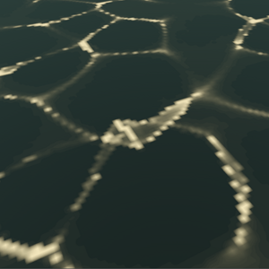

Foam#
Foam state enables foam rendering for shoreline zones.
Foam state disabled.
Foam state enabled.

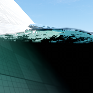

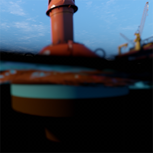

Underwater DOF#
Underwater DOf adds an additional blur effect for underwater and overwater splice to make the waterline looks more plausible.
High quality waterline state disabled.
High quality waterline state enabled.

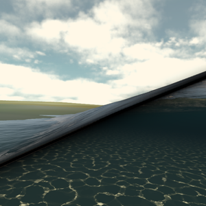

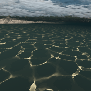

Caustics#
Caustics allows you to render light rays refracted by the water surface.
Caustics state disabled.
Caustics state enabled.
Caustics Distortion#
Caustics Distortion removes pixelation and makes caustics look smoother. When smoothing is not required, you can disable this option to gain performance.
Caustics Distortion state disabled.
Caustics Distortion state enabled.

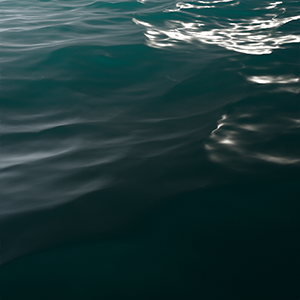

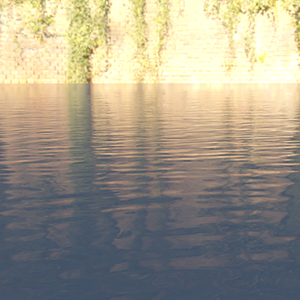

Normal Detail#
Normal Detail map stores normal information required to achieve an additional (detail) effect of Normal Mapping. Normal map helps to create ripples (cats-paw effect) on the water surface.
With absolutely white normal map
With ripple-simulated normal map
The texture is 2-channeled:
  1. RG values store two components of a surface normal.
  2. B value is calculated based on the R and G values in run-time.

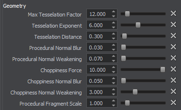

Geometry Parameters#

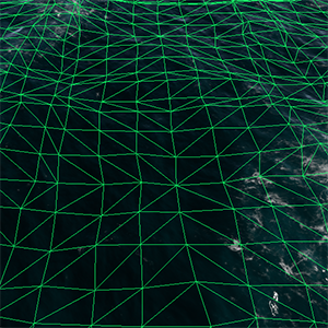

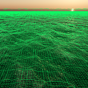

Max Tessellation Factor#
Tessellation factors determine how much to subdivide each patch.
Tessellation factor is set to 1
Tessellation factor is set to 16
Tessellation Exponent#
Tessellation Exponent parameter is in charge of rate of tessellation factor changing. It specifies how fast the tessellation will fades from the center point of inner water to outer.
Tessellation Distance#
The engine doesn't performs the tessellation of whole water surface because it would significantly affect performance. In fact, we have two parts of the water: inner (always under the camera) and outer. This parameter specifies the size of the inner water grid - the part of the water that will be tessellated.
Procedural Normal Blur#
Procedural Normal Blur parameter specifies the ratio of the procedurally generated normals' blurring. The lower the value, the more blurred (hence, more flatten) the water surface will be.
Procedural Normal Weakening#
Procedural Normal Weakening parameter specifies the ratio of procedurally generated normal weakening.
Choppiness Force#
Choppiness Force parameter specifies the sharpness of the wave crests. If the Choppy Waves is enabled, the engine takes the vertices near the wave crest and move them closer to the crest and recalculate their normals to make them look more plausible. This parameter specifies the force of that contraction.
Choppiness Normal Blur#
Choppiness Normal Blur parameter specifies how moved vertices' normals will be blurred.
Choppiness Normal Weakening#
Choppiness Normal Weakening parameter sets the weakening of the normals for choppiness.

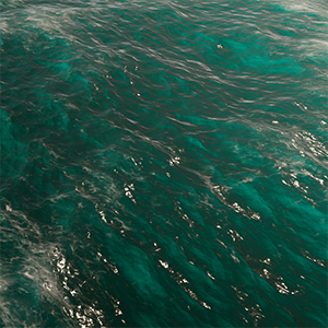

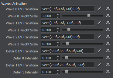

Waves Animation Parameters#
Waves for water_global_base material are created by using the height map. The engine performs sampling from this height map and creates the waves by using simple formula:
Formula
A*H1 + B*H2 + C*H3
In the formula given above, H1, H2, H3 are samplings from height map, A, B, C are Height Scale parameters.
Additional ripples (cats-paw effect) are created by using normal detail map.
Wave 0 UV Transform#
This parameter specifies the transformation of the first height map sampling.
First two parameters mean the scale texture coordinates, along the X and Y axes. Third and forth specify the wind direction.
Wave 0 Height Scale#
This parameters sets the height scale of the first height map sampling.
Wave 1 UV Transform#
This parameter specifies the transformation of the second height map sampling.
Wave 1 Height Scale#
This parameters sets the height scale of the second height map sampling.
Wave 2 UV Transform#
This parameter specifies the transformation of the third height map sampling.
Wave 2 Height Scale#
This parameters sets the height scale of the third height map sampling.

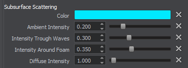

Subsurface Scattering Parameters#
Color#
This parameter specifies the Subsurface Scattering (SSS) color.
Ambient Intensity#
Ambient Intensity parameter sets the intensity of the light ray for whole water. It used to simulate SSS for whole water. The lower the value, the faster the ray will dissipate in water.
Intensity Through Waves#
Intensity Through Waves parameter sets the intensity of the light ray that goes through the waves. The lower the value, the faster the ray will dissipate in water.
Intensity Around Foam#
Intensity Around Foam parameter sets the intensity of the SSS near the foam.
Exponent Around Foam#
Exponent Around Foam parameter specifies the rate of intensity around foam parameter changing.

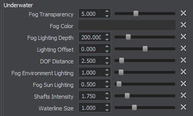

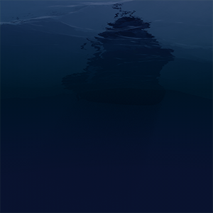

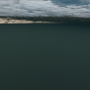

Underwater Parameters#
Underwater parameters specifies the underwater part of the water_global_base material.
The final color of the underwater is calculated by this formula:
Final Color Formula
FinalColor = FogColor * SunLighting^(1/FogSunLighting) + FogColor * EnvLighting^(1/FogEnvLighting)
FogColor, FogSunLighting, FogEnvLighting are parameters that you can specify in the material. Other parameters (Sun and Environment lighting) are calculated according to the sun lighting and environment lighting of the scene. In fact, this formula define how sun lighting and environment lighting affect the final underwater color.
Fog Transparency#
Fog Transparency parameter specifies the transparency of the underwater fog. The higher the value, the more transparent the underwater fog will be.
Fog Color#
Fog Color parameter defines the fog color. Sun and Environment lightings will affect this parameters to create the final underwater fog color.
Fog Lighting Depth#
Fog Lighting Depth parameter sets the distance in units, where the light will affect the underwater color. If the camera moves down deeper than the given value there will be no light.
Fog Environment Lighting#
Fog Environment Lighting parameter specifies how the environment lighting will affect the final underwater color.
Fog Sun Lighting#
Fog Sun Lighting parameter specifies how the sun lighting will affect the final underwater color.
Bottom Color LUT Scale#
Bottom Color LUT Scale parameter is a multiplier for the Depth LUT. It will "stretch" the LUT texture length.
Bottom Color LUT Offset#
Bottom Color LUT Offset parameter sets the offset of the Depth LUT texture.

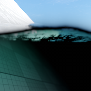

Waterline Size#
Waterline Size parameter specifies the thickness of the line that divides overwater and underwater.

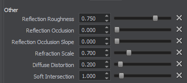

Other Parameters#
Reflection Roughness#
Reflection Roughness parameter specifies the environment reflection roughness of the water surface. It helps to tweak the water surface appearance related to the environment.
Reflection Occlusion#
Reflection Occlusion parameter specifies an occlusion factor for environment reflections on the water surfaces with negative normals. Using this parameter enables simulation of reflection of waves on the water surface removing too bright areas on waves close to the horizon.
  • By the minimum value of 0, no occlusion is performed for reflections of waves, no matter what normals the water surfaces have.
  • By the higher values, occlusion is performed for reflections on the water surfaces with negative normals that have a certain slope. The higher the value, the less intensive reflections on the surfaces with negative normals.
Reflection Occlusion Slope#
Reflection Occlusion Slope parameter specifies a slope of negative normals of water surfaces, at which occlusion is performed for reflections of waves.
Refraction Scale#
Refraction Scale parameter sets the scale of the water refraction. The light moves slower in water and faster in air, that's why we see the refraction of object in the water. This parameter specifies the scale of the water refraction.
