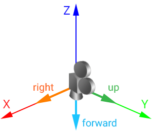

Getting Euler Angles for an Active Camera
Sometimes it might be necessary to get current rotation of the active camera as a set of Euler angles. When we talk about axes in UNIGINE we assume that:
  • X axis points to the right giving us a pitch angle.
  • Y axis points forward giving us a roll angle.
  • Z axis points up giving us a yaw (heading) angle.

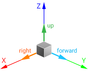

Object Direction Vectors
To get the Euler angles we should use decomposeRotationZXY() also known as Cardan angles (yaw is independent, then we get pitch and in the end, roll). But, there is one thing to be taken into account - cameras have a different system:
  • Y axis points up giving us a yaw (heading) angle.
  • Z axis points backward giving us a -roll angle.
Camera Direction Vectors
To compensate it, we need to rotate our camera -90 degrees around X axis.
// getting the current view matrix of the current camera
Mat4 currentModelview = Game::get()->getPlayer()->getCamera()->getIModelview();
// decomposing rotation matrix of the camera (with compensation)
vec3 euler = decomposeRotationZXY(mat3(currentModelview * rotateX(-90.0f)));
euler.x += 90.0f;
// perform correction for negative angle values
if (euler.x < 0) euler.x += 360.0f;
if (euler.y < 0) euler.y += 360.0f;
if (euler.z < 0) euler.z += 360.0f;
// Euler angles for the camera
float pitch = euler.x;
float roll = euler.y;
float yaw = euler.z;
