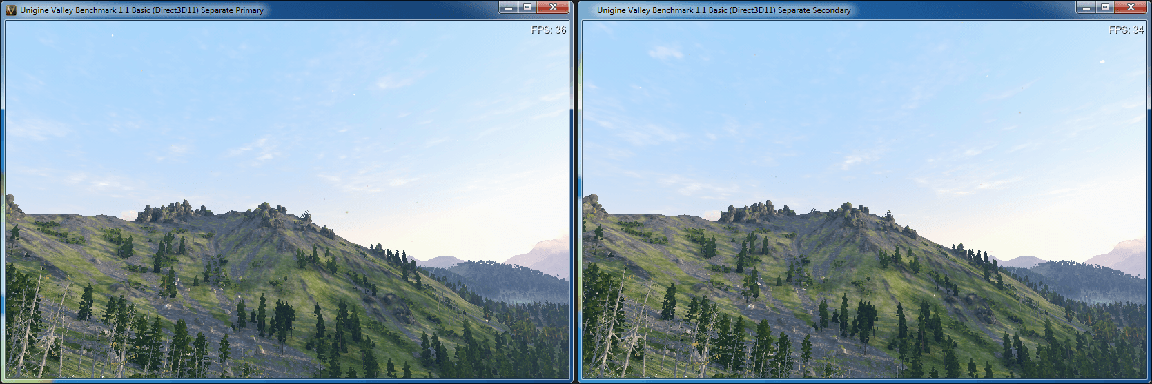

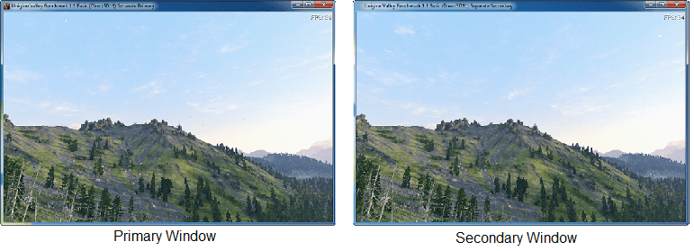

An AppSeparate plugin is used to create a separate window for each eye. It can be used with any devices that support separate images output, e.g. for 3D video glasses or helmets (HMD)

AppSeparate can be rendered in both the windowed and the full screen mode.
