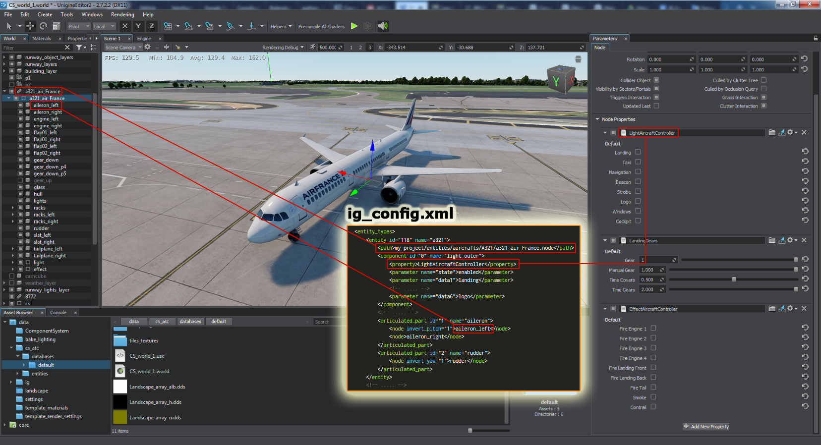

An IG has a number of models, that are used to represent certain entities in the virtual environment. Entity definition section is enclosed in the <entity_types/> tag. To define each entity the <entity/> tag is used. Each entity includes the following:
  • a *.node file containing the hierarchy of nodes representing the entity in the virtual world. A path to this file is specified in the <path/> tag.
  • a set of components (flashing lights, aircraft propellers, afterburners, landing gear, tank tracks, wheels, and like items). Definition of each component is enclosed in the <component/> tag.
    Component data in packets, received by IG from connectors, is usually represented as a set of a discrete state and up to six values (data1, data2 ... data6). IG component definitions in this section are actually used to map parameters from connectors to corresponding properties (e.g. data1 field of the outer_light component in the example below corresponds to landing light type).
  • a set of articulated parts (ailerons, flaps, etc.). Definition of each articulated part is enclosed in the <articulated_part/> tag.
Click to enlarge Below is an example of entity definition section:

Components#
Each entity may have an arbitrary number of components assigned, including custom ones. To define a component of an entity use the <component/> tag:
Source code (XML)
	<entity id="118" name="a321">
		<path>my_project/entities/aircrafts/A321/a321_air_France.node</path>
		<component id="22" name="rotorwash">
			<property>rotorwash</property>
			<parameter name="data1">wind_percent</parameter>
			<parameter name="data2">sand_percent</parameter>
		</component>
	</entity>
Components are added to entities by means of assigning corresponding properties to nodes. By default it is assumed that all properties corresponding to components are assigned to the root node. In fact, a component's property can be assigned to any node in entity's hierarchy. For such a component you should add the <node/> tag to specify a path to this node (the path is specified relative to the root node):

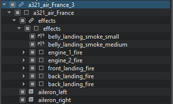

You can also specify a path to a node inside a NodeReference as follows:
  • <node>path_to_node_reference/^/path_inside_nodereference</node>
Example:
Suppose for a hierarchy shown below we have the comp1 component's property assigned to the aileron_left node, and comp2 component's property assigned to the engine_1_fire node. Definition of components will look like:
Source code (XML)
	<path>my_project/a321_air_France.node</path>
	<component id="1" name="comp1">
		<property>comp1</property>
		<node>aileron_left</node>
		<parameter name="param1">param_1</parameter>
	</component>
	<component id="2" name="comp2">
		<node>effects/^/engine_1_fire</node>
	</component>
</entity>
