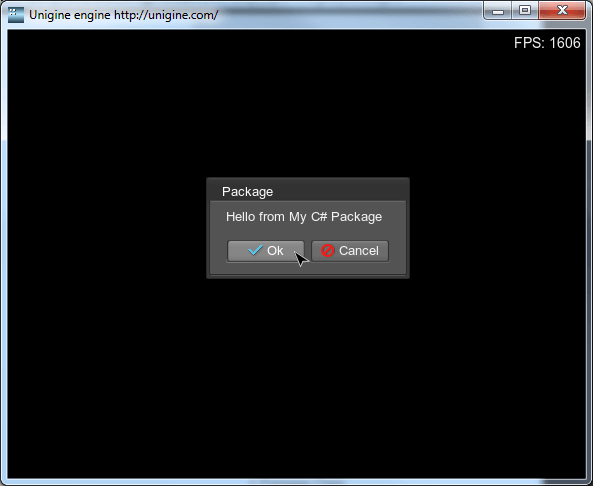

Unigine Script Side#
In the UnigineScript package.cpp file:
Source code (UnigineScript)
int init() {
	log.message("\n");
	log.message("Hello from My C# Package\n");
	engine.dialogMessage("Package");
Output#
The following result will be shown:
In the console:
Output
MyPackage.selectFile("data/package.cpp",): called
MyPackage.readFile(,866): called
Loading "data/package.cpp" 4ms
MyPackage.selectFile("data/package.world",): called
MyPackage.readFile(,62): called
Loading "data/package.world" 0ms
