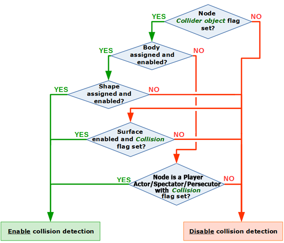

In order for an object to participate in collision detection, it must be added to a specific BSP-tree representing the physics scene. The algorithm of enabling/disabling collision detection is illustrated below.
Algorithm of enabling/disabling collision detection
Algorithm of enabling/disabling collision detection.
  • Disabling physics simulation globally does not turn off Collision detection.
  • In case if an object has a body and a shape assigned and enabled, the collision detection algorithms will use only shape's parameters, while the parameters of its surfaces will be ignored.

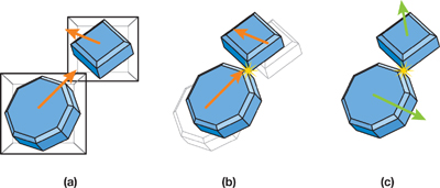

Process Pipeline#
The whole process is divided into the following stages and phases:
  1. Collision detection
    • Broad phase detection is a computationally low cost operation that quickly answers the question: Which objects have a strong possibility of colliding?
    • Narrow phase is a computationally intense mesh on mesh collision detection, and thus cannot be performed on every pair of objects each frame. It answers the question: What part of object A collided with object B?
  2. Collision response
    It is the result of collision (e.g. two balls bounce off of each other). Without the response there would be no difference between collision and intersection of two objects. Friction, restitution and other parameters are taken into account in calculation of collision response.
Collision detection phases
Collision detection phases: (a) - broad phase, (b) - narrow phase, (c) - collision response

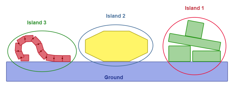

In a constrained physics simulation some objects influence the motion of others, while others don’t. Thus, these objects can be grouped into islands, which are self-contained groups of bodies that can influence the motion of each other in the group through constraint forces/impulses, but do not affect objects belonging to other islands. So, if bodies intersect with their bounding volumes, or there are joints connecting them, such bodies are combined in a island.
Islands
Objects grouped into islands

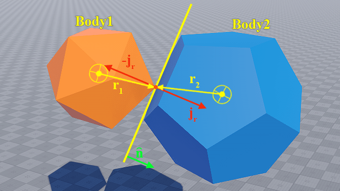

Collision Response#
The narrow phase extracts all necessary information about collisions, now something has to be done with this information to provide realistic reaction. Collision response stands for simulation of the changes in the motion of two solid bodies after collision. On collision, the kinetic properties of two bodies change instantaneously. Typically the bodies rebound away from each other, slide, or settle into a static contact, depending on their elasticity and the configuration of the collision. Unigine uses an impulse-based reaction model. During the collision, the first body applies a collision impulse to the second one at a contact point equal in magnitude but opposite in direction to the impulse applied by the second body, as per the Newtonian principle of action and reaction.
Collision response
Collision response
At this stage all found contacts are cached together with contacts from the previous frame — to ensure proper interaction. On the basis of gathered contact points data, Unigine computes the impulse a shape gets by collision. Contact points are solved in a pseudo-random order to achieve simulation stability and reproducibility.
Joints are solved in the process of contact response calculation. The impulses that joints give the bodies attached to them are computed: how according to the current state of the joint, the bodies should respond to keep the joint unbroken (i.e. based on their masses, linear and angular velocities, change their movement direction and orientation), and how that response affects the joint (a joint can be broken by a too large impulse). Joints are also solved in the pseudo-random order.
Within one physics iteration, joints can be solved several times. High number of joint iterations increases the precision of calculations, as well as computational load.
The results of contact and joint solving are accumulated and applied to bodies. The coordinates of the bodies change according to their new linear and angular velocities.

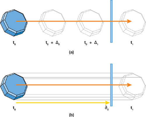

Discrete and Continuous Collision Detection#
Regarding the way the time scale is considered, two basic approaches to finding contact points in case of collision are used. Both of these approaches are implemented in Unigine.
  • Discrete collision detection is performed in certain intervals of time and each frame is treated separately from others. In general, discretization improves performance. However, when a project framerate is already low, a small fast-moving object is likely to teleport from one point to another instead of moving there smoothly and collision will not be detected.
  • Continuous collision detection does not suffer this problem as the moving body is extruded along its trajectory (between two adjacent frames). In cases when something gets into this volume and a collision is detected, the body is taken back in time to correct the collision reaction.
    Continuous collision detection is available for sphere and capsule shapes only.
Discrete and continuous collision detection
Discrete (a) and continuous (b) collision detection
The primary advantage of discrete detection is that it tends to be much faster and simpler for objects with complex shape or large size. Continuous collision detection requires mathematical descriptions of all objects and their motions and the solving systems of equations, which can be difficult, slow, or even impossible in many circumstances.

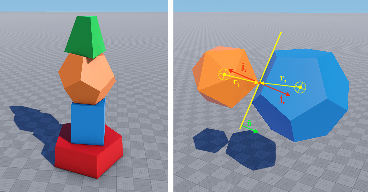

Static and Dynamic Contacts#
Basically there are two types of contacts:
  • Static, when the body rests on another body. In this case, bodies are considered "frozen" until an external force affects them. This makes it possible to avoid unnecessary calculations.
  • Dynamic, when two bodies, at least one of which is moving, collide. In this case, we have to calculate instantaneous change of velocities for both colliding objects.
Static and dynamic contacts
Static (left) and dynamic (right) contacts
