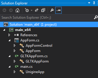

Description of C# classes#
This sample contains 4 classes:
  • AppForm - inherits the Unigine.App class. In this class thedoUpdate(), doRender() anddoSwap() functions are overridden and call the update(), render() andswap() functions respectively.
  • AppFormControl - inherits the System.Windows.Forms.Form class. This class implements all the necessary events, which will be performed when user interacts with the application.
  • GLTKAppForm - inherits the AppForm class and initializes the graphics OpenGL API in the Windows Forms Application via the OpenTK library.
  • UnigineApp - defines the entry point of the program. C# Wrapper and Engine are initialized here.
AppForm, AppFormControl, GLTKAppForm are defined in the Unigine namespace.
