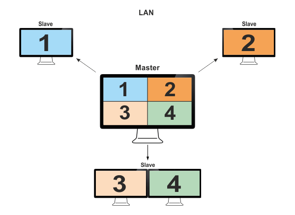

Syncker
Computers in LAN connected via Syncker

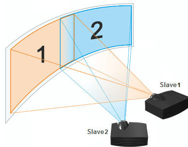

  • A multi-projector setup formed also by displays, where each slave renders its viewport via the corresponding projector as if a surface which the viewport was projected onto was a display.
    A multi-projector setup. The screens are considered as displays.

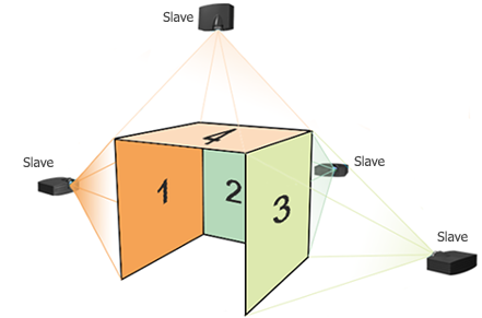

    A special case of the multi-projection setup is a CAVE (Cave Automatic Virtual Environment):
    Projection Configuration for CAVE

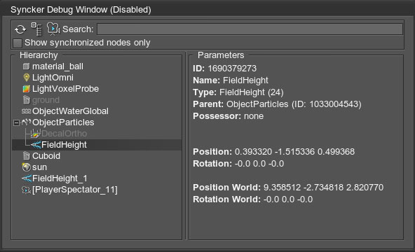

Debug Window#
Syncker's debug window enables you to monitor the hierarchy of objects at run time. The whole hierarchy means all objects (not only the ones registered in the Editor) including objects in cache, internal structure of node references, etc. When a node is selected, all necessary debug information is displayed. This information is updated each frame.
Search option allows you to find any node by its name or ID (on the Master or on a Slave), so a faulty node can be found quickly.
To show the debug window, run the syncker_debug console command from the master or a slave as follows:

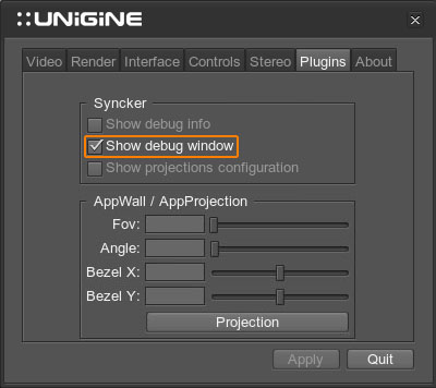

The debug window can also be opened via the System Menu:
  1. Open the System Menu by pressing Esc.
  2. Go to the Plugins tab and enable the Show debug window option in the Syncker group:
The debug window will open:
Debug Window
