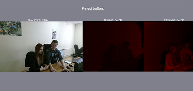

kinect_00 Sample That Shows Kinect Buffers: Color, Depth and IR Range

    • data/samples/plugins/kinect_00 that shows all 3 buffers (color, depth, IR range).
