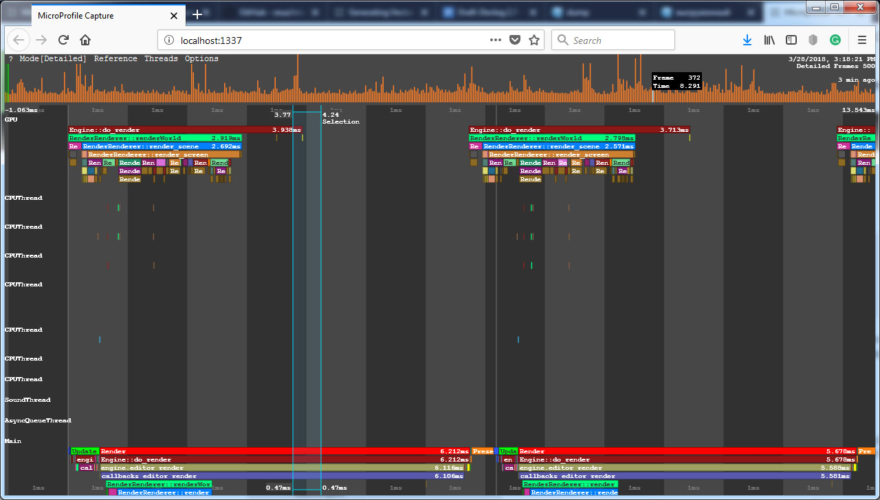

Running Microprofile#
The Microprofile is available only for the development builds of UNIGINE Engine: it won't be compiled for the debug and release ones. You can use the microprofile_info console command to check if the Microprofile is compiled.
The performance data obtained by the Microprofile can be output to a local web server or to an HTML/CSV file.
The Microprofiler shows valid information only after the first 1000 frames are rendered (e.g. at the framerate of 60 FPS, such “warmup” time comprises about 16 seconds).
Visualization Using Built-In Server#
To visualize the performance data using the local web server, perform the following:
  1. In the console, set the the number of frames to be profiled via the microprofile_webserver_frames console command. You can skip this step: by default, 500 frames will be profiled.
  2. If required, disable GPU profiling.
  3. On the Menu Bar of UnigineEditor, choose Tools -> Microprofile.
The performance data will be displayed in your Web browser.
You can display only a part of the profiled frames: in the Web browser address bar, add /<number_of_frames> to the current URL.
For example, if you specify localhost:1337/100, only the first 100 frames will be displayed.

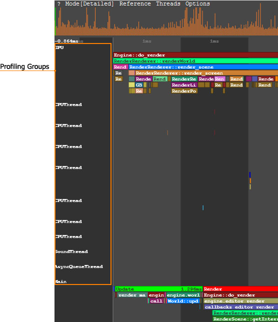

The Microprofile visualizes the detailed per frame performance data on the operations performed by the engine on CPU and GPU (if enabled) and on the engine threads. In the Microprofile main menu, you can change the visialization mode: click Mode and choose the required one. By default, the Detailed mode is set.
Profiling Groups Displayed in Detailed Mode
In the Detailed mode, each operation (function) and thread is displayed as a separate colored region. The regions are hierarchical: the function called by the other function is displayed under the last one. The size of the region is determined by the time the corresponding operation takes.
In the picture below, the Engine::do_render() function calls the RenderRenderer::renderWorld() functions and so on:
To view the data on a certain operation or a thread, point to the corresponding region. To zoom in/out the displayed regions, scroll the mouse wheel.

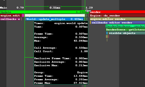

In the Main group of the performance data, the call stack of the operations (e.g., update, rendering, etc.) performed by the engine on CPU is displayed.
Performance Data on World Update Function

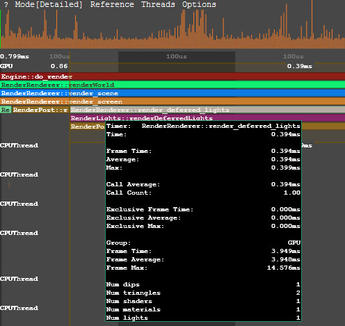

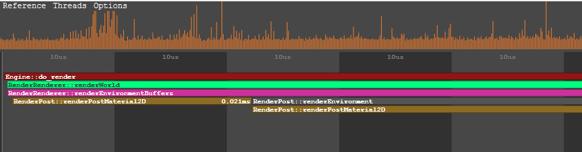

GPU Data#
In the GPU group of the performance data, the call stack of the operations performed by the engine on GPU is displayed. In addition to the main performance data, for each function (e.g. environment rendering, post materials rendering and so on), the number of DIP calls and rendered triangles is shown. Also there can be the number of surfaces, lights, shadows rendered by this function, the number of materials and shaders used; the information on the node or material for which the function is called (identifier, name, etc.).
Performance Data on Deferred Lighting Rendering
When the region that corresponds to the certain function is pointed, the Microprofile displays when this function is called on CPU and how much time is spent on its performing.

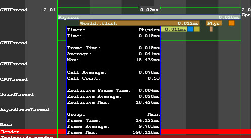

Engine Threads Data#
The performance data on the engine threads is visualized in the CPUThread, SoundThread, AsyncQueueThread, WorldSpawnMeshClutterThread, WorldSpawnGrassThread groups.
Performance Data on Physics Thread
