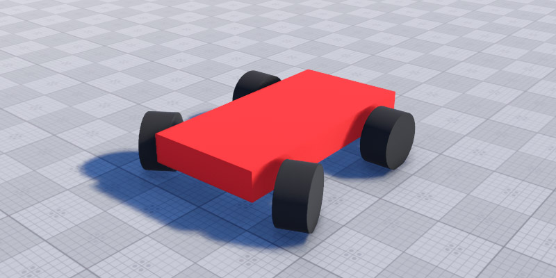

The basic workflow of creating a simple car with keyboard control is as follows:
  1. Create car geometry: frame and wheels.
  2. Assign rigid bodies and collision shapes to the frame and all the wheels.
  3. Set up masses for the wheels and the frame.
    Do not use real masses (e.g. 2000 kg for the frame and 10 kg for the wheels), as joints may become unstable! It might be better to use 64 kg for the body and 25 kg for each wheel to provide realistic behavior.
  4. Connect the wheels to the frame using suspension joints. Set up joint parameters.
  5. Enable car movement using joint motors and assign movement control to corresponding keyboard keys.

The first thing we are going to address in this tutorial is the geometry of our car. We are going to create a rectangular car frame and four wheels. We are also going to add some physical parameters to the geometry. So, we need two functions:
  • The first one to create a box with specified parameters representing the car frame:

Now, using these functions we can create our car. We are going to use DynamicMesh objects for the frame and four wheels. For a proper mass balance let us set frame mass equal to 64 kg and the mass of each wheel - to 25 kg.
// defining DynamicMesh objects for the frame and four wheels
ObjectMeshDynamicPtr car_frame;
ObjectMeshDynamicPtr wheels[4];
// creating car frame
car_frame = createBodyBox("car_frame", vec3(frame_length, frame_width, frame_height), 64.0f, vec4(1.0f, 0.1f, 0.1f, 1.0f), transform);
// creating car wheels
// front left wheel
wheels[0] = createBodyCylinder("car_wheel_f_l", wheel_radius, wheel_width, 25.0f, vec4(0.1f, 0.1f, 0.1f, 1.0f), transform * Mat4(translate(-frame_length / 2 + wheel_radius, -(frame_width + wheel_width) / 2 - delta, -frame_height / 2) * rotateX(90.0f)));
// front right wheel
wheels[1] = createBodyCylinder("car_wheel_f_r", wheel_radius, wheel_width, 25.0f, vec4(0.1f, 0.1f, 0.1f, 1.0f), transform * Mat4(translate(-frame_length / 2 + wheel_radius, (frame_width + wheel_width) / 2 + delta, -frame_height / 2) * rotateX(90.0f)));
// rear left wheel
wheels[2] = createBodyCylinder("car_wheel_r_l", wheel_radius, wheel_width, 25.0f, vec4(0.1f, 0.1f, 0.1f, 1.0f), transform * Mat4(translate(0.25f * frame_length, -(frame_width + wheel_width) / 2 - delta, -frame_height / 2) * rotateX(90.0f)));
// rear left wheel
wheels[3] = createBodyCylinder("car_wheel_r_r", wheel_radius, wheel_width, 25.0f, vec4(0.1f, 0.1f, 0.1f, 1.0f), transform * Mat4(translate(0.25f * frame_length, (frame_width + wheel_width) / 2 + delta, -frame_height / 2) * rotateX(90.0f)));
	// initialization of suspension joints
	for (int i = 0; i < 4; i++)
		suspension[i] = JointSuspension::create(car_frame->getBody(), wheels[i]->getBody(), Vec3(wheels[i]->getTransform() * Vec3(0.0f)), vec3(0.0f, 0.0f, 1.0f), vec3(0.0f, 1.0f, 0.0f));
		// setting restitution parameters
		suspension[i]->setLinearRestitution(0.1f);
		suspension[i]->setAngularRestitution(0.1f);
		// setting linear damping and spring rigidity
		suspension[i]->setLinearDamping(2.0f);
		suspension[i]->setLinearSpring(40.0f);
		// setting lower and upper suspension ride limits [-1.0; 0.0]
		suspension[i]->setLinearLimitFrom(-1.0f);
		suspension[i]->setLinearLimitTo(0.0f);
		// setting number of iterations
		suspension[i]->setNumIterations(8);
	// setting up player and controls
	PlayerPersecutorPtr player = PlayerPersecutor::create();
	player->release();
	player->setFixed(1);
	player->setTarget(car_frame->getNode());
	player->setMinDistance(6.0f);
	player->setMaxDistance(11.0f);
	player->setPosition(Vec3(10.0f, 0.0f, 6.0f));
	player->setControlled(0);
	Game::get()->setPlayer(player->getPlayer());
	Game::get()->setEnabled(1);
	controls = player->getControls();
/// method updating current car state with a keyboard control handler
int Car::update()
	float ifps = Game::get()->getIFps();
	// forward and backward movement by setting joint motor's velocity and torque
	if (controls->getState(Controls::STATE_FORWARD) || controls->getState(Controls::STATE_TURN_UP))
		velocity = max(velocity, 0.0f);
		velocity += ifps * 50.0f;
		torque = 5.0f;
	else if (controls->getState(Controls::STATE_BACKWARD) || controls->getState(Controls::STATE_TURN_DOWN))
		velocity = min(velocity, 0.0f);
		velocity -= ifps * 50.0f;
		torque = 5.0f;
	else
		velocity *= Math::exp(-ifps);
	velocity = clamp(velocity, -90.0f, 90.0f);
	// steering left and right by changing Axis01 for front wheel joints
	if (controls->getState(Controls::STATE_MOVE_LEFT) || controls->getState(Controls::STATE_TURN_LEFT))
		angle += ifps * 100.0f;
	else if (controls->getState(Controls::STATE_MOVE_RIGHT) || controls->getState(Controls::STATE_TURN_RIGHT))
		angle -= ifps * 100.0f;
	else
		if (Math::abs(angle) < 0.25f) angle = 0.0f;
		else angle -= sign(angle) * ifps * 45.0f;
	angle = clamp(angle, -30.0f, 30.0f);
	// calculating steering angles for front joints (angle_0 and angle_1)
	float base = 3.3f;
	float width = 3.0f;
	float angle_0 = angle;
	float angle_1 = angle;
	if (Math::abs(angle) > UNIGINE_EPSILON)
		float radius = base / Math::tan(angle * UNIGINE_DEG2RAD);
		angle_0 = Math::atan(base / (radius + width / 2.0f)) * UNIGINE_RAD2DEG;
		angle_1 = Math::atan(base / (radius - width / 2.0f)) * UNIGINE_RAD2DEG;
	suspension[0]->setAxis10(rotateZ(angle_0) * vec3(0.0f, 1.0f, 0.0f));
	suspension[1]->setAxis10(rotateZ(angle_1) * vec3(0.0f, 1.0f, 0.0f));
	// enabling or disabling a brake
	if (controls->getState(Controls::STATE_USE))
		suspension[0]->setAngularDamping(20000.0f);
		suspension[1]->setAngularDamping(20000.0f);
		suspension[2]->setAngularDamping(20000.0f);
		suspension[3]->setAngularDamping(20000.0f);
		velocity = 0.0f;
	else
		suspension[0]->setAngularDamping(0.0f);
		suspension[1]->setAngularDamping(0.0f);
		suspension[2]->setAngularDamping(0.0f);
		suspension[3]->setAngularDamping(0.0f);
/// method updating car physics
int Car::flush()
	// set angular velocity for rear joints
	suspension[2]->setAngularVelocity(velocity);
	suspension[3]->setAngularVelocity(velocity);
	// set torque for rear joints
	suspension[2]->setAngularTorque(torque);
	suspension[3]->setAngularTorque(torque);
In the AppWorldLogic.h file, define our car.
// AppWorldLogic.h
#include "car.h"
	Car car;
Insert the following code into the AppWorldLogic.cpp file.
// AppWorldLogic.cpp
int AppWorldLogic::init() {
	// setting up physics parameters
	Physics::get()->setGravity(vec3(0.0f, 0.0f, -9.8f * 2.0f));
	Physics::get()->setFrozenLinearVelocity(0.1f);
	Physics::get()->setFrozenAngularVelocity(0.1f);
	// initializing our car
	car.init(4.0f, 2.0f, 0.5f, 0.5f, 0.5f, translate(Vec3(0.0f, 0.0f, 1.0f)));
int AppWorldLogic::update() {
	//updating our car
	car.update();
int AppWorldLogic::flush() {
	// updating car physics
	car.flush();
