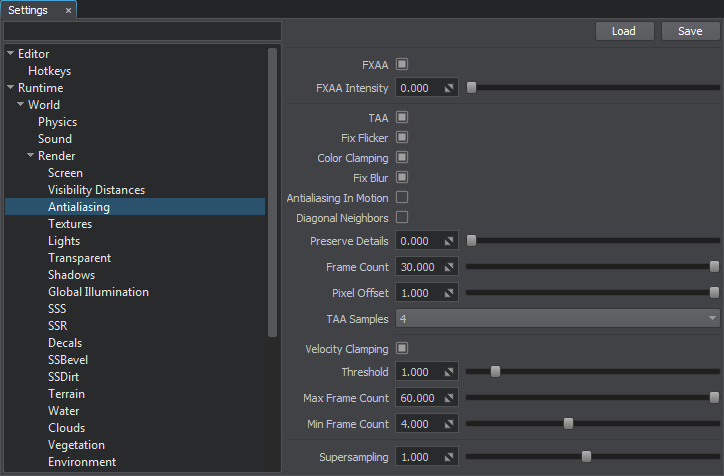

Anti-Aliasing
This section contains settings of anti-aliasing: both the Temporal Anti-Aliasing (TAA) and Fast approXimate Anti-Aliasing (FXAA) can be configured here along with supersampling ratio.
TAA Settings
Anti-Aliasing Settings
FXAA Settings#
FXAA Toggles FXAA (post-process anti-aliasing) on and off.
Can be controlled by render_fxaa console command.
FXAA Intensity Intensity of the FXAA. It specifies the sample offset of the FXAA fragment. The higher the value, the more blurred the image is.
Can be controlled by render_fxaa_intensity console command.
TAA Settings#
TAA Toggles TAA on and off.
Fix Flicker Removes bright pixels by using the pixel brightness information from the previous frame. We recommend to enable this option for bright thin ropes, wires, and lines. However, when enabled, may produce artifacts by removing small bright objects.
Can be controlled by render_taa_fix_flicker console command.
Color Clamping Clamps the pixel color in the current frame with its color in the previous frame. If the pixel color in the current frame differs from the pixel color of the previous frame a lot, these frames aren't combined and blended during TAA. The image becomes more sharp but it can produce additional flickering, thin objects may be blurred (e.g. grass, metal structures, wires, etc.).
Can be controlled by render_taa_color_clamping console command.
Fix Blur Toggles Catmull-Rom resampling on and off. The option allows you to reduce image blurring when the camera moves forward/backward. It is recommended to disable resampling at low settings.
Can be controlled by render_taa_catmull_resampling console command.
Antialiasing In Motion Toggles improved anti-aliasing in motion (for moving camera and objects) on and off.
Can be controlled by render_taa_antialiasing_in_motion console command.
Diagonal Neighbors Toggles on and off considering diagonally neighboring pixels in the process of color clamping.
Preserve Details Controls the TAA detail level: the higher the value, the more detailed the image is. At the value of 0, the image becomes blurred when moving the camera, however, the TAA effect is better. At high values, this option may produce additional flickering. Thus, to improve the anti-aliasing effect, you can decrease the value; to minimize blurring — increase it.
Can be controlled by render_taa_preserve_details console command.
Frame Count Specifies the number of frames that are combined and blended during TAA calculation. The higher the value, the more frames are combined into the final image and the better anti-aliasing is.
Can be controlled by render_taa_frame_count console command.
Pixel Offset Specifies the size of the sample offset performed during sub pixel jittering. This parameter allows specifying the offset that is less than a pixel: for example, if you specify 0.5, frames will shift to half a pixel. The parameter allows reducing image jittering and blurring.
Can be controlled by render_taa_pixel_offset console command.
TAA Samples Specifies the number of the sample offsets performed during sub pixel jittering. By the minimum value of 1, there are no offsets and, therefore, no anti-aliasing. The parameter allows reducing image jittering and blurring. Available values are 1, 4, 8, and 16.
Can be controlled by render_taa_samples console command.
Velocity Clamping Parameters
Enabled Enables the velocity clamping. It performs reprojection of pixels of the previous frame taking into account the velocity buffer and mixes the result with pixels of the current frame. The parameter reduces blurring and ghosting in dynamic scenes with a lot of moving objects.
Can be controlled by render_taa_velocity_clamping console command.
Threshold Specifies the velocity threshold at which pixels are treated as fast moving.
Max Frame Count Sets the number of frames combined and blended for pixels that don't move relative to the screen space.
Min Frame Count Sets the number of frames combined and blended for fast moving pixels on the screen.

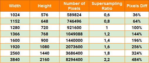

Supersampling#
Supersampling
Sets the number of samples per pixel used for supersampling. The higher the value, the more reduced aliasing is (however, high values may produce visual artifacts and significantly affect performance). Resulting number of pixels after supersampling is calculated as follows:
Number of Pixels = ( Width x supersampling_ratio ) x ( Height x supersampling_ratio )
This gives us a quadratic dependence, which means that when you set supersampling_ratio equal to 2 you'll have x4 pixels.
The table below demonstrates how supersampling ratio affects the number of pixels.
