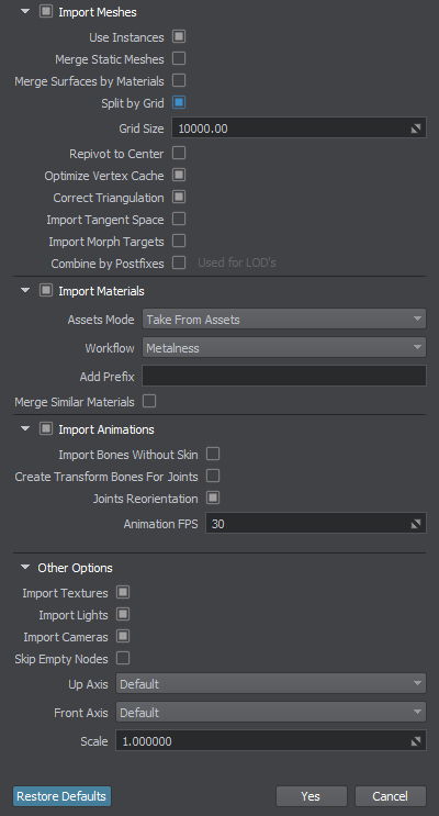

When you import an FBX asset (just like importing any other asset), the import settings window appears:
To simplify sequential import of multiple similar assets Asset Browser remembers previous asset import settings and offers to use them by default. To reset import settings to system defaults use the Restore Defaults button.
The list of available import options covers all components that can be imported from an FBX scene and includes the following:
Mesh Import Options#
Import Meshes Import geometry meshes from the file.
Use Instances Imports FBX with mesh instances. When enabled, a single mesh is imported instead of several identical ones. If you add such FBX to the scene, all meshes in the World Hierarchy will refer to the single mesh stored inside the imported FBX container.
Merge Static Meshes Merges all of the children static meshes into a single one (named after the parent mesh). All surfaces of all meshes surfaces will be copied and shown in the Surfaces hierarchy.
Merge Surfaces by Materials Enables merging surfaces that have the same materials.
Split by Grid Enables splitting of imported meshes. Too large models having sizes, that exceed 10000 units may have various artefacts (jitter, etc.) associated with positioning errors. You can eliminate such artefacts by splitting your mesh into multiple separate meshes. To do so, just enable this option and set the size of the grid cell (see the Grid Size parameter below) to be used for mesh splitting.
This option does not split surfaces.
Grid Size Size of the grid cell to split imported meshes, in units.
Repivot to Center Places a pivot of generated mesh to its center. Can be used for meshes having their geometry located too far from their pivot, as this may lead to various artefacts (jitter, etc.) associated with positioning errors.
Optimize Vertex Cache Enables vertex cache optimization. This option reorders an indexed triangle list to improve vertex cache utilization at runtime. It can be turned off to accelerate saving process; however, it should always be turned on if saving the final version.
Correct Triangulation Enables correct triangulation of meshes, NURBS and patches.
Disabling this option decreases import time, but may lead to triangulation errors resulting in incorrect geometry.
Import Tangent Space Imports built-in tangent space data instead of recalculating it.
If the option is checked, but an FBX asset has no tangent space, it will be calculated with orientation for the right-handed coordinate system.
Import Morph Targets Enables importing morph targets from the file.
Combine by Postfixes Enables automatic creation of the Levels of Detail (LODs).
Material Import Options#
Import Materials Enables importing materials from the file.
Assets Mode Enables to choose whether to use existing materials or to overwrite them with the ones imported. Available options:
  • Take From Assets - use existing materials (if any).
  • Overwrite Assets - overwrite existing materials (if any).
Workflow Provides an interface to choose a workflow for the imported physically based materials (if any). Available options:
  • Specular workflow - use the old standard of textures that was used in mesh_base material (diffuse, specular, gloss).
  • Metalness workflow - use the new standard of textures (albedo, metalness, roughness).
Add Prefix Enables to add a prefix for imported materials to avoid collision of names.
Merge Similar Materials Enables to merge materials with the same settings, but different names.
Animation Import Options#
Import Animations Enables importing animations from the file.
Import Bones Without Skin Enables importing animation skeletons without a skin from the file. If you have an FBX file containing skeletal animation without any geometry, you can import it to your UNIGINE project and use generated .anim files.
Joints Reorientation Enables changing orientation of bones for animations and animated geometry. When enabled, all bones will have the same forward axis as the geometry. This simplifies work with animations via code for programmers reducing excessive axis manipulations: if a mesh has +Y as a forward axis, the bones will have +Y as well.
Create Transform Bones for Joints Imports the hierarchy of the joints (bones) for animated FBX assets as a list of World Transform Bones. If this option is disabled, imported animations for a mesh will still work.
Animation FPS Number of frames per second of imported animation.
Other Import Options#
Import Textures Enables importing textures from the file.
Import Lights Imports light sources from an FBX scene.
Import Cameras Imports cameras from an FBX scene.
Skip Empty Nodes Enables skipping empty nodes. Complex CAD models may contain a lot of empty nodes, resulting in an overloaded world hierarchy. You can enable this option to simplify generated hierarchy by ignoring nodes, that do not contain any useful information.
Up Axis Provides an interface to choose an axis to be considered as the up vector of the World Coordinate System.
Front Axis Provides an interface to choose an axis to be considered as the forward vector of the World Coordinate System.
Scale Geometry scale multiplier.
Specific options for various types of data stored in an FBX container are described below.

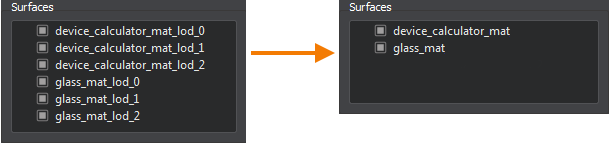

Surfaces of a single mesh generated instead of separate meshes with device_calculator and glass_mat materials assigned.
You can also merge the surfaces having the same material assigned by enabling the Merge Surfaces by Materials option.
Surfaces merged by materials.

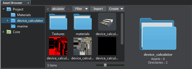

If materials are imported, the material assets are created in the materials subfolder of the folder where the .fbx asset is stored.

If textures are imported, the corresponding texture assets are created in the same folder, where the .fbx asset is stored.

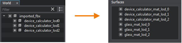

Levels of Detail#
To create several variations of one object with different level of detail (LODs) you should have them as separate surfaces of the object. This will allow you to reduce the number of nodes in the hierarchy and simplify the settings of the LODs visibility.
UNIGINE provides automatic creation of LODs based on the name postfixes. So you can create and export different meshes for different LODs of you model in a single FBX file. When naming these meshes, you should add a postfix to specify the LOD each mesh represents.
You can also enable the Merge Static Meshes option for more optimization.
  1. Firstly, enable the Combine by Postfixes parameter.
    This will show additional LODs settings:
    Max Count Number of Levels of Detail.
    Postfix Surface name postfix that determines the current LOD.
    Min Visibility The minimum distance on what this LOD is visible in camera local axes. -inf - the LOD is visible by default.
  2. Select the number of LODs that are stored in the FBX container.
  3. For each LOD define a postfix that will be used to group objects in an FBX-file into a corresponding LOD.
    The postfix must be the same as the one used when creating objects in a 3D editor.
    The names of generated surfaces will be as follows: material_name + LOD_postfix.
  4. Specify minimum visibility distance for each LOD. Maximum visibility distance of each LOD is equal to the minimum visibility distance of the next LOD. Maximum visibility distance of the last LOD is equal to inf.

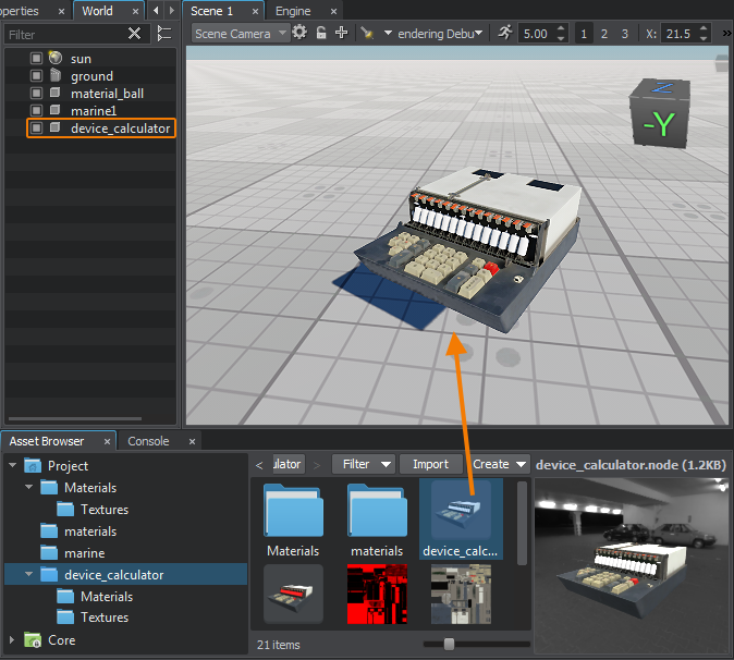

Adding Imported FBX Asset to the World#
To add a new imported FBX asset to the scene, as any other asset, simply drag it from the Asset Browser to the Viewport window. The corresponding node will be created and displayed in the World Hierarchy window. This node will have the same name as the imported FBX asset and a hierarchy of child nodes representing separate objects contained in the 3D model.
If you double-click the imported FBX asset in the Asset Browser, the .mesh and .node files generated in run-time and stored in the FBX container will be displayed:
