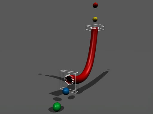

On the picture below you can see a dummy object with a dummy body and without any collision shape. It pins the physical cloth so it can hang without any rack. At the same time, it does not collide with balls that roll through it.
