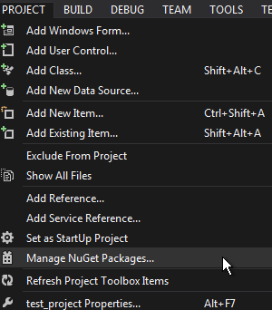

You can add your .dll libraries to the C# project to use specific structures, classes and methods. If you use Visual Studio you can add NuGet packages to your solution by clicking Project -> Manage NuGet Packages...

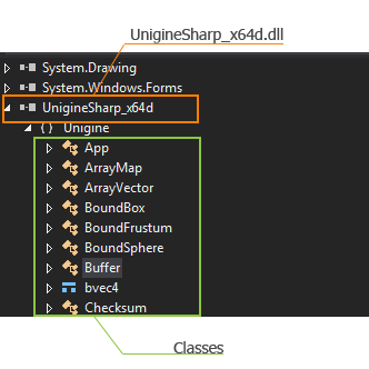

View Documentation by Using Visual Studio#
You can read the documentation of some of C# API methods by using the Object Browser in Visual Studio.

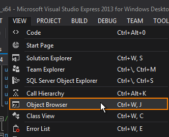

  1. In Visual Studio, click View -> Object Browser or press CTRL + W and then J.

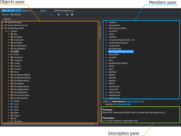

    The Object Browser window will open. The Object Browser displays three panes: an Objects pane on the left, a Members pane on the upper right, and a Description pane on the lower right.
  2. Select the UnigineSharp_x64d (or UnigineSharp_x86d) object in the Object pane and choose the class you wish to view.
  3. Specify the member in the Members pane.
  4. If the description for chosen member exists, it will appear in the Description pane.
