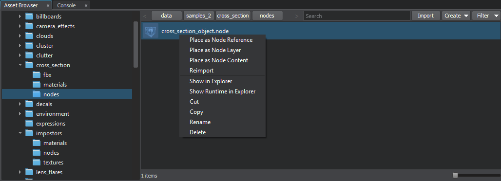

Asset Browser#
Operations of the Asset Browser window context menu:
Place as Node Reference Create a node reference by placing a selected *.node asset in the scene.
Place as Node Layer Create a node layer by placing a selected *.node asset in the scene.
Place as Node Content Create a node by placing a selected *.node asset, which can be any node type or a hierarchy of nodes, in the scene.
Inherit Create a child asset. Available for materials and properties.
Reimport Reimport a previously imported file. Used to implement updates that have been performed in a source file after the import.
Show in Explorer Show a selected file in Explorer.
Show Runtime in Explorer Show the runtime file of a selected file in Explorer.

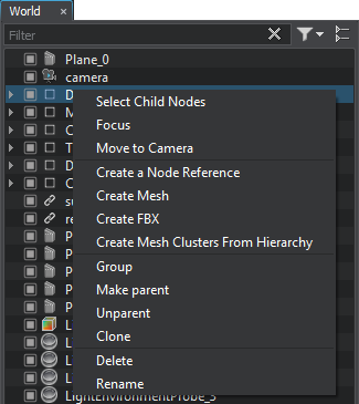

World Hierarchy#
Operations of the World Hierarchy window context menu:
Select Child Nodes Select all child nodes of a node without selecting the parent node itself. Available for parent nodes.
Focus Make the scene camera focus on the node.
Move to Camera Move the selected node into the scene camera's focus.
Create a Node Reference Create a node reference of a selected node and store it in the current folder of the Asset Browser.
Create Mesh Create a mesh of a selected node and store it in the current folder of the Asset Browser.
Create FBX Create an *.fbx file of a selected node and store it in the current folder of the Asset Browser.
Create Mesh Clusters from Hierarchy Create a mesh cluster or clusters from a selected hierarchy.
Group Create a dummy node and make selected nodes its child nodes.
Make Parent Select a group of nodes and make a right-clicked node a parent of the group.
Unparent Detach a node from its parent. A detached node is placed at the same level as the former parent.
Clone Clone a selected node.

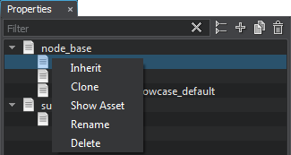

Materials Hierarchy, Properties Hierarchy#
Context menus of the Materials Hierarchy and Properties Hierarchy windows are identical:
Clone Clone an asset.
Show Asset Show an asset in the Asset Browser.
Rename Rename an asset.
Delete Permanently delete an asset from the hierarchy and the asset folder. This action cannot be undone.

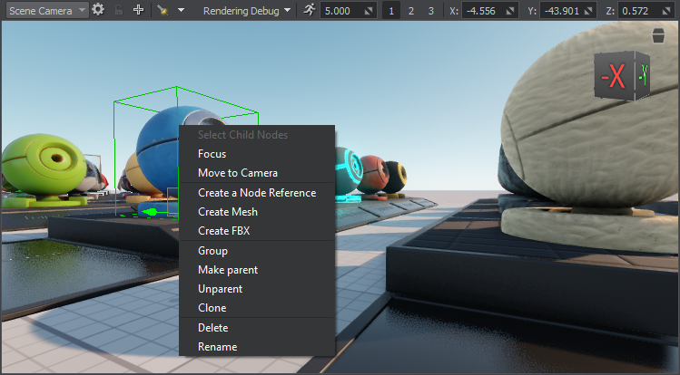

Viewport Window#
The Viewport Window has two context menus depending on where you click: if you click a node, the context menu is the same as in the World Hierarchy window, clicking outside any node opens the Create menu.

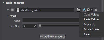

Properties context menu#
The context menu of node and surface properties is displayed by clicking right to the property field and contains the following operations:
Copy Values Copy values of all parameters of a property.
Paste Values Paste values to all destination parameters that have the same name and type as the parameters of the copied property.
Move Up Move a property one line up in the list of properties.
Move Down Move a property one line down in the list of properties.
Reset Set all property values to default.
