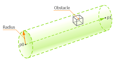

Ptr<Obstacle> getIntersection ( Vec3 p0, Vec3 p1, float radius, int mask, const Vector<Ptr<Node>> & exclude, Math::Vec3 * OUT_intersection ) #
Performs intersection to find if a pathfinding Obstacle is located within the cylinder between two points. The specified obstacles will be ignored.
World space coordinates are used for this function.

Ptr<Obstacle> getIntersection ( Vec3 p0, Vec3 p1, float radius, int mask, const Ptr<GameIntersection> & intersection ) #
Performs intersection to find if a pathfinding obstacle is located within the cylinder between two points.
The following example shows how you can get the intersection point (vec3) of the cylinder between two points with an obstacle. In this example we specify a cylinder from the point of the camera (vec3 p0) to the point of the mouse pointer (vec3 p1) with the specified radius. The executing sequence is the following:
