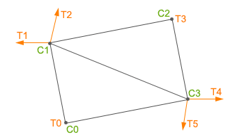

On the picture below, arrows are used to show normals:
Surface that contains 2 adjacent triangles. Here C0...C3 are coordinate vertices, T0...T5 are triangle vertices
The coordinate buffer is an array of coordinate vertices. For example, the coordinate buffer for the surface presented on the picture above is the following:
Output
CB = [C0,C1,C2,C3]
Each coordinate vertex contains coordinates ( float[3]) of the vertex.
The number of vertices and coordinate vertices is the same.
The triangle buffer is an array of triangle vertices. For example, the triangle buffer for the surface presented on the picture above is the following:
Output
TB = [T0,T1,T2,T3,T4,T5]

Both the coordinate and triangle vertices have indices. There are 2 index buffers to get proper cvertex and tvertex data for each vertex of mesh surface:
  • CIndices buffer — coordinate indices, which are links to CVertices data.
  • TIndices buffer — triangle indices, which are links to TVertices data.
The number of elements in these index buffers is equal to the total number of vertices of a mesh surface.
Coordinate Indices#
Each vertex of a mesh surface has a coordinate index - a number of the corresponding element of the coordinate buffer, where the data is stored. For the given surface the array of the coordinate indices is as follows:
Output
CIndices = [Ci0,Ci1,Ci3,Ci1,Ci2,Ci3]
Here:
  • The first 3 elements are the coordinate indices of the first (bottom) triangle.
  • The second 3 elements are the coordinate indices of the second (top) triangle.
Triangle Indices#
Each vertex of a mesh surface also has a triangle index - a number of the corresponding element of the triangle buffer, where the data is stored. For the given surface the array of the triangle indices is as follows:
Output
TIndices = [Ti0,Ti1,Ti5,Ti2,Ti3,Ti4]
Here:
  • The first 3 elements are the triangle indices of the first (bottom) triangle.
  • The second 3 elements are the triangle indices of the second (top) triangle.

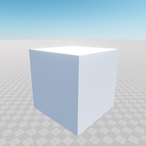

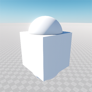

int addBoxSurface( const char * name, const Math::vec3 & size )
Appends a box surface to the current mesh.
// create a mesh instance
// add box surface with the name "box_surface" and the size of the surface is Vec3(1.0, 1.0, 1.0)
mesh->addBoxSurface("box_surface", Math::Vec3(1.0f));
// create the ObjectMeshDynamic from the Mesh object
ObjectMeshDynamicPtr dynamicMesh = ObjectMeshDynamic::create(mesh);
// add dynamicMesh to the editor as a Node object
Editor *editor = Editor::get();
dynamicMesh->release();
editor->addNode(dynamicMesh->getNode());
// set the position of the mesh
dynamicMesh->setWorldTransform(translate(Math::Vec3(10.0f,10.0f,10.0f)));
// set the material to the mesh
dynamicMesh->setMaterial("mesh_base","*");
// set the name of the mesh
dynamicMesh->setName("Dynamic Mesh");
After adding to the editor, the mesh will appear.
Arguments
  • const char * name - Surface name.
  • const Math::vec3 & size - Box size along the X, Y and Z axes.
Return value
Added surface number.

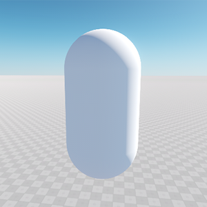

int addCapsuleSurface( const char * name, float radius, float height, int stacks, int slices )
Appends a capsule surface to the current mesh. The stacks and slices specify the surface's subdivision.
// add capsule surface with the name "capsule_surface".
// the radius of the capsule is 1.0, the height is 2.0,
// stacks and slices are equals to 200 and 100, respectively
mesh->addCapsuleSurface("box_surface", 1.0f, 2.0f, 200, 100);

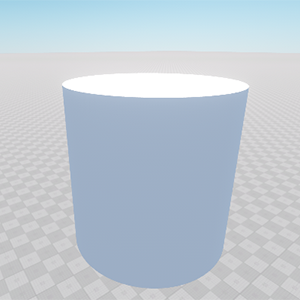

int addCylinderSurface( const char * name, float radius, float height, int stacks, int slices )
Appends a cylinder surface to the current mesh. The stacks and slices specify the surface's subdivision.
// add cylinder surface with the name "cylinder_surface".
// the radius of the cylinder is 1.0, the height is 2.0,
mesh->addCylinderSurface("cylinder_surface", 1.0f, 2.0f, 200, 100);
Arguments
  • float radius - Cylinder radius.
  • float height - Cylinder height.
  • int stacks - Number of stacks that divide the cylinder radially.
  • int slices - Number of slices that divide the cylinder horizontally.
Return value
The added surface number.

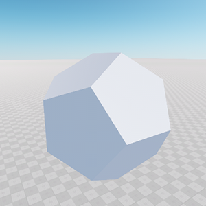

int addDodecahedronSurface( const char * name, float radius )
Appends a dodecahedron surface to the current mesh.
// add dodecahedron surface with the name "dodecahedron_surface".
// the radius of the dodecahedron is 1.0
mesh->addDodecahedronSurface("dodecahedron_surface", 1.0f);
Arguments
  • float radius - Dodecahedron radius.

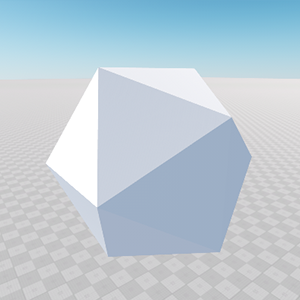

int addIcosahedronSurface( const char * name, float radius )
Appends a icosahedron surface to the current mesh.
// add icosahedron surface with the name "icosahedron_surface".
// the radius of the icosahedron is 1.0
mesh->addIcosahedronSurface("icosahedron_surface", 1.0f);

int addMeshSurface( const char * v, const Ptr<Mesh> & mesh, int surface, int target = -1 )
Appends a surface of the source mesh to the current mesh as a new surface.
The following example shows how to add a surface from the one mesh to another.
// create mesh instances
MeshPtr mesh_1 = Mesh::create();
MeshPtr mesh_2 = Mesh::create();
// add Surfaces for the added meshes
mesh_1->addCapsuleSurface("capsule_surface", 1.0f, 2.0f, 200, 100);
mesh_2->addBoxSurface("box_surface", Math::vec3(2.2));
// add the surface from the mesh_2 to the mesh_1 as a new surface
// with the name "new_box_surface"
mesh_1->addMeshSurface("new_box_surface", mesh_2, 0);
// create the ObjectMeshDynamic from the mesh_1 object
ObjectMeshDynamicPtr dynamicMesh = ObjectMeshDynamic::create(mesh_1);
