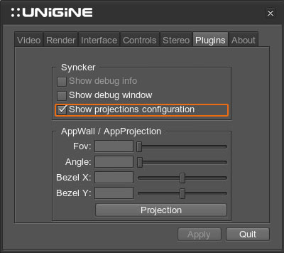

The setup mode can also be enabled via the System Menu:
  1. Open the System Menu by pressing Esc.
  2. Go to the Plugins tab and enable the Show projection configuration option in the Syncker group:
The setup mode will become available:

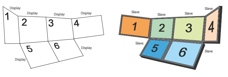

  1. Add the required number of displays.
  2. Form the projection setup by adjusting the required parameters of the displays.
  3. Click Setup Projections and adjust the required projections.
Both displays and projectors can be simulated by the projection configuration made of displays.

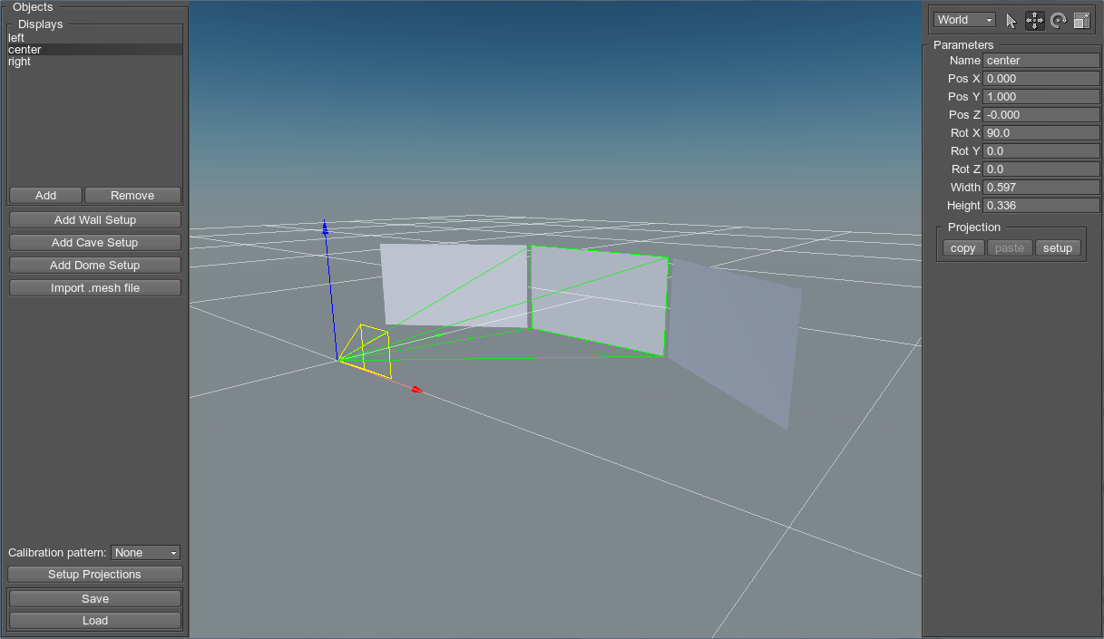

If you are going to use a multi-monitor setup, you will need to add the required number of displays and adjust its transformation and size.
To add a new display, press the Add button on the Objects panel. The default display named display will be added. Each display corresponds to one of the monitors/projectors.

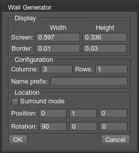

Wall preset is useful to generate a multi-monitor setup of displays formed as an array.
Choose Add Wall Setup to open the Wall Generator window.
The Wall Generator has the following parameters:
Screen Width, Screen Height Size of each display in setup.
Border Width, Border Height Distance between displays along the axis corresponding to displays' width and height.
Columns Number of columns.
Rows Number of rows.
Name Prefix Name prefix for each display in setup.
Surround Mode Defines whether displays are placed on a flat surface or on a sphere while being oriented to the viewer.
Position Position offset for the group of displays.
This parameter is available if the Surround Mode is disabled.
Radius Radius of the sphere which the displays should be placed on.
This parameter is available if the Surround Mode is enabled.
Rotation Rotation of the group of displays along all axis.
Click Ok to generate setup.

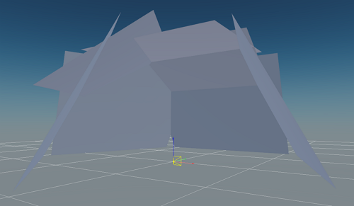

CAVE Setup#

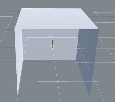

The CAVE (Cave Automatic Virtual Environment) multi-projector setup generation is supported:
Choose Add Cave Setup to open the Cave Generator window.
The Cave Generator has the following parameters:
Width Width of the whole setup.
Height Height of the whole setup.
Depth Depth of the whole setup.
Mirror Sides Defines whether side displays should be flipped horizontally.
Mirror Up/Down Defines whether up and down displays should be flipped horizontally.
Projection configuration for CAVE

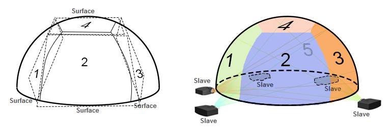

The Dome multi-projector setup generation is supported:

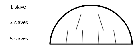

The Dome projection is usually built of several layers of projectors from bottom to top. For example, the 5-3-1 setup describes configuration that has 5 projectors on the lowest layer, 3 on the middle one and 1 projector oriented on the ceiling top.
Choose Add Dome Setup to open the Dome Generator window.
The Dome Generator has the following parameters:
Projectors aspect ratio The proportional relationship between displays width and height.
Layers The list of layers in setup. Use the Add and Remove buttons to manage the list of layers.
Projectors Number of projectors (displays) in the selected layer.
Projection configuration for Dome

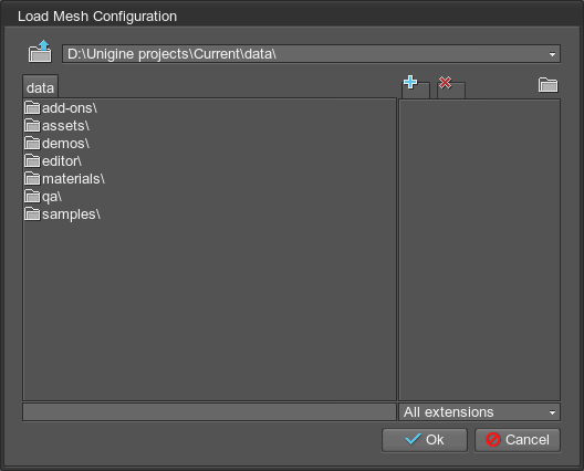

Import Mesh#
Also, configurations from the previous versions of the Syncker Plugin are supported. To import configuration in the *.mesh format, choose Import Mesh on the Objects panel and then select the desired file in the Load Mesh Configuration dialog.

Selecting and Positioning Displays
To select a single display, choose on the toolbar or by pressing Q on the keyboard and perform left mouse click on the display. You can also select a display by using the Objects panel.
Hold Shift key to add a display to selection, Ctrl - to remove.
Configuring and Transforming multiple selected displays are also supported.
Use the transform tools to manually transform a display or several displays the same way as in the Editor 2.
Use the pivot tool to choose between the pivot modes: World or Local, so you can transform displays just the way it is made in the Editor 2.
Display Parameters
To configure the selected display, adjust parameters on the Parameters panel:
Name Name of the display.
Pos X Position of the display along the X axis relative to the viewer.
  • If a positive value is specified, the display is moved to the right relative to the viewer.
  • If a negative value is specified, the display is moved to the left.
Pos Y Position of the display along the Y axis relative to the viewer.
  • If a positive value is specified, the display is moved forward relative to the viewer.
  • If a negative value is specified, the display is moved backward.
Pos Z Position of the display along the Z axis relative to the viewer.
  • If a positive value is specified, the display is moved up relative to the viewer.
  • If a negative value is specified, the display is moved down.
Rot X Rotation of the display about the X axis.
Rot Y Rotation of the display about the Y axis.
Rot Z Rotation of the display about the Z axis.
Width Width of the display.
Height Height of the display.
Any changes in these parameters are immediately applied to the selected display.
To delete a display, press the Remove button or Delete key.

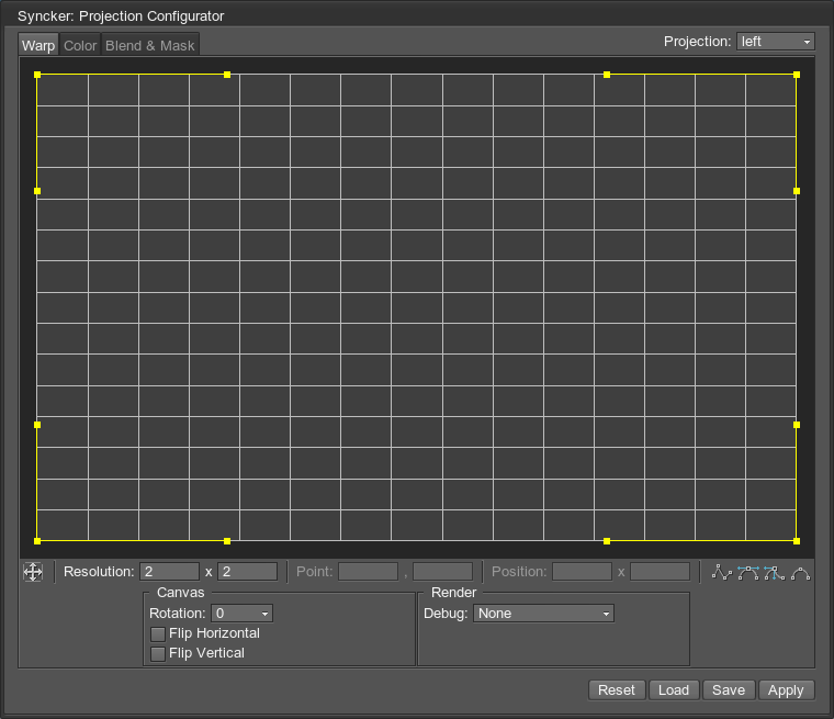

Setting Up Projections#
A projection for the display is adjusted via the Projection Configurator window that is opened by pressing the Setup Projections button on the Objects panel:
Any changes made via this interface are immediately applied to the specified projection.
For displays, the projection is set up relative to the viewer's position (as it is fixed).

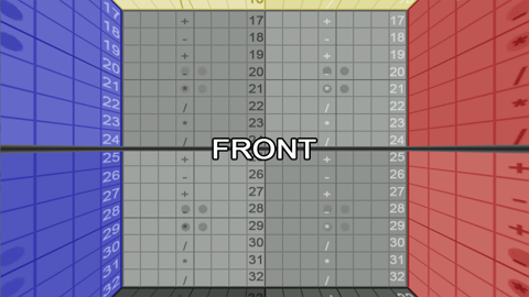

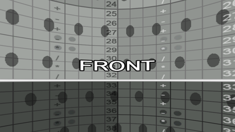

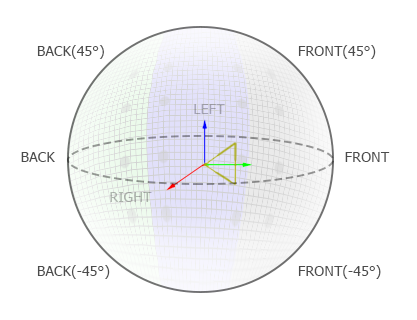

For proper configuration you can enable the Calibration Pattern on the Objects panel. It represents the grid pattern projected on a certain shape which is useful to calibrate displays by avoiding the image distortion. There are the following options:
  • None - no pattern applied, the engine viewport is rendered in each display.
  • Sphere - the Sphere test pattern is shown by displays.
    Directions are marked with angles for convenience:
  • Box - the Box test pattern is shown by displays.
Aim to keep the grid and circles pattern distortion-free.
