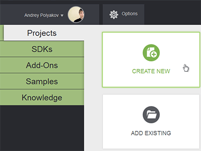

  1. Open the UNIGINE SDK Browser.
  2. Go to the Projects tab and click CREATE NEW.

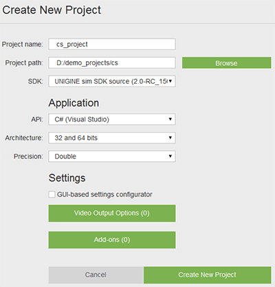

  3. Specify the following parameters:
    • Project - specify the name of your project.
    • Project Path - specify the path to your project folder.
    • SDK - choose the Unigine SDK.
    • API - here choose C# (Visual Studio) to start working with the C# API.
    • Architecture - specify the architecture of your target platform.
    • Precision - specify the precision. In this example we will use double precision.
    Read more about these parameters in this article

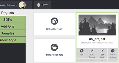

  4. Click the Create New Project button. The project will appear in the projects list.
You can run your project by clicking the Run button.

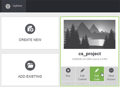

  1. In the UNIGINE SDK Browser, choose your C# project and click the Edit Code button.
    Visual Studio will be opened.

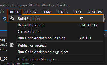

  3. Build your project by clicking Build -> Build Solution in Visual Studio or press F7.

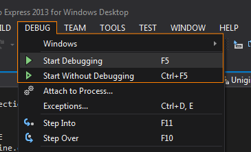

  4. Start your project by clicking Debug -> Start in a proper mode in Visual Studio.
