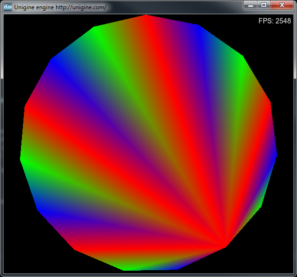

Output#
The following result will be shown:
