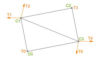

On the picture below, arrows are used to show normals:
Surface that contains 2 adjacent triangles. Here C0...C3 are coordinate vertices, T0...T5 are triangle vertices
The coordinate buffer is an array of coordinate vertices. In order to reduce data duplication, vertices of surface which have the same coordinates are saved only once in the buffer. For example, the coordinate buffer for the surface presented on the picture above is the following:

The triangle buffer is an array of triangle vertices. For example, the triangle buffer for the surface presented on the picture above is the following:
Output
TB = [T0,T1,T2,T3,T4,T5]

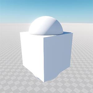

Copying Mesh Surfaces#
By using the Mesh class you can copy surfaces from one mesh to another.
In the following example we create two meshes with different surfaces. The first mesh has the capsule surface, the second has the box surface. We copy the box surface from the second mesh to the first. The executing sequence is:
  • Create 2 instances of the Mesh class and add capsule and box surfaces to them.
  • Add the box surface from the second mesh (mesh_2) and add it to the first mesh (mesh_1) by using the addMeshSurface() function.
  • Create a new ObjectMeshDynamic mesh from the mesh_1 instance.
  • Add the dynamic mesh to the editor and set the material, property and name.
// create mesh instances
MeshPtr mesh_1 = Mesh::create();
MeshPtr mesh_2 = Mesh::create();
// add surfaces for the added meshes
mesh_1->addCapsuleSurface("capsule_surface", 1.0f, 2.0f, 200, 100);
mesh_2->addBoxSurface("box_surface", Math::vec3(2.2f));
// add the surface from the mesh_2 to the mesh_1 as a new surface
// with the name "new_box_surface"
mesh_1->addMeshSurface("new_box_surface", mesh_2, 0);
// create the ObjectMeshDynamic from the mesh_1 object
ObjectMeshDynamicPtr dynamicMesh = ObjectMeshDynamic::create(mesh_1);
// add dynamicMesh to the editor as a Node object
Editor *editor = Editor::get();
dynamicMesh->release();
editor->addNode(dynamicMesh->getNode());
// set the position of the mesh
dynamicMesh->setWorldTransform(translate(Math::Vec3(10.0f, 10.0f, 10.0f)));
// set the material to the mesh
dynamicMesh->setMaterial("mesh_base", "*");
// set the name of the mesh
dynamicMesh->setName("Dynamic Mesh");
You can copy a surface from the source mesh and add it to the existing surface of the current mesh without creating a new one.
The ObjectMeshDynamic mesh will appear in the editor:
ObjectMeshDynamic with 2 surfaces

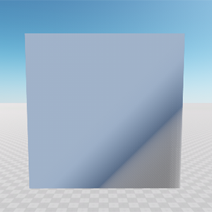

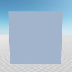

Adding Vertices and Changing Their Attributes#
The Mesh class allows adding vertices to a mesh and change vertex attributes.
In the following example, we create a plane by adding vertices to the mesh and change the attributes of some of these vertices. Let's clarify this:
  • Create the Mesh class instance and add 4 vertices to it.
  • Add 6 indices to create a plane.
  • After that tangents and normals are created by using the createTangents() and createNormals() functions.
  • The bounds of the mesh are updated to include all new vertices via the createBounds() function.
  • Current normal values of the 2 vertices are shown in console. After changing, new values are shown in console.
  • Tangent is shown in the console, and then it is changed and shown in the console again.
  • Create a new ObjectMeshDynamic mesh from the mesh instance.

When setTangent() and setNormal() functions were called, the normal and the tangent changed their values.
Let's comment this part of the code:
// get the tangent value
Math::quat tangent = mesh->getTangent(0, 0, 0);
// show the tangent value in the console
Log::message("tangent is: %s: %0.1f %0.1f %0.1f %0.1f\n",
	typeid(tangent).name(),
	tangent.x,
	tangent.y,
	tangent.z,
	tangent.w);
// set the new value of the tangent
mesh->setTangent(0, Math::quat(0.0, -0.0, -0.0, 1), 0, 0);
// get the new tangent value
Math::quat new_tangent = mesh->getTangent(0, 0, 0);
// show the tangent value after changing
	typeid(new_tangent).name(),
	new_tangent.x,
	new_tangent.y,
	new_tangent.z,
	new_tangent.w);
The result will be different. You can see what influence the tangent has on the vertex:

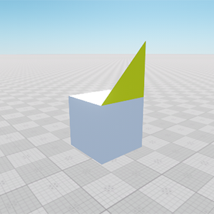

Adding a Surface to the Existing Mesh#
This section contains information on how to add a surface to the existing mesh.
In the following example, we add a surface to the existing mesh and then add necessary vertices and indices for the surface:
  1. Create a new mesh instance from the file.
  2. Add a new surface to the mesh.
  3. Add vertices for the mesh surface.
  4. Create indices for recently created vertices by using the createIndices() function.
  5. Update the bounds of the mesh to include the created surface by using the createBounds() function.
  6. Create a material to be assigned to the added surface.
  7. Save mesh to the file and add it to the editor.
In the example, the box.mesh file has been taken from the UNIGINE SDK Samples. However, you can create a box mesh and save it to a file as follows:
// create an empty Mesh instance
MeshPtr box = Mesh::create();
// add a box surface to the Mesh
box->addBoxSurface("surface_box", Math::vec3(1.0f));
// save the box to a file
box->save("unigine_project/meshes/box.mesh");
// load a mesh form the file
MeshPtr mesh = Mesh::create("unigine_project/meshes/box.mesh");
// add a new surface
mesh->addSurface("surface_triangle");
// add 3 vertices to the new surface
mesh->addVertex(Math::vec3(-0.5f, 0.5f, 0.5f), 1);
mesh->addVertex(Math::vec3(-0.5f, -0.5f, 0.5f), 1);
mesh->addVertex(Math::vec3(-0.5f, -0.5f, 1.5f), 1);
// create indices for the new surface
mesh->createIndices(1);
// create a new boundbox for the mesh including new surface
mesh->createBounds();
// save mesh to file
mesh->save("unigine_project/meshes/box_2.mesh");
// create ObjectMeshStatic from the Mesh object
ObjectMeshStaticPtr staticMesh = ObjectMeshStatic::create("unigine_project/meshes/box_2.mesh");
// add static to the editor as a Node object
staticMesh->release();
editor->addNode(staticMesh->getNode());
// prepare a material for the added surface:
Materials *materials = Materials::get();
// find the mesh_base material
MaterialPtr mesh_base = materials->findMaterial("mesh_base");
// inherit a new material from it
MaterialPtr material = mesh_base->inherit("mesh_base_yellow", "unigine_project/materials/mesh_base_yellow.mat");
material->setParameter(Material::PARAMETER_COLOR, Math::vec4(255, 255, 0, 255));
staticMesh->setWorldTransform(translate(Math::Vec3(10.0f, 0.0f, 2.0f)));
// set the material to the mesh surfaces
staticMesh->setMaterial("mesh_base", 0);
staticMesh->setMaterial("mesh_base_yellow", 1);
The triangle surface added to the mesh:
