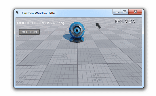

Below you'll find the code that performs the following:
  • Sets a custom icon and title for the application window
  • Sets a custom mouse cursor
  • Switches between the following two mouse control modes by the ENTER key:
    • Camera control - the cursor is invisible and controls the camera (movement area restricted to the application window)
    • UI control - the cursor is visible and can be used to interact with application UI (movement area unrestricted)
  • Switches between restricted (only application window area) and unrestricted mouse movement mode by the SHIFT key
Insert the following code into the AppWorldLogic.cpp file.
