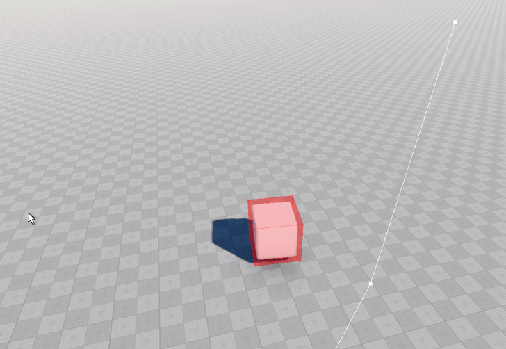

In the example above, the route is recalculated each frame. However, it is non-optimal for application performance. You can calculate the route, for example, once per 10 frames.
In the result, you will have a simple navigation sector, in which the dynamically changing obstacle box is placed.
Here the obstacle is highlighted with red
