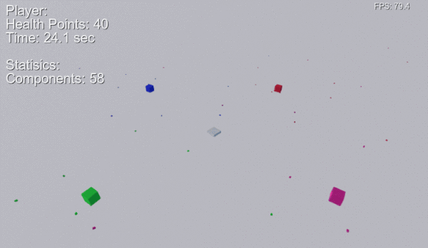

Let's make a simple game to demonstrate how the whole system works.
Game Description#
In the center of the play area, we are going to have an object (Pawn) controlled by the player via the keyboard. It has certain amount of HP and movement parameters (movement and rotation speed).
Four corners of the play area are occupied by rotating objects (Spinners) that throw other small objects (Projectiles) in all directions while rotating.
Each Projectile moves along a straight line in the directon it has been initially thrown by the Spinner. If a Projectile hits a Pawn, the Pawn takes damage according to the value set for the hitting Projectile (each of them has a random speed and damage value). The pawn is destroyed if the amount of HP drops below zero.
We use boxes for simplicity, but you can easily replace them with any other objects.

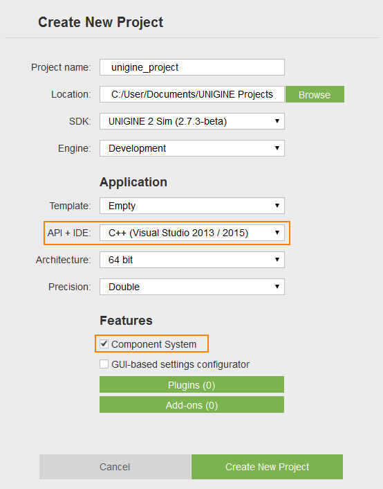

1. Prepare a Project#
Before we can start creating components and implementing our game logic, we should create a project.
  1. Create a new C++ project.
  2. Enable the Component System feature.
