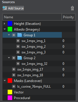

To add a new source, click the Add Source button.
In the opened window, specify the following fields:
Layer The imagery, elevation, landcover, vector or procedural layer of the data source.
Name The name of the layer that will be displayed in the Sources panel.
Path The path to the data source file or folder. For geo-referenced terrain generation, the sources with no geodata can be used along with the geo-referenced ones. So, there are the following options:
  • To specify the geodata source, choose the geo-referenced type in the drop-down list and click the ... button to specify the path.
  • To specify the ordinary image(s) with no geodata, choose the source tileset type and click ... to specify the path. Check the Create a Terrain article to learn more about loading source tilesets.
Do not store the data source files in the data folder of the project as it will cause the following issues:
  • The unnecessary runtime files will be generated.
  • You won't be able to load such files as data sources as the engine file system will use the generated runtimes instead. For example, if you specify a .tif file, the file system will load the generated .dds runtime file that doesn't supported.
When you add the imagery, elevation, landcover, vector or procedural data sources to the Landscape tool, their areas will be highlighted on the Preview panel with corresponding colors: blue for elevation, green for imagery, red for landcover, yellow for vector and magenta for procedural. Area size of procedural sources is adjustable.
To delete the selected data source, press or right-click the source and choose Delete in the drop-down list.
You can create groups of data sources for each data layer, just right-click on a layer and select Add New Group. Thus, you can improve the structure of your data and manage all group members at once (enable/disable, add tags, modify parameters, etc.)

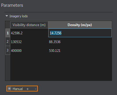

At this step you can check out the parameters of Terrain LODs to be generated for all data layers (elevation, imagery, normal, and detail masks) and determine the natural features of the landscape.
LOD Settings#

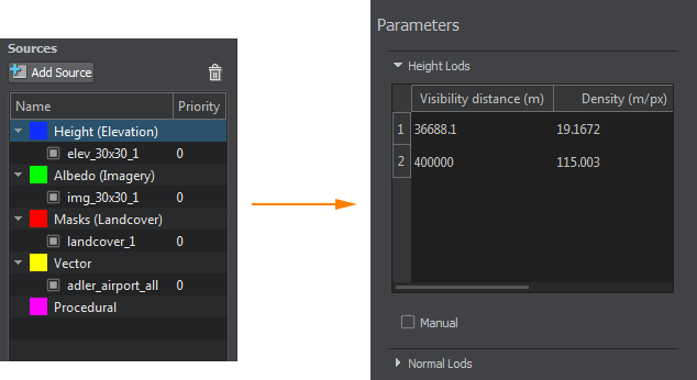

To access LOD settings of the particular data layer of your terrain, select the data source group in the list: all available settings will be displayed on the Parameters panel.
The Landscape Tool sets the number of LODs, their visibility distances and densities automatically. You can change these settings when necessary. To modify LOD settings for the desired data layer you should set Manual mode by checking the corresponding option located just under the list of LODs (see the picture below).
In the manual mode you can modify density and visibility distance values by simply double-clicking on the corresponding cell and entering the desired value. Use + (plus) button to add a LOD, or - (minus) to remove one.
In the manual mode, the LOD density should be specified more accurate, as this value determines the size of the tileset of the generated LOD: the higher the LOD density, the bigger the LOD tileset (the density is multiplied by 128 (the size of a single tile)). Specifying high values may lead to visual artifacts at the edges of the terrain.

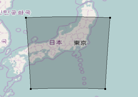

Play Area is a rectangular area of a landscape to be generated.
Play Area in Georeferenced Mode
Play Area represents a gray outlined rectangular area in the Preview panel. Depending on the type of the output projection, it can look like a trapezium near the terrestrial poles due to the equirectangular projection, or it can be rectangular (if the Flat mode is set).

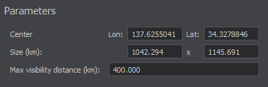

Click on the Play Area settings. In the Parameters panel the available parameters for Play Area will appear:
You can specify the following parameters:
Center Play Area's central point coordinates.
Size (km) The size of the Play Area: width x height
Max visibility distance (km) The maximum visibility distance of the Play Area in kilometres.

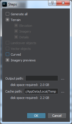

Now you can generate the terrain by clicking the Generate button.
In the Generation Steps window, that appears, you can select what is to be generated.
You can modify these options each time you need to re-generate specific part of the terrain data, saving the time required for regeneration of the whole terrain.
Generate all The whole terrain with detail masks, landcover objects and vector objects (spline, vector, and point) will be generated. This option is selected by default.
Terrain Only terrain will be generated. Here you can select parts of terrain data used for generation (Elevation, Imagery, Details)
Landcover objects Only landcover objects will be generated.
Vector objects Only vector objects will be generated.
Curved The flag indicating if the generated terrain should be curved (WGS-84 ellipsoid datum).
Landscape tool uses WGS-84 ellipsoid by default. After terrain generation, you can specify the Geodetic Pivot object's settings and choose another ellipsoid reference (including custom).
Imagery previews The flag indicating if imagery previews are to be generated and placed at the corresponding location on the map displayed on the Preview panel. Thus, you can mark areas of the global map for which the terrain was generated.
Also you can specify or change the output path for your terrain data and cache parameters.

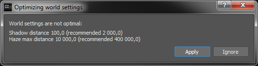

After successful generation process, the Landscape tool may offer your world settings optimizations. We recommend you to apply them, however, you can ignore.
