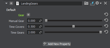

  1. Assign the LandingGears property to the parent node (aircraft).
    The following property parameters are available:
    • Gear - indicates that gears are extended
    • Time Covers - cover opening time, in seconds
    • Time Gears - gear extension time, in seconds
    Make sure all pivots are set up properly.

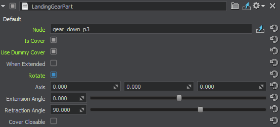

  2. Define which nodes represent parts of landing gears and assign the LandingGearPart property to them.
    • Node - the node to be moved (usually the node to which this property is assigned)
    • Is Cover - indicates whether the part is a cover or not (a cover is opened prior to gear extension)
    • Use Dummy Cover - indicates whether the wheel well is to be covered with a dummy cover after gear retraction. When enabled, an additional When Extended option is displayed. It is used to specify whether the dummy cover shall be visible when the gear is extended.
      If this option is enabled the Node field should not contain the node to which this property is assigned, as the component will be disabled forever after retraction.
    • Rotate - indicates whether the part should rotate
    • Axis - coordinates of the part's rotation axis
    • Extension Angle - rotation angle of the part, when the gear is extended, in degrees
    • Retraction Angle - rotation angle of the part, when the gear is retracted, in degrees
    • Cover Closable - indicates whether the cover should close after gear extension, or to stay open

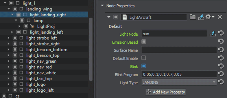

  1. Assign the LightAircraftController property to the parent node (aircraft) and leave all parameters unchanged.
  2. Assign the LightAircraft property to each node representing aircraft lights of various types.
    • Light Node - the light source node
      This field may contain the node itself, however be aware that a component may turn itself off forever.
    • Emission Based - indicates whether material's emission state is to be toggled instead of the node. When enabled, an additional Surface parameter is displayed. It is used to specify the surface, for which emission state is to be toggled.
    • Default Enable - indicates whether the light should be enabled by default
    • Blink - indicates whether the light should blink. When enabled, an additional Blink Program parameter is displayed. It is used to specify blinking mode for the light as a sequence of semicolon-separated on and off intervals, in seconds.
    • Light Type - aircraft light category selection (landing, taxi, beacon, navigation, etc.)

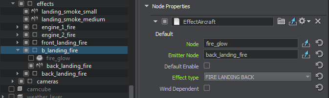

  1. Assign the EffectAircraftController property to the parent node (aircraft) and leave all parameters unchanged.
  2. Assign the EffectAircraft property to each node representing visual effects of various types.
    • Node - a node to be enabled/disabled
    • Emitter Node - a node emitting particles for the effect
    • Default Enable - indicates whether the effect should be enabled by default
    • Effect Type - aircraft effect type selection (engine or landing gear fire, smoke, contrail, etc.)
    • Wind Dependent - indicates whether the effect is affected by wind or not
