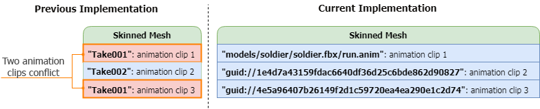

The workflow for skinned animations has changed, however the legacy mode for skinned meshes is supported (enable it via skinned_legacy_mode 1) to ensure compatibility with projects of older versions.
Although this mode is not recommended because of name collisions vulnerability, in this mode the ObjectMeshSkinned class will provide functionality of the previous version.
Identifying animation clips assigned to a skinned mesh by names is considered unsafe in terms of name collisions — animation clips aren't always named appropriately, they may conflict and replace each other because of name intersections.
New skinned animation system stores paths to animation asset files to identify internal representation of animation clips explicitly. You can access assets either by path or by GUID (virtual path), the given path to the asset will be used as a unique identifier of the animation clip for controlling skinned animation via the addAnimation(), setAnimation() and findAnimation() functions.
The number of animation clips that can be loaded from an .anim and .mesh asset is now limited to 1.
When you import your model with animations from an FBX container, the following path to your *.anim files should be used: <path_to_your_fbx_file>/<file.fbx>/<your_anim_file.anim>
For example: object->addAnimation("models/soldier/soldier.fbx/run.anim");
However, the recommended workflow is to use GUIDs of the animation assets:
UGUID guid = FileSystem::get()->getGUID(anim_asset.getRaw());
int animation_1 = skinned_mesh->addAnimation(mesh,guid.getFileSystemString(), "run");
