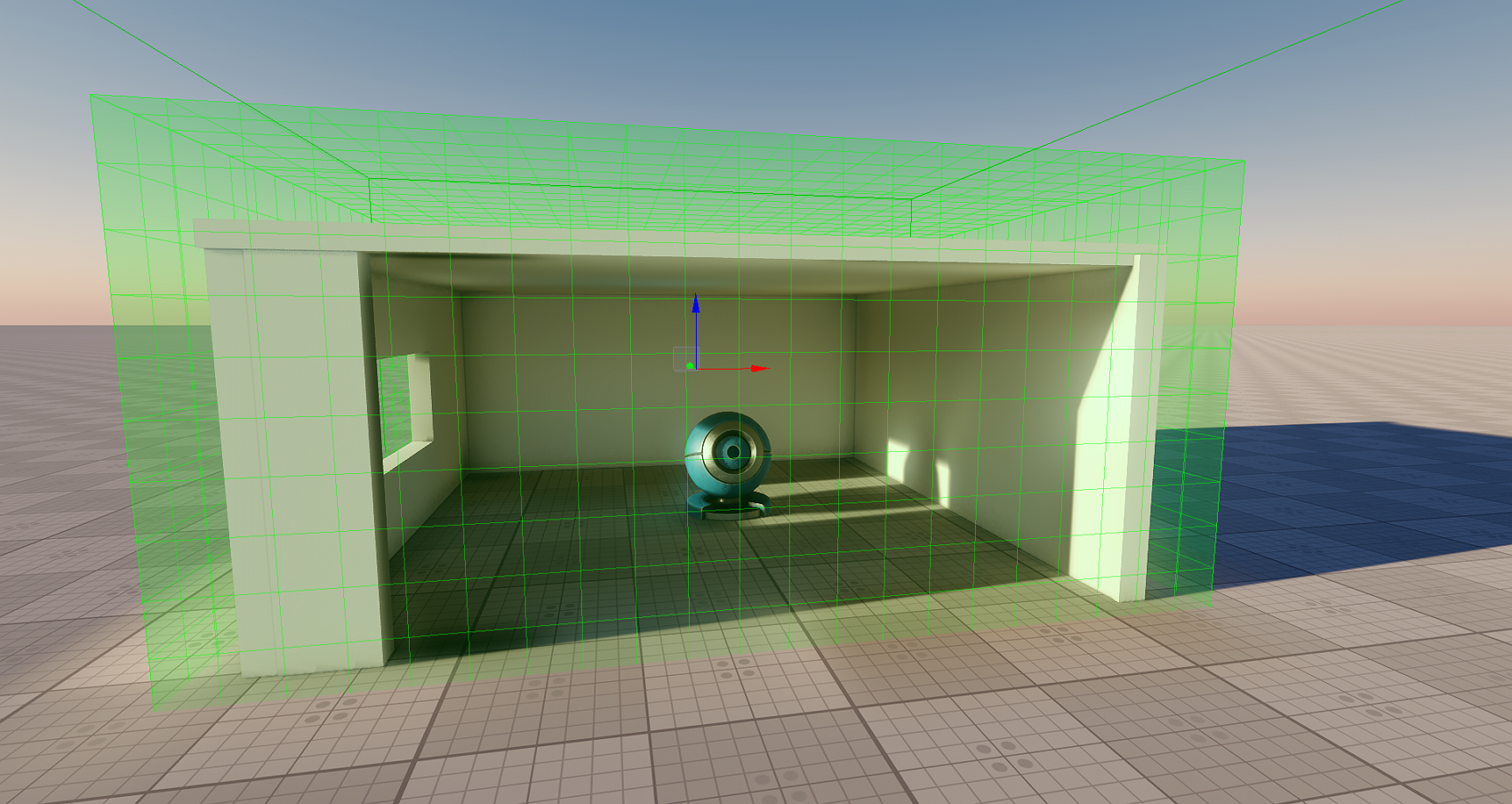

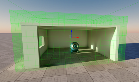

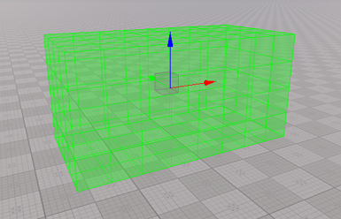

Voxel Probe provides box volume composed of voxels and contains parameters used for light baking inside it.
Voxel Probe projects a 3D lighting texture on objects inside it thus providing indirect lighting simulation.

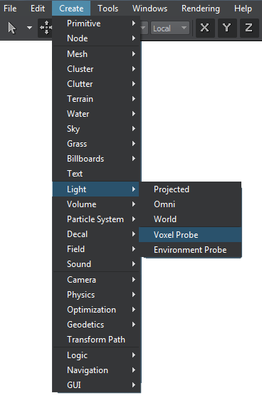

To add a Voxel Probe object to the scene via UnigineEditor, do the following:
  1. On the Menu bar, click Create -> Light -> Voxel Probe.
  2. Place the probe somewhere in the world.
  3. Bake Lighting or set the Texture parameter by choosing a prebaked lighting texture from assets.

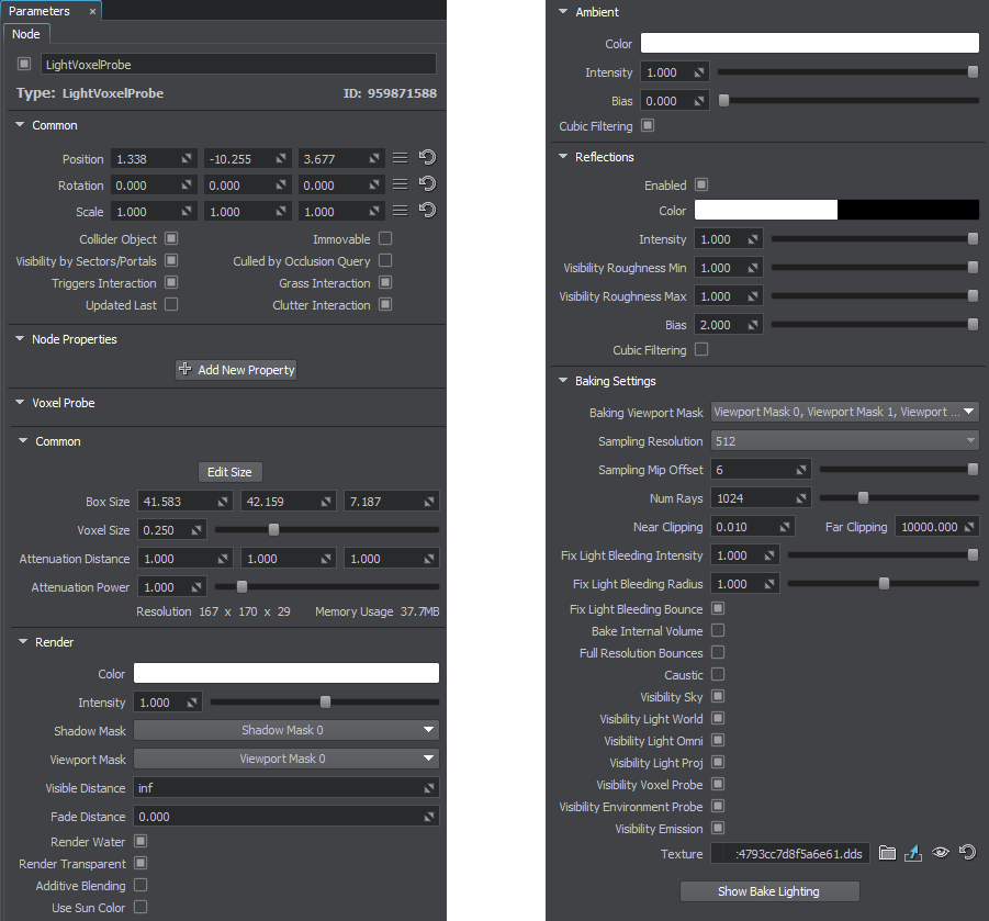

Voxel Probe Settings#
Parameters of the voxel probe light are available in the Node tab of the Parameters window. It includes both the common and the specific parameters. A set of specific ones is described below.
Common Parameters#

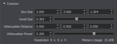

Box Size Specifies the size of the box volume.
Voxel Size Sets the size of a voxel.
If the Box Size is not divisible to the Voxel Size without remainder, the voxel probe uses the lowest volume of voxels covering the box.
These two parameters define the resolution of the voxel probe. Note that the memory usage is cubically dependent on the resolution, double growth of the voxel size causes eight-times growth of the size of the lighting texture.

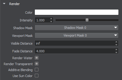

Render Parameters#
Additive Blending Enables the additive blending mode for the voxel probe. This option offers more flexibility in lighting control. You can use it to blend lighting of several voxel probes together and control them separately (e.g. make a separate voxel probe for an indoor emissive light source and blend it with another voxel probe with lighting baked from the sky, having the ability to enable and disable them separately).
Voxel probes with additive blending enabled cannot be used as insets to add lighting details (e.g. creating a small high-detail voxel probe inside a large low-detail one). Such probes do not replace each other, as they are blended instead.
Use Sun Color Enables the influence of sun light color on the voxel probe. When enabled, this option makes the voxel probe color black at night, or orange at sunset.
To bake lighting from the sky separately with this option enabled, it is recommended to enable baking visibility for the sky only, while disabling it for other light sources.
Changing this option requires the lighting to be re-baked.

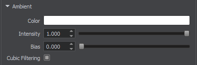

Ambient Parameters#
Color Sets the color of ambient lighting.
Intensity Sets the intensity of ambient lighting.
This parameter is used for manual adjustment in case if resulting intensity is too high or insufficient.
Bias Sets the bias of ambient lighting by adjusting the voxels offset for fine tuning.
Cubic Filtering Enables the cubic filtering of ambient lighting.
When disabled, the linear filtering is used.

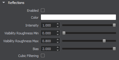

Reflections Parameters#
Enabled Enables reflections for the Voxel Probe. By default Voxel Probes are used for lighting only, as for reflectons, it is recommended to simulate them using Environment Probes. This approach ensures the best result, however you can still enable reflections for a Voxel Probe via this option.
Color Sets the color of the reflection.
Intensity Sets the intensity of voxel probe's reflection. 0 value means no reflection.
Visibility Roughness Min Sets the lower bound of the roughness range within which the reflections of the voxel probe are visible.
Visibility Roughness Max Sets the higher bound of the roughness range within which the reflections of the voxel probe are visible.
The roughness range helps to choose between diffuse reflection of the voxel probe and other ones (reflection from an environment probe, the environment cubemap) for all materials having the Roughness parameter.
Bias Sets the bias of reflection by adjusting the voxels offset for fine tuning.
Cubic Filtering Enables the cubic filtering of reflection.

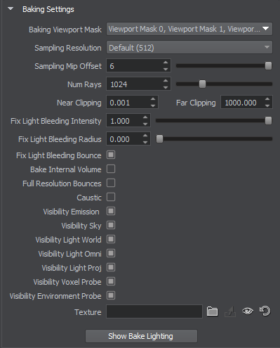

Baking Settings#
The following parameters describe the way the light shall be baked inside the probe, so you need to re-bake lighting, when you make changes to these parameters.
Baking Viewport Mask Sets the baking viewport mask which specifies the surfaces to be baked basing on their material's Viewport Mask.
Sampling Resolution Sets the sampling resolution of the voxel probe.
Sampling Mip Offset Sets the sampling mip offset of the voxel probe.
Num Rays Sets the number of rays casted for each sample during light baking.
Near Clipping Sets the distance to the near clipping plane used for every voxel during light baking.
Far Clipping Sets the distance to the far clipping plane used for every voxel during light baking.
Fix Light Bleeding Intensity Sets the intensity of light bleeding correction, which provides fine control over color intensity of the emitted light:
  • The minimum value of 0 corresponds to disabled correction.
  • The maximum value of 1 equals maximum correction.
Fix Light Bleeding Radius Sets the distance on which light bleeding is fixed.
Fix Light Bleeding Bounce Enables light bleeding correction of Voxel Probe.
Bake Internal Volume Enables internal volume baking of Voxel Probe.
  • Enabled option corresponds to baking all voxels of the probe.
  • Disabled option equals baking the voxels that cover geometry and skipping the empty ones.
Having baked internal volume makes it possible to realistically shade dynamic objects that move inside the voxel probe as the lighting texture is projected onto all the geometry. If the option is disabled, the lighting is interpolated between neighboring voxels.
Full Resolution Bounces Enables calculation of bounces at full resolution. Defines whether indirect light bounces are computed at the same full resolution as the last one or the resolution should increase from the lowest to full with each bounce iteration.
Caustic Enables caustics calculation for the voxel probe.
It is recommended to increase sampling resolution and number of rays when enabling this option. Enabling caustics calculation may result in increased noise.
You can use the following 7 visibility options together with additive blending to provide more flexibility in light baking. Thus, you can make voxel probes independent of each other and combine them to produce some sort of dynamic GI effect.
Visibility Sky Enables baking of lighting from the sky to the voxel probe.
Visibility Light World Enables baking of world light sources to the voxel probe.
Visibility Light Omni Enables baking of omni light sources to the voxel probe.
Visibility Light Proj Enables baking of projected light sources to the voxel probe.
Visibility Voxel Probe Enables baking of other voxel probe light sources to the voxel probe.
Visibility Environment Probe Enables baking of environment probe light sources to the voxel probe.
Visibility Emission Enables baking of emission light sources to the voxel probe.
Texture Sets the 3D lighting texture.
Every bake lighting procedure makes changes to the asset which is set for this parameter.
You can leave the field empty to avoid losing content. In this case a new generated lighting texture will be set for this parameter after the bake lighting procedure. Generated textures are stored in the data/bake_lighting folder.
