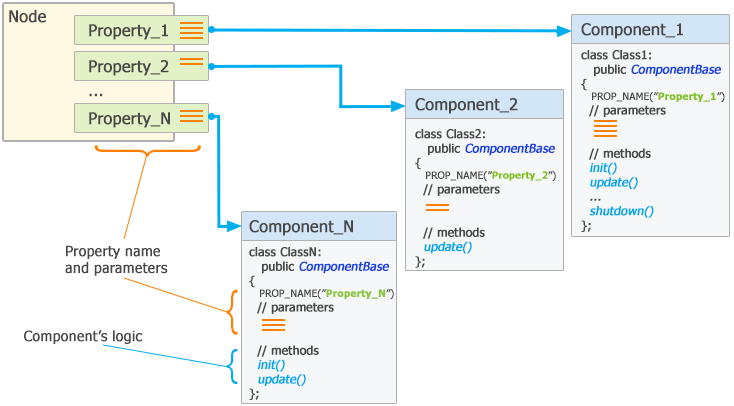

A logic component integrates a node, a C++ class, containing logic implementation (actions to be performed), and a property, defining a set of additional parameters to be used. The list of parameters as well as their types are the same for both, the component and the corresponding property.
Components assigned to a node via properties
