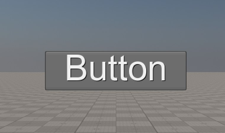

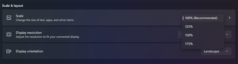

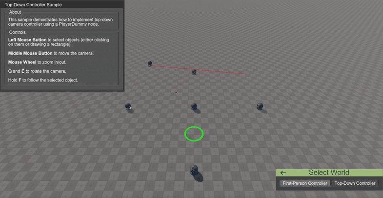

Example #1. System scaling: 125%.
When doing size and position calculations it's important to do them in one unit system (pixels or logical units) and then convert the results to the target, unit system, if necessary. Intermixing of pixels and logical units in calculations might likely lead to incorrect behavior and appearance at DPI scales > 100%, as can be seen here with the offset primitive shapes in WidgetCanvas.

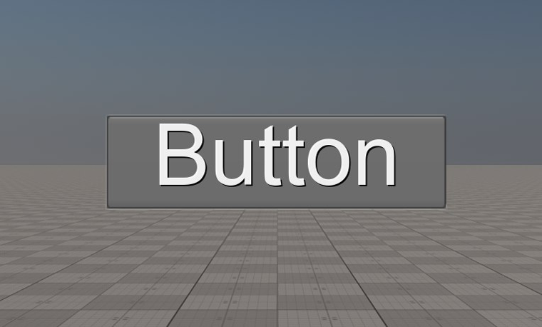

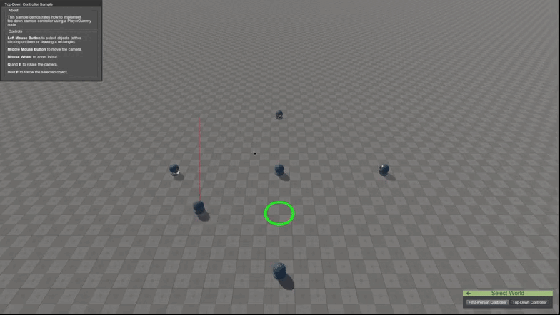

Example #2. System scaling: 175%.
// When working with raw mouse coordinates (e.g. Input::getMousePosition())
// it's important to remember that these coordinates are usually in
// global screen coordinates (pixels), whereas most other UI sizes
// are in logical units by default (e.g. window size).
ivec2 mouse_pos = Input::getMousePosition(); // pixels
ivec2 client_pos = window->getClientPosition(); // pixels
${#HL}$ivec2 client_size = window->getClientSize(); // units - WRONG ${HL#}$
if (client_pos.x > mouse_pos.x && mouse_pos.x > (client_pos.x + client_size.x))
if (client_pos.y > mouse_pos.y && mouse_pos.y > (client_pos.y + client_size.y))
// intersection
${#HL}$client_size = window->getClientRenderSize(); // pixels - CORRECT
// or
client_size = window->toRenderSize(window->getClientSize()); // pixels - CORRECT ${HL#}$
// intersection

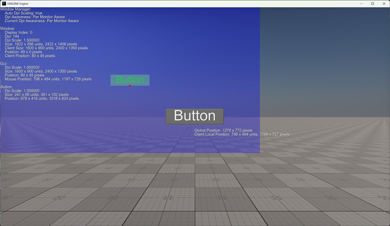

Example #3. Same GUI at 200% scaling.

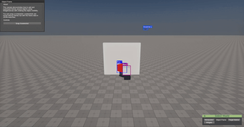

If you want to enable window viewport scaling but not apply it to widgets yet, use DPI Awareness Level 1 (System Aware) or DPI Awareness Level 2 (Per Monitor DPI Aware) and disabled Auto DPI Scaling. To do this, use the following launch arguments:
- -dpi_awareness 1 -auto_dpi_scaling 0
- -dpi_awareness 2 -auto_dpi_scaling 0
The window will allow you to get the current value of DPI, but the widget scale will remain at 100%.
AppSystemLogic.cppivec2 pixels_window_size(1920, 1080); // pixels window->setSize(pixels_window_size); // wrong, pixels -> units window->setSize(window->toUnitSize(pixels_window_size)); // correct, units -> units // window window->setSize(ivec2()); // units window->getSize(); // units window->getRenderSize(); // pixels window->setClientSize(ivec2()); // units window->getClientSize(); // units window->getClientRenderSize(); // pixels window->setMinSize(ivec2()); // units window->getMinSize(); // units window->getMinRenderSize(); // pixels window->setMaxSize(ivec2()); // units window->getMaxSize(); // units window->getMaxRenderSize(); // pixels window->setMinAndMaxSize(ivec2(), ivec2()); // units window->toRenderSize(ivec2()); // units to pixels window->toUnitSize(ivec2()); // pixels to units window->globalToLocalUnitPosition(ivec2()); // pixels to units window->localUnitToGlobalPosition(ivec2()); // units to pixels
Since there is access to the current window DPI, you can manually calculate the current scale. It can be applied to individual widgets and to individual widget parameters. For example, you can change the size of the widget and its font size.

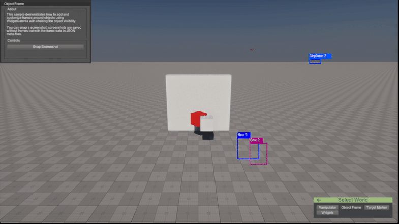

If you want to enable window viewport scaling and apply it to widgets, use DPI Awareness Level 1 (System Aware) or DPI Awareness Level 2 (Per Monitor DPI Aware) and turn on Auto DPI Scaling. To do this, use the following launch arguments:
- -dpi_awareness 1 -auto_dpi_scaling 1
- -dpi_awareness 2 -auto_dpi_scaling 1
After this, the values in units and pixels may be different. Now you need to remember about these two different measurements, and choose one for calculations. Most of the methods work with units, and the sizes in pixels are only in getters.
AppSystemLogic.cppivec2 pixels_position(256, 128); // pixels widget->setPosition(pixels_position.x, pixels_position.y); // wrong, pixels -> units ivec2 units_position = widget->toUnitSize(pixels_position); widget->setPosition(units_position.x, units_position.y); // correct, units -> units // widget widget->setPosition(0, 0); // units widget->setPositionX(0); // units widget->setPositionY(0); // units widget->setWidth(0); // units widget->getWidth(); // units widget->getRenderWidth(); // pixels widget->setHeight(0); // units widget->getHeight(); // units widget->getRenderHeight(); // pixels widget->toRenderSize(ivec2()); // units to pixels widget->toUnitSize(ivec2()); // pixels to units

Why is my scene or GUI unexpectedly scaled (larger/smaller), misaligned, or triggering scroll in the wrong areas?
If your application's interface appears improperly scaled or misbehaves visually, consider the following common causes:
Incorrect DPI awareness level: If the application is DPI unaware, the OS may bitmap-scale it, resulting in blurriness or incorrect proportions.
Solution: Enable Level 1 (System Aware) or Level 2 (Per Monitor DPI Aware) DPI awareness levels.
Auto DPI Scaling is disabled: With auto_dpi_scaling set to 0, widgets won't automatically scale with the system DPI.
Solution: Enable Auto DPI Scaling (auto_dpi_scaling 1) unless you plan to scale manually.
Wrong unit conversion: Using physical pixel values instead of logical units can make widgets appear too small on high-DPI screens and cause input misalignment (e.g., mouse clicks landing or scrolling trigger in the wrong place).
Solution: Use UNIGINE's built-in methods to convert between pixels and logical units.

The following example demonstrates how to create a debug overlay to detect coordinates misalignment:
AppSystemLogic.h#ifndef __APP_SYSTEM_LOGIC_H__ #define __APP_SYSTEM_LOGIC_H__ #include "UnigineLogic.h" #include "UnigineWidgets.h" class AppSystemLogic : public Unigine::SystemLogic { public: int init() override; int update() override; private: Unigine::WidgetLabelPtr info_label; Unigine::WidgetLabelPtr mouse_info_label; Unigine::WidgetButtonPtr button; Unigine::WidgetCanvasPtr info_canvas; int polygon_client_window{-1}; int polygon_button{-1}; int polygon_mouse{-1}; int text_button{-1}; Unigine::Math::vec4 polygon_button_color{0.5f, 1.0f, 0.5f, 0.3f}; Unigine::EventConnections connections; }; #endif // __APP_SYSTEM_LOGIC_H__
AppSystemLogic.cpp#include "AppSystemLogic.h" using namespace Unigine; using namespace Unigine::Math; int AppSystemLogic::init() { info_canvas = WidgetCanvas::create(); polygon_client_window = info_canvas->addPolygon(); polygon_button = info_canvas->addPolygon(); text_button = info_canvas->addText(); polygon_mouse = info_canvas->addPolygon(); info_canvas->setTextText(text_button, "Button"); info_canvas->setTextSize(text_button, 60); WindowManager::getMainWindow()->addChild(info_canvas, Gui::ALIGN_LEFT | Gui::ALIGN_OVERLAP | Gui::ALIGN_BACKGROUND); info_label = WidgetLabel::create(); info_label->setFontSize(16); info_label->setFontOutline(1); WindowManager::getMainWindow()->addChild(info_label, Gui::ALIGN_LEFT | Gui::ALIGN_OVERLAP); mouse_info_label = WidgetLabel::create(); mouse_info_label->setFontSize(16); mouse_info_label->setFontOutline(1); WindowManager::getMainWindow()->addChild(mouse_info_label, Gui::ALIGN_OVERLAP); button = WidgetButton::create("Button"); button->setFontSize(60); button->setFontOutline(1); WindowManager::getMainWindow()->addChild(button, Gui::ALIGN_CENTER); button->getEventPressed().connect(connections, [this]() { polygon_button_color = vec4(0.0f, 1.0f, 0.0f, 0.3f); }); button->getEventReleased().connect(connections, [this]() { polygon_button_color = vec4(0.5f, 1.0f, 0.5f, 0.3f); }); Input::setMouseHandle(Input::MOUSE_HANDLE_USER); return 1; } int AppSystemLogic::update() { String info; auto print_dpi_awareness = [&info](const char *title, WindowManager::DPI_AWARENESS awareness) { info += String::format("\t%s: ", title); switch (awareness) { case WindowManager::DPI_AWARENESS_CUSTOM: info += "Custom"; break; case WindowManager::DPI_AWARENESS_UNAWARE: info += "Unaware"; break; case WindowManager::DPI_AWARENESS_SYSTEM_AWARE: info += "System Aware"; break; case WindowManager::DPI_AWARENESS_PER_MONITOR_AWARE: info += "Per Monitor Aware"; break; } info += "\n"; }; auto print_int = [&info](const char *title, int value) { info += String::format("\t%s: %d\n", title, value); }; auto print_float = [&info](const char *title, float value) { info += String::format("\t%s: %f\n", title, value); }; auto print_ivec2 = [&info](const char *title, const ivec2 &value, const char *measure) { info += String::format("\t%s: %d x %d %s\n", title, value.x, value.y, measure); }; auto print_units_and_pixels = [&info](const char *title, const ivec2 &units, const ivec2 &pixels) { info += String::format("\t%s: %d x %d units, %d x %d pixels\n", title, units.x, units.y, pixels.x, pixels.y); }; // window manager info += "Window Manager:\n"; info += String::format("\tAuto Dpi Scaling: %s\n", WindowManager::isAutoDpiScaling() ? "true" : "false"); print_dpi_awareness("Dpi Awareness", WindowManager::getDpiAwareness()); print_dpi_awareness("Current Dpi Awareness", WindowManager::getCurrentDpiAwareness()); info += "\n"; // window info += "Window:\n"; EngineWindowPtr window = WindowManager::getMainWindow(); print_int("Display Index", window->getDisplayIndex()); print_int("Dpi", window->getDpi()); print_float("Dpi Scale", window->getDpiScale()); print_units_and_pixels("Size", window->getSize(), window->getRenderSize()); print_units_and_pixels("Client Size", window->getClientSize(), window->getClientRenderSize()); print_ivec2("Position", window->getPosition(), "pixels"); print_ivec2("Client Position", window->getClientPosition(), "pixels"); info += "\n"; // gui info += "Gui:\n"; GuiPtr gui = window->getSelfGui(); print_float("Dpi Scale", gui->getDpiScale()); ivec2 unit_gui_size = gui->getSize(); ivec2 pixel_gui_size(gui->toRenderSize(unit_gui_size.x), gui->toRenderSize(unit_gui_size.y)); print_units_and_pixels("Size", unit_gui_size, pixel_gui_size); print_ivec2("Position", gui->getPosition(), "pixels"); ivec2 unit_gui_mouse_position(gui->getMouseX(), gui->getMouseY()); ivec2 pixel_gui_mouse_position(gui->toRenderSize(unit_gui_mouse_position.x), gui->toRenderSize(unit_gui_mouse_position.y)); print_units_and_pixels("Mouse Position", unit_gui_mouse_position, pixel_gui_mouse_position); info += "\n"; // button info += "Button:\n"; print_float("Dpi Scale", button->getDpiScale()); ivec2 unit_button_size(button->getWidth(), button->getHeight()); ivec2 pixel_button_size(button->toRenderSize(unit_button_size)); print_units_and_pixels("Size", unit_button_size, pixel_button_size); ivec2 unit_button_position(button->getPositionX(), button->getPositionY()); ivec2 pixel_button_position(button->toRenderSize(unit_button_position)); print_units_and_pixels("Position", unit_button_position, pixel_button_position); info += "\n"; info_label->setText(info); // mouse info String mouse_info = "\n"; ivec2 global_mouse_position = Input::getMousePosition(); ivec2 unit_local_mouse_position = window->globalToLocalUnitPosition(global_mouse_position); ivec2 pixel_local_mouse_position = global_mouse_position - window->getClientPosition(); mouse_info += String::format("Global Position: %d x %d pixels\n", global_mouse_position.x, global_mouse_position.y); mouse_info += String::format("Client Local Position: %d x %d units, %d x %d pixels\n", unit_local_mouse_position.x, unit_local_mouse_position.y, pixel_local_mouse_position.x, pixel_local_mouse_position.y); mouse_info_label->setText(mouse_info); mouse_info_label->setPositionX(unit_local_mouse_position.x); mouse_info_label->setPositionY(unit_local_mouse_position.y); // canvas info_canvas->setPosition(0, 0); info_canvas->setWidth(unit_gui_size.x); info_canvas->setHeight(unit_gui_size.y); const float line_size = 3.0f; const float dpi_scale = window->getDpiScale(); auto update_polygon = [this, dpi_scale](int id, const vec2 p0, const vec2 p1, const vec2 p2, const vec2 p3, const vec4 &color) { info_canvas->clearPolygonPoints(id); info_canvas->clearPolygonIndices(id); info_canvas->addPolygonPoint(id, vec3(p0.x, p0.y, 0.0f) / dpi_scale); info_canvas->addPolygonPoint(id, vec3(p1.x, p1.y, 0.0f) / dpi_scale); info_canvas->addPolygonPoint(id, vec3(p2.x, p2.y, 0.0f) / dpi_scale); info_canvas->addPolygonPoint(id, vec3(p3.x, p3.y, 0.0f) / dpi_scale); info_canvas->setPolygonColor(id, color); }; // client window update_polygon(polygon_client_window, vec2(0.0f, 0.0f), vec2(0.0f, itof(unit_gui_size.y)), vec2(itof(unit_gui_size.x), itof(unit_gui_size.y)), vec2(itof(unit_gui_size.x), 0.0f), vec4(0.0f, 0.0f, 1.0f, 0.3f) ); // button update_polygon(polygon_button, vec2(itof(unit_button_position.x), itof(unit_button_position.y)), vec2(itof(unit_button_position.x), itof(unit_button_position.y + unit_button_size.y)), vec2(itof(unit_button_position.x + unit_button_size.x), itof(unit_button_position.y + unit_button_size.y)), vec2(itof(unit_button_position.x + unit_button_size.x), itof(unit_button_position.y)), polygon_button_color ); info_canvas->setTextColor(text_button, vec4(0.0f, 1.0f, 0.0f, 0.5f)); info_canvas->setTextSize(text_button, ftoi(60 / dpi_scale)); info_canvas->setTextPosition(text_button, (vec2(unit_button_position) + vec2(34.0f, -10.0f)) / dpi_scale); // mouse update_polygon(polygon_mouse, vec2(unit_local_mouse_position) + vec2(-5.0f, -5.0f), vec2(unit_local_mouse_position) + vec2(-5.0f, +5.0f), vec2(unit_local_mouse_position) + vec2(+5.0f, +5.0f), vec2(unit_local_mouse_position) + vec2(+5.0f, -5.0f), vec4(1.0f, 0.0f, 0.0f, 1.0f) ); return 1; }
Coordinate misalignment caused by mixing pixel and logical units without proper DPI scaling.
