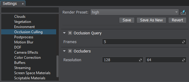

Occlusion culling settings
Occlusion Culling SettingsПараметры отсечения окклюзии
Occlusion Query value indicating if additional hardware occlusion query test before sending data to GPU is enabled. This test is performed for all objects with the Culled by occlusion query flag set. вкл. по умолчанию.
Консольная команда: render_occlusion_queries (API)
Frames number of frames for additional hardware occlusion query test performed before sending data to GPU. Make sure that the additional hardware occlusion query test (см. OcclusionQueries) is enabled.
Диапазон значений: [0, 1024]. Значение по умолчанию : 5.
Консольная команда: render_occlusion_queries_num_frames (API)
Occluders
Occluders#
Occluders value indicating if rendering of occluders is enabled. вкл. по умолчанию.
Консольная команда: render_occluders (API)
Resolution resolution of the texture, to which occluders (см. Occluders) are rendered.
From 1x1 to 1024x1024 Default: 128x64
Консольная команда: render_occluders_resolution (API)
