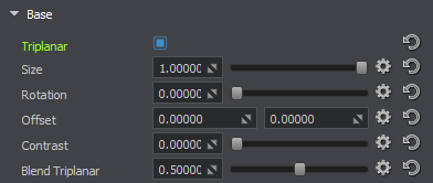

Base#
Base Parameters
Base parameters.
Triplanar Triplanar texture mapping for the detail.
Size Texture tile size.
Rotation Rotation of the detail's textures around the Z axis, in degrees.
Offset Offset of the detail's textures along the X and Y axes, in units.
Contrast Sharp or smooth transition of the detail with other details.
Blend Triplanar The value of blending between triplanar texture projections (available only when the Triplanar mapping for the detail is enabled).

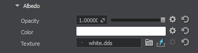

Albedo#
Albedo Parameters
Albedo parameters
Opacity Albedo opacity.
Color Color multiplier for the albedo texture.
Texture Texture used to specify the color information (how the detail looks like).

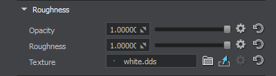

Roughness#
Roughness Parameters
Roughness parameters
Opacity Opacity of the roughness effect.
Roughness Roughness multiplier for the roughness texture.
Texture Roughness texture of the detail.

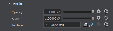

Height#
Height Parameters
Height parameters
Opacity Opacity of the height texture.
Scale
Displacement height of the detail.
  • Maximum possible value is 1.0, but it is not recommended to set it higher than 0.2;
  • Detail displacement is clamped to Detail Max Height but normals are preserved.
Texture Texture used to specify the height of the detail (for rocks, pits, etc.).

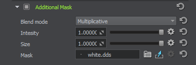

Additional Mask#
Additional Mask Parameters
Additional mask parameters

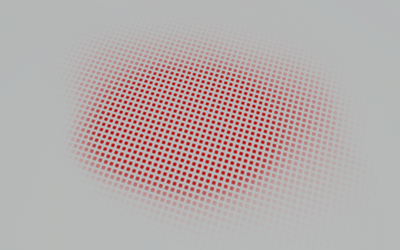

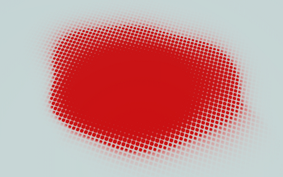

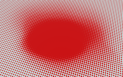

Blend Mode
Blending mode between the additional detail mask and the corresponding mask of a landscape layer map.
Mask of a landscape layer map
Additional detail mask

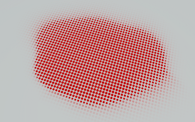

As an example, for two masks presented above (Albedo color is set to red color) the available blending modes provide the following results:
  • Multiplicative — the base mask color is multiplied by the additional detail mask color, resulting in darker colors.
  • Overlay — the base and additional detail mask colors are multiplied for dark color pixels and screened for light color pixels, which leads to the contrast increase while preserving highlights and shadows. Grey pixels are not effected at all.
  • Additive — the additional detail mask color is added to the base mask color.
  • Vivid Light — the additional detail mask colors are darkened for dark color pixels and lightened for light color pixels, which leads to preserving mask details on semi-transparent pixels.
Intensity Mask intensity.
Size Tile size.
Mask Additional mask texture (only red channel is taken into account).
