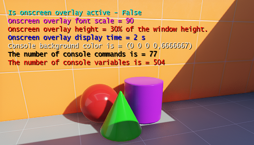

Onscreen Console Overlay#
By default the console overlay is disabled. To make it output console messages to the application screen it should be enabled. You can adjust the overlay’s behavior and appearance as well as specify the messages that will be printed exclusively to the onscreen overlay and will not be written to the console.
Onscreen Overlay with custom parameters and colored text
You can customize the console font by using the setFontSize(), setMessageColor(), setWarningColor(), and setErrorColor() methods. See the following example:
AppWorldLogic.cpp (C++)
#include "AppWorldLogic.h"
#include <UnigineConsole.h>
int AppWorldLogic::init()
	// enable the onscreen overlay
	Console::setOnscreen(true);
	// increase the size of the console's font
	Console::setFontSize(20);
	// change the color for different types of messages
	Console::setMessageColor(Unigine::Math::vec4_green);
	Console::setWarningColor(Unigine::Math::vec4_red);
	Console::setErrorColor(Unigine::Math::vec4_blue);
	// send messages to the console
	Log::message("Message!\n");
	Log::warning("Warning!\n");
	Log::error("Error!\n");
