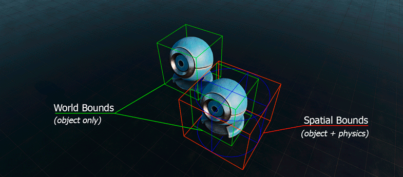

  • Local Bounds — bound objects with local coordinates which do not take into account physics and children. Obtained via the following methods of the Node class: getBoundBox() and getBoundSphere().
  • World Bounds — same as local ones, but with world coordinates. Obtained via the following methods of the Node class: getWorldBoundBox() and getWorldBoundSphere().
  • Spatial Bounds — bound objects with world coordinates used by the spatial tree, and therefore taking physics into account (shape bounds, etc.). Obtained via the following methods of the Node class: getSpatialBoundBox() and getSpatialBoundSphere().
Spatial bounds are calculated faster than World ones.
