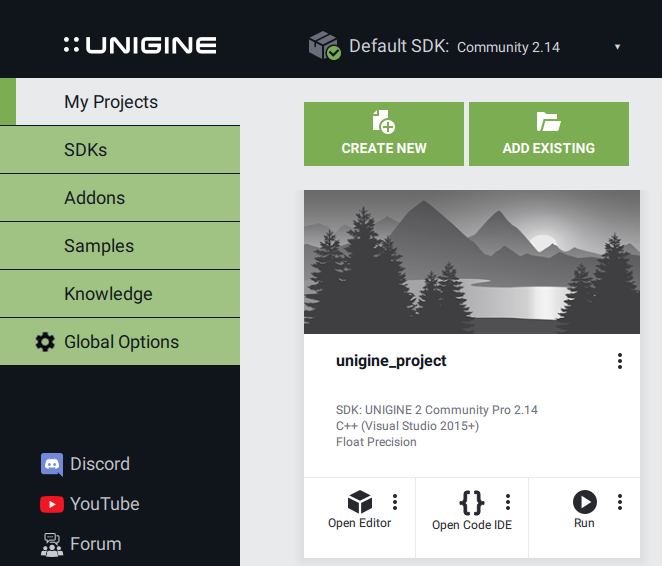

It is very easy to start your own C++ project by using UNIGINE SDK Browser:Начать собственный проект на C ++ с помощью UNIGINE SDK Browser очень просто:

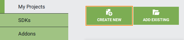

  1. Open the UNIGINE SDK Browser.Откройте браузер UNIGINE SDK.
  2. Go to the Projects tab and click CREATE NEW.
    Перейдите на вкладку Projects и нажмите CREATE NEW.

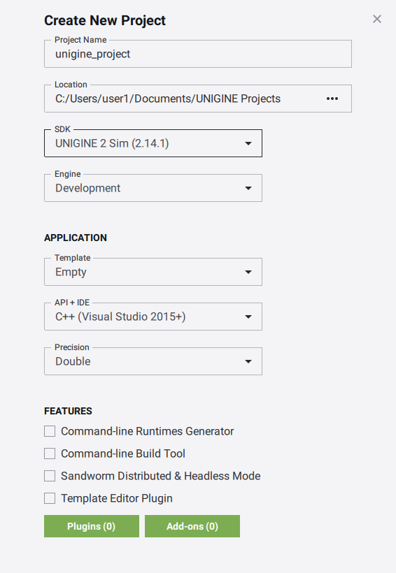

  3. Specify the following parameters:
    • Project name — specify the name of your project. Project name — specify the name of your project.
    • Location — specify the path to your project folder. Location — specify the path to your project folder.
    • SDK — choose the UNIGINE SDK edition. SDK — choose the UNIGINE SDK edition.
    • API+IDE — choose C++ to start working with the C++ API.
      This parameter depends on a platform:This parameter depends on a platform:
      • On Windows, you can create C++ Visual Studio 2022 project.On Windows, you can create C++ Visual Studio 2022 project.
      • On Linux you can create C++ GNU make project.On Linux you can create C++ GNU make project.
      You can also can create C++ CMake projectYou can also can create C++ CMake project
      This parameter depends on a platform:On Windows, you can create C++ Visual Studio 2022 project.On Linux you can create C++ GNU make project.You can also can create C++ CMake project
    • Precision - specify the precision. In this example we will use double precision.Precision - specify the precision. In this example we will use double precision.
    Read more about these parameters in this article Read more about these parameters in this article
    Project name — specify the name of your project. Location — specify the path to your project folder. SDK — choose the UNIGINE SDK edition. API+IDE — choose C++ to start working with the C++ API.
    This parameter depends on a platform:On Windows, you can create C++ Visual Studio 2022 project.On Linux you can create C++ GNU make project.You can also can create C++ CMake projectPrecision - specify the precision. In this example we will use double precision.Read more about these parameters in this article

  4. Click the CREATE NEW PROJECT button. The project will appear in the projects list.
    Щелкните кнопку CREATE NEW PROJECT. Проект появится в списке проектов.
You can run your project by clicking the Run button.Вы можете запустить свой проект, нажав кнопку Run.

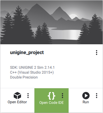

  1. If you created the C++ project for Visual Studio:Если вы создали проект C ++ для Visual Studio :
    1. Choose your C++ project in the UNIGINE SDK Browser and click the Open Code IDE button to open the project in IDE.
      Выберите свой проект C ++ в браузере UNIGINE SDK и нажмите кнопку Open Code IDE, чтобы открыть проект в IDE.

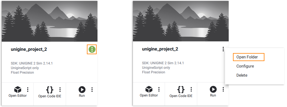

    If you created C++ GNU make project:Если вы создали C++ GNU make project:
    1. On the created C++ project, click on the Other Actions button and then the Open Folder button.
      В созданном проекте C ++ нажмите кнопку Other Actions, а затем кнопку Open Folder.

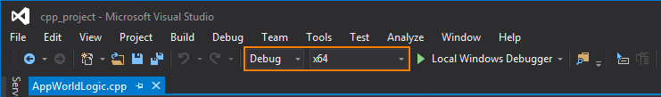

  3. If you use Visual Studio, do the following: Если вы используете Visual Studio, сделайте следующее:
    1. Before compiling your code, check that the appropriate platform and configuration settings for your project are set correctly.
      Перед компиляцией кода убедитесь, что для вашего проекта установлены правильные параметры платформы и конфигурации.

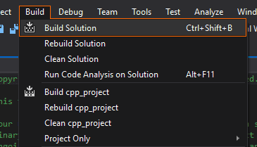

    2. Build your project by clicking Build -> Build Solution in Visual Studio.
      Создайте свой проект, щелкнув Build -> Build Solution в Visual Studio.

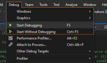

    3. Start your project by clicking Debug -> Start in a proper mode in Visual Studio.
      Начните свой проект, щелкнув Debug -> Start в соответствующем режиме в Visual Studio.
