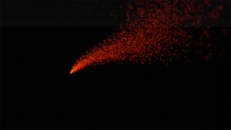

Usage Example#
In the following example, we create a new particle system, specify its settings by means of C++ API.
Prior Knowledge
It is supposed that you have already created an empty C++ project by using UNIGINE SDK Browser.
In the AppWorldLogic.h file, we define the following smart pointers:
  • ObjectParticlesPtr for a particle system
  • NodePtr for a world light source
// AppWorldLogic.h
#include <UnigineLogic.h>
#include <UnigineStreams.h>
#include <UnigineObjects.h>
	// define smart pointers to particles and sun nodes
	Unigine::ObjectParticlesPtr particles;
	Unigine::NodePtr sun;
In the AppWorldLogic.cpp file, we create a new particle system, specify its settings and disable the world light source called "sun" to make the particle system visually identifiable.
// AppWorldLogic.cpp
#include "AppWorldLogic.h"
#include "UnigineEditor.h"
#include "UnigineGame.h"
int AppWorldLogic::init() {
	particles = ObjectParticles::create();
	// set world transform to the particle system, specify its material and material diffuse parameter
	particles->setWorldTransform(Mat4(quat(0.0f, 0.0f, 0.0f, 0.0f)));
	particles->setMaterial("particles_base", "*");
	particles->setMaterialParameter("diffuse_color", vec4(0.5f, 0.1f, 0.0f, 1.0f), 0);
	// enable the emitter and specify its setttings
	particles->setEmitterEnabled(1);
	particles->setSpawnRate(2000.0f);
	particles->setLife(5.0f, 0.5f);
	particles->setRadius(0.2f, 0.1f);
	particles->setGrowth(0.1f, 0.1f);
	particles->setVelocity(3.0f, 2.0f);
	particles->setGravity(vec3(0.0f, 0.0f, 4.0f));
	// disable the sun node
	sun = Editor::get()->getNodeByName("sun");
	sun->setEnabled(0);
int AppWorldLogic::update() {
	// set transformation for particle system
	float time = Game::get()->getTime();
	particles->setWorldTransform(Mat4(rotateZ(time * 64.0f) * translate(15.0f, 0.0f, 0.0f)));
int AppWorldLogic::shutdown() {
	// clear the pointer to particles
	// you don't need to clear the pointer to the sun node because Editor is the owner
	particles.clear();
If you launch the application, you get the following particle system:
