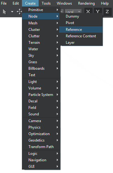

There are two ways to create a Node Reference via UnigineEditor:
  • Add a new Node Reference that refers to an external .node file. In this case, you should export a node into a .node file first.
    On the Menu bar, click Create -> Node -> Reference.

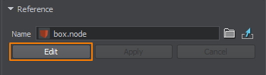

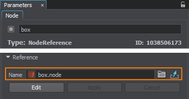

Editing a Node Reference#
In the Reference section of the Node tab, you can change the asset of the source node or open the ReferenceNode Editor used to edit the source node:
A node asset
To edit the source node, to which the Node Reference points:
  1. Select the Node Reference in the World Hierarchy window.
  2. Click Edit in the Node tab of the Parameters window.
    The source node becomes available in the World Hierarchy window as a child of the Node Reference and can be edited via the Parameters window.
    World Hierarchy window: source node in the edit mode
  3. Edit the source node. For example, you can change the material applied to it:
    Node references with the red material applied
    Node references with the changed material
  4. After all changes are made, select the parent node in the World Hierarchy window and click Apply to save changes to the source node or Cancel changes to keep nodes unchanged.
