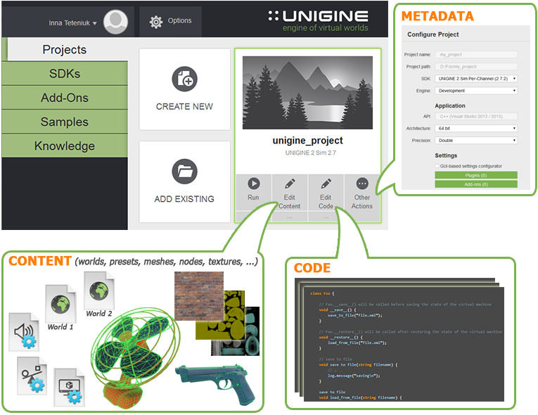

Project#
When you create an application in UNIGINE, it is represented by a project. A project is a "container" for the application's code, content, and meta-data.
A project can consist of one or several complex 3D scenes, which are called worlds.
All projects are managed via the UNIGINE SDK browser.

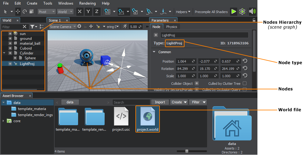

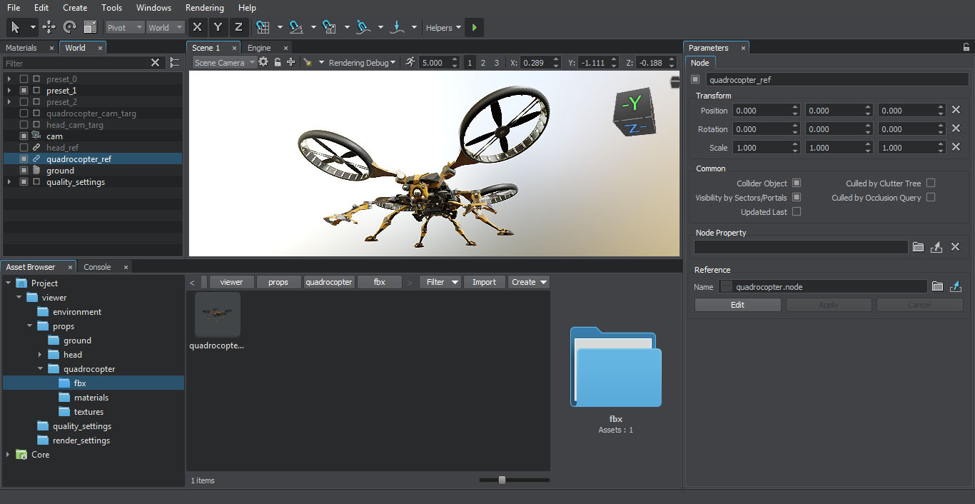

To edit your existing worlds and create new ones use the UnigineEditor. You can create and use as many worlds as you need.
A world with nodes in it viewed in UnigineEditor

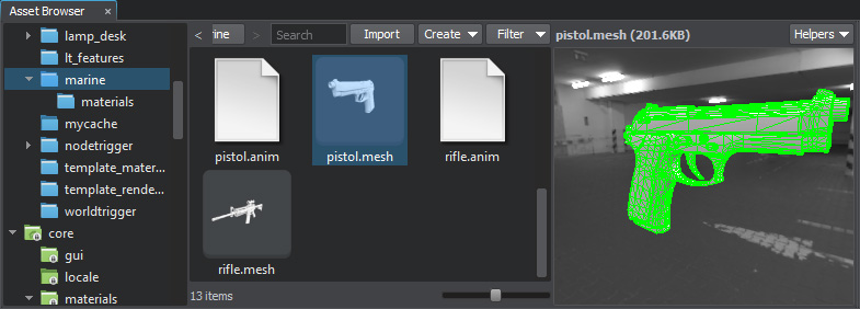

At run time, meshes are stored in proprietary UNIGINE formats with .mesh (static mesh + optional animation data) and .anim (external animation data) extensions.
When importing an FBX model to the Engine, it is automatically converted to the .mesh format.

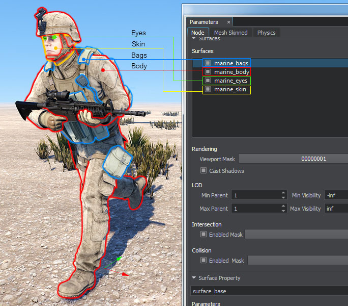

Surface#
A surface is a named non-overlapping subset of the object geometry (i.e. object mesh). Each surface can have its own material or property assigned. It is also possible to enable/disable surfaces independently from each other.
Surfaces can be organized in a hierarchy within a mesh (it can be used for LOD switching).
At the picture below, a soldier 3D mesh consists of 4 surfaces: eyes, skin, bags (body armor, radio set, bag), and body (overalls, shoes, hard hat, gloves).

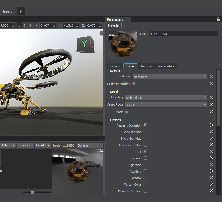

Material#
In terms of UNIGINE, a material is a rule defining how the surface will look like: its interaction with lights, reflection parameters, etc. It is based on:
  • Vertex, fragment and geometry shaders that actually draw the material based on different conditions.
  • User-defined textures passed to shaders.
  • States that specify conditions, basing on which the appropriate shaders will be applied.
  • Parameters defining how shaders will be used.
UNIGINE provides a rich set of built-in base materials out of the box. The recommended way is to inherit a new user material from a base one and tweak it. You can also create custom shaders either using UUSL (Unified UNIGINE Shader Language) or HLSL/GLSL, but in the latter case you would need to migrate your custom shaders with every SDK release by yourself.
In addition to regular materials applied to certain surfaces, there is a special type of materials called post materials, that are applied above the final screen composition (e.g. to create a night or thermal vision effect). You can also create your own post-effects with your custom post-materials and custom shaders.

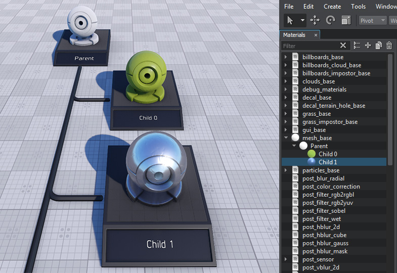

Material Hierarchy#
Materials are organized in hierarchy with parameters inheritance and overloading (much like in object-oriented programming). When a material is inherited, all its parameters are inherited from the parent. If a parameter value is changed for the parent, it will be automatically changed for the child as well, unless it was overridden (set to a different value) for the child before that.
Example: a material A has two parameters (color: blue and specular power of 1.4), a material B is inherited from the material A and has color parameter overridden (red). If we change specular power to 2.0 in the material A, then the material B will have the following parameters: red color (overridden) and 2.0 value of specular power (inherited).
By using parameter inheritance it is very convenient to mass control values of multiple materials parameters.

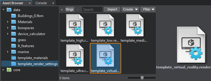

Every piece of content, that can be used in your world or project, is an asset. An asset may come from a file created using a third-party application, such as a 3D model, an audio file, an image, or any other type supported by the UNIGINE Engine.
The main front-end tool of the Asset System is the Asset Browser in the UnigineEditor. It is used to organize content in your project: create, import, view, rename your assets, move them between the folders and manage their hierarchy.
Each time an asset is created or imported, the UnigineEditor does all necessary job, including conversion of your assets (be it a JPG texture or and FBX model) to its native format (such as compressed .dds textures, .mesh geometry, .anim animations, etc.) to be used by the Engine at run time. Such files, generated as a result of conversion, are called "run-time files", and they are updated by the UnigineEditor each time you modify the corresponding asset.
It is recommended that you familiarize yourself with the Assets Workflow to learn all the details.

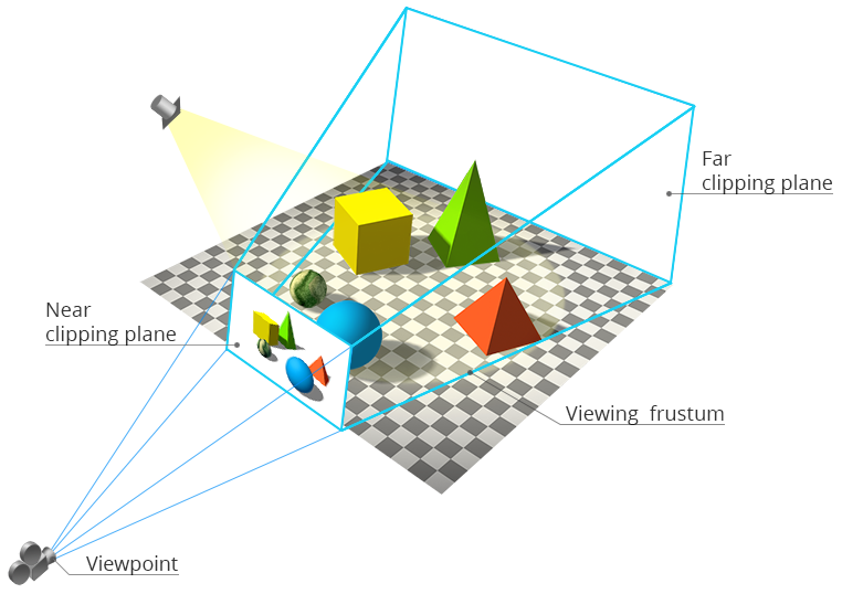

For visual representation, UNIGINE uses a standard perspective projection. The orthogonal projection is also available.
Perspective projection
In UNIGINE, the way how the world is seen is based on the 3 entities:
  • A camera is a structure containing 2 matrices: view and projection. Through this structure, you set the camera parameters: field of view, masks, near and far clipping planes, and post materials. Then, the camera is passed to a Viewport that will render an image from this camera. The camera is assigned to a Player, that will further control its position.

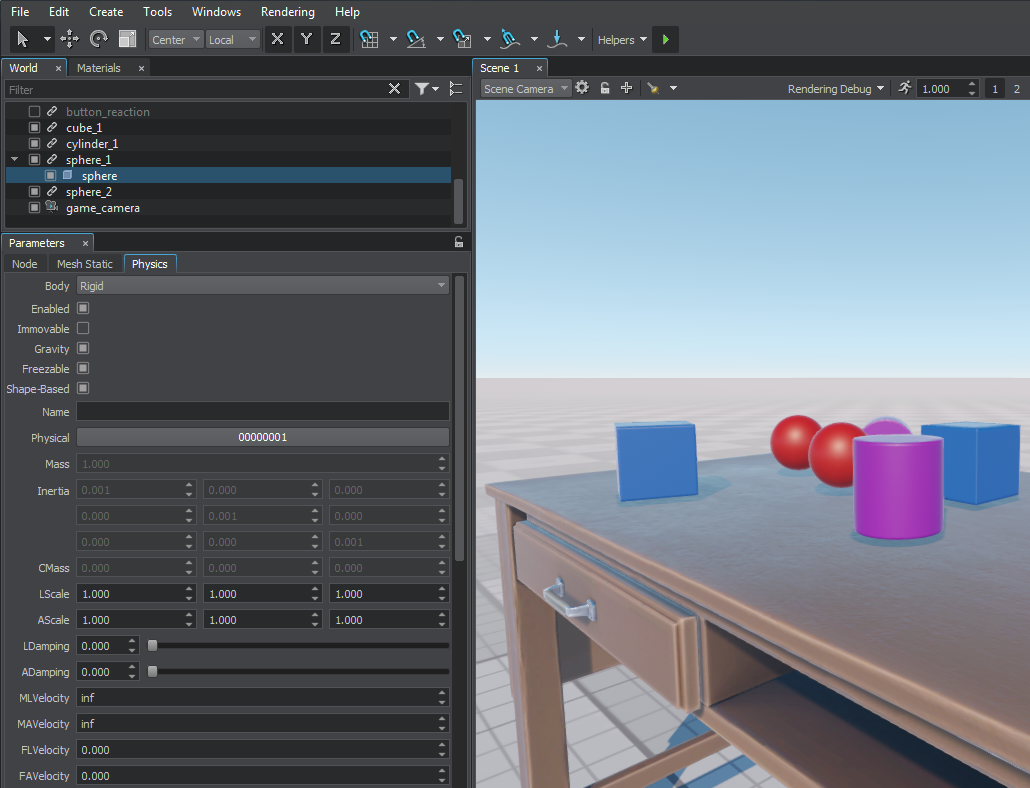

Body#
To assign some physical properties to an object, so that it could participate in interactions between objects or external physical forces, it should have a body. There are several types of bodies: Rigid, Rag Doll, Fracture, Rope, Cloth, Water, Path.
Almost like in the real world, virtual physics of the body follows the concepts of velocity, force, mass, density and so on.
Shape#
While a body simulates various types of physical behavior, a shape represents the volume (sphere, capsule, cylinder, box, convex hull) that a rigid body occupies in space. A physically simulated object usually has a single body and one or several shapes which allow objects to collide with each other.

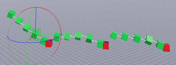

Joint#
Joints are used to connect several objects with respect to the mass balance and represent constraints removing certain degrees of freedom. There are different types of joints: Fixed, Hinge, Ball, Prismatic, Cylindrical, Suspension.

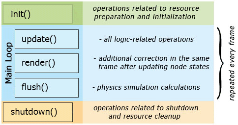

Run-Time Logic#
Every UNIGINE-based application has its life cycle, that consists of certain stages, some of them are performed once, others are repeated each frame. In short, these stages are as follows:
UNIGINE has three main logic components, Each of them has a set of functions (named init(), update(), render(), etc.) that contain actions to be performed at corresponding stages of the Engine's working cycle. These components are:
  • System Logic is the code that is run during the whole application life cycle (its scope exists even when switching worlds).
    • For applications written using UnigineScript, the system logic is written to the system script file (unigine.usc).
    • For C++ or C# applications, AppSystemLogic.cpp is created in the source folder of your project. It has implemented methods to put your logic code inside.
  • World Logic is the logic of the virtual world. The logic takes effect only when the world is loaded.
    • For applications written using UnigineScript, the world logic is written to the world script file (*.usc named after your project) and is loaded and unloaded together with the corresponding world.
    • For C++ or C# applications, AppWorldLogic.cpp is created in the source folder of your project and stays loaded during the whole engine runtime. It has implemented methods to put your logic code inside.
  • Editor Logic is the logic of the Editor. The logic takes effect only when the UnigineEditor is loaded.
    • You should create an editor logic file to put your logic code inside and add it using the command-line argument.
It is highly recommended that you familiarize yourself with the execution sequence to know the details, including the multi-threaded mode.

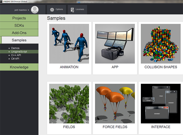

Samples and Demos#
UNIGINE provides a rich set of built-in samples and demo projects covering basic principles of working with the Engine (operations with the built-in nodes, output rendering, GUI setting, etc.). There are different samples for each of the 3 programming languages. All samples come with the full source code. To check them out, go to SDK browser -> Samples tab.
An extended set of content samples is also included for your convenience to illustrate various aspects of working with content: you can learn how to use UNIGINE's built-in objects with different settings, set up LODs and materials, adjust rendering settings, or work with vegetation. These content samples are available via UNIGINE SDK Browser as a demo: go to Samples -> Demos and install the Samples demo.

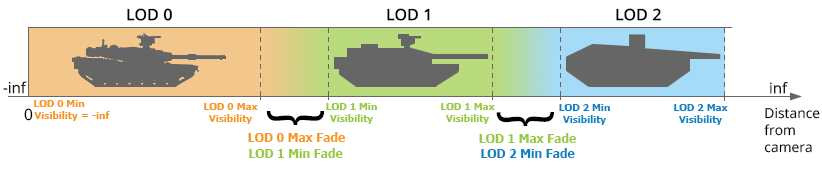

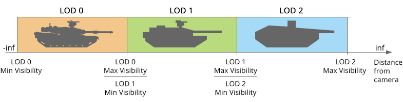

LODs#
Smooth alpha-blended levels of details (LODs) are used to decrease geometry complexity of 3D objects, when these objects move away from the camera, making it possible to lighten the load on the renderer.
Usually, LODs are used for:
  • Switching high-polygonal surfaces of the mesh to low-polygonal ones.
  • Switching surfaces with complex materials to surfaces with simplified optimized ones.
  • Switching several high-polygonal surfaces to a single simplified surface.
  • Switching one node type to the other (for example, switching a high-polygonal mesh to a billboard, a two-polygonal object that always faces the camera)
Switching between LODs can depend not only on the distance from the camera, but also from the distance from the certain object.
UNIGINE offers two mechanisms of LODs switching:
  • Disable one LOD and enable another at the specified distance defined by two values: maximum visibility distance of the first LOD (Max Visibility) and minimum visibility distance of the second LOD (Min Visibility).
  • Smoothly fade one LOD into another at the specified interval defined by two values: minimum fade distance of the first LOD (Min Fade) and maximum fade distance of the first LOD/minimum fade distance of the second LOD (Max Fade).
See the Setting up object LODs article for the details.

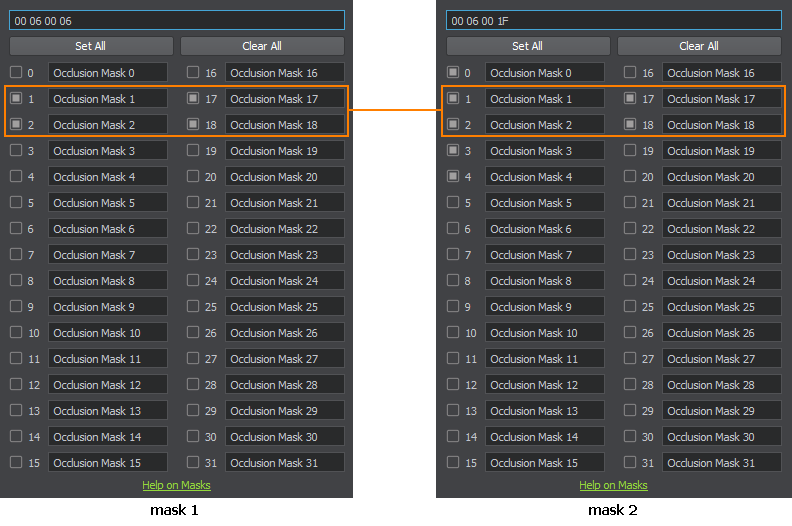

Bit masking defines whether two entities affect each other or not. It can be used to:
The bit masking algorithm compares 32-bit masks of each of two nodes using binary operator and. If masks match, one object will influence another object; if they don't, the objects won't interact.
If two masks have at least one matching bit, the masks match. E.g. the following two masks match, as they have 4 matching bits:
