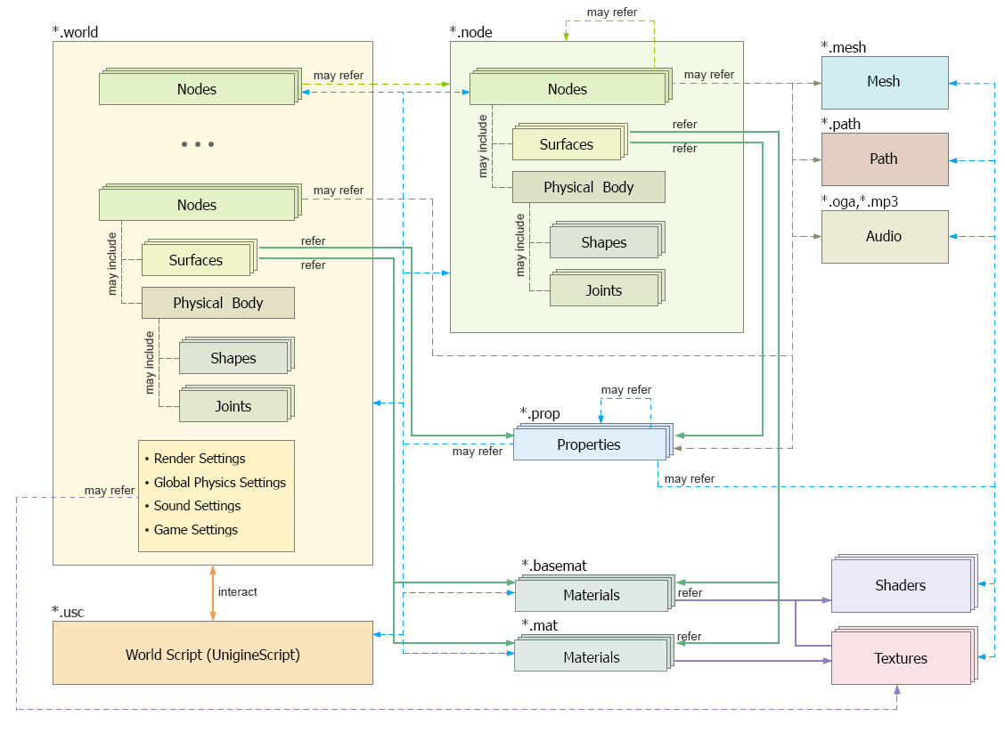

In general, the world and the world script can interact bilaterally: via the world script you can affect the world by using data received from this world. However, there may be the following cases:
  • A world script has no implementation. In this case, the world content is created and managed via UnigineEditor.
  • A .world file is empty. In this case, the world content is generated and managed via the world script.

Taking into account the information given above, the scheme of world's components can be extended as follows:
Interaction of the Main Components of the World

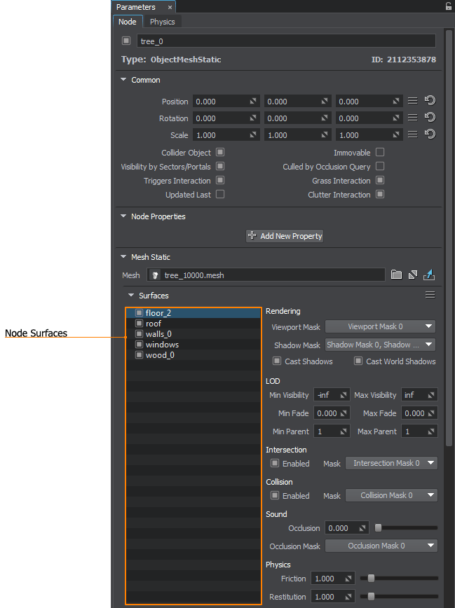

As it was mentioned above, nodes of object-related types can have surfaces. By default, such a node added via UnigineEditor has 1 surface.
Surfaces
Surfaces
The number of surfaces depends on how a mesh was imported into UNIGINE and cannot be changed dynamically at run time. However, you can reimport it via UnigineEditor when necessary. Each surface may add a separate DIP call to the GPU.

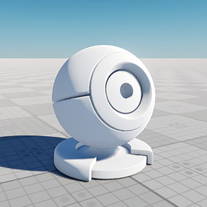

Material Ball with No Material Assigned

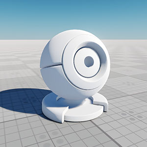

Material Ball with mesh_base Material Assigned

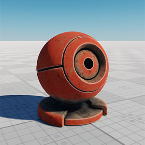

Material Ball with a User Material Inherited from mesh_base
The left material ball is rendered using one of the built-in base materials. The right material ball inherits its material from that base and simply changes 2 textures (the albedo and normal textures). There is no need to set other properties, as they are inherited. However, if necessary, you may change any property, just like we've changed the texture for the material ball.

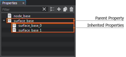

Properties in UNIGINE, just like materials, are organized in their own independent hierarchy. This hierarchy is formed by inheriting one property from another. A parent property passes all its parameters to its children so that they can be overridden, much like in object-oriented programming.
All inherited and non-overridden parameters will be updated automatically, if they are updated in the parent property.
Hierarchy of Properties
