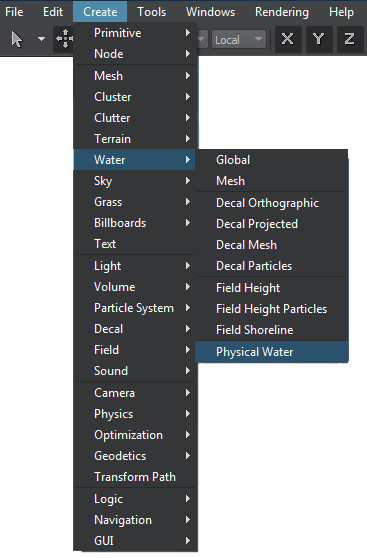

To add a physical water to the scene via UnigineEditor:
  2. On the Menu bar, click Create -> Water -> Physical Water.

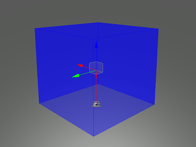

  3. Click somewhere in the world to place the physical water.
The new physical water node will be added to UnigineEditor and you will be able to edit it via the Parameters window. By default, the size of the node is 1×1×1 unit.

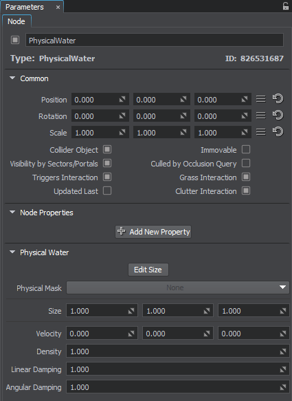

In the Physical Water section (Parameters window -> Node tab), you can adjust the following parameters of the physical water:

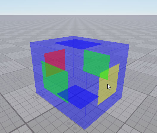

Edit Size Toggles the editing mode for the physical water node. When enabled, the physical water box sides that can be resized are highlighted with the colored rectangles. To change the size of a side, drag the corresponding rectangle.
Physical Mask Physical mask. The physical mask of the physical water must match the physical mask of the physical object. Otherwise, the physical water won't affect the object.
Size Size of the physical water box along the axes in units.
Velocity Velocity of the flow in the physical water along the axes.
Density Density of the physical water. It determines buoyancy of objects that float in the physical water. The higher the value, the higher buoyancy of the object. The lower the water density, the deeper the object submerges into water.
The density and the mass of the physical body also affect buoyancy of the object.
Physical Water density = 10
Physical Water density = 25
Linear Damping Value indicating how much the linear velocity of the objects decreases when they get into the physical water. The higher the value is, the lower the linear velocity will be.
Angular Damping Value indicating how much the angular velocity of the objects decreases when they get into the physical water. The higher the value is, the lower the angular velocity will be.
