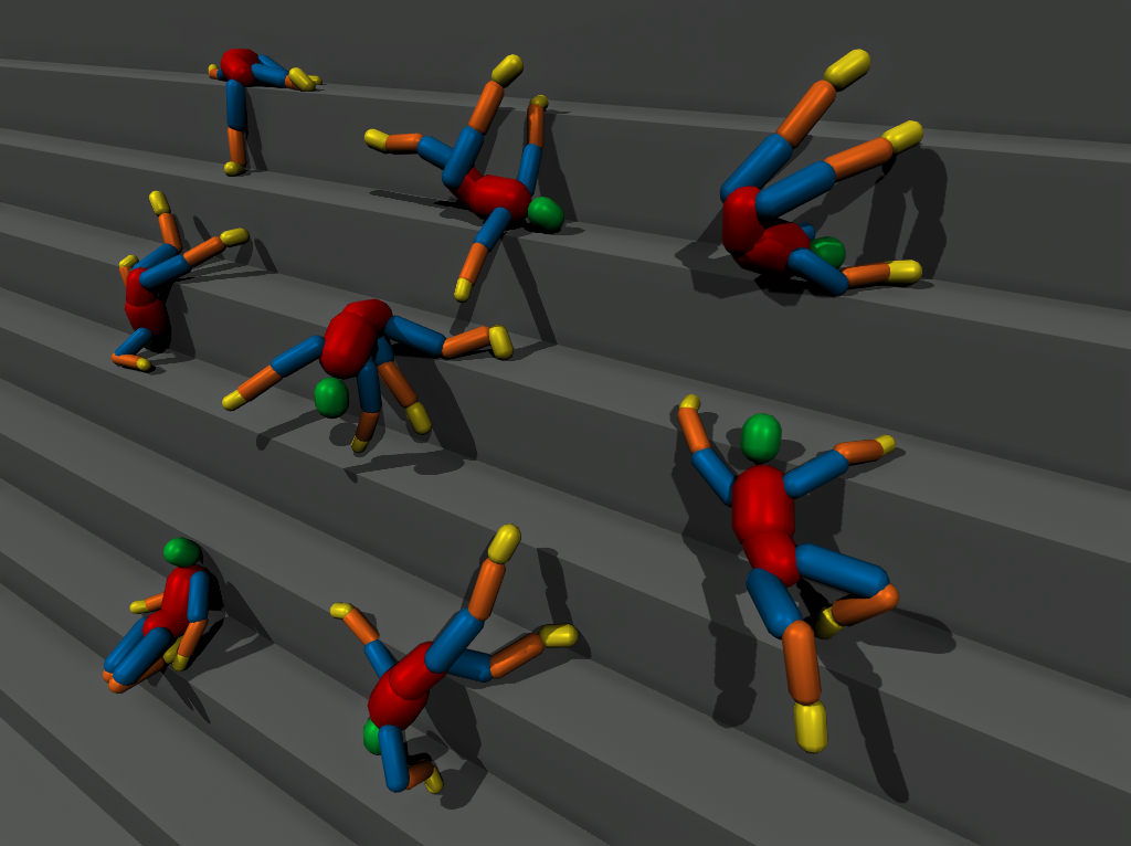

Ragdoll body enables inverse kinematics and procedural animation of a death sequence for bone-animated characters. This type of body is actually a set of rigid bodies representing each bone of a character linked together by joints. These joints restrict movement of the bones relative to each other, providing realistic look.

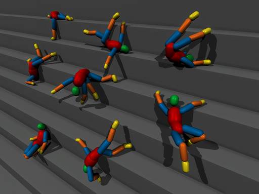

Ragdoll animation
Ragdoll animation

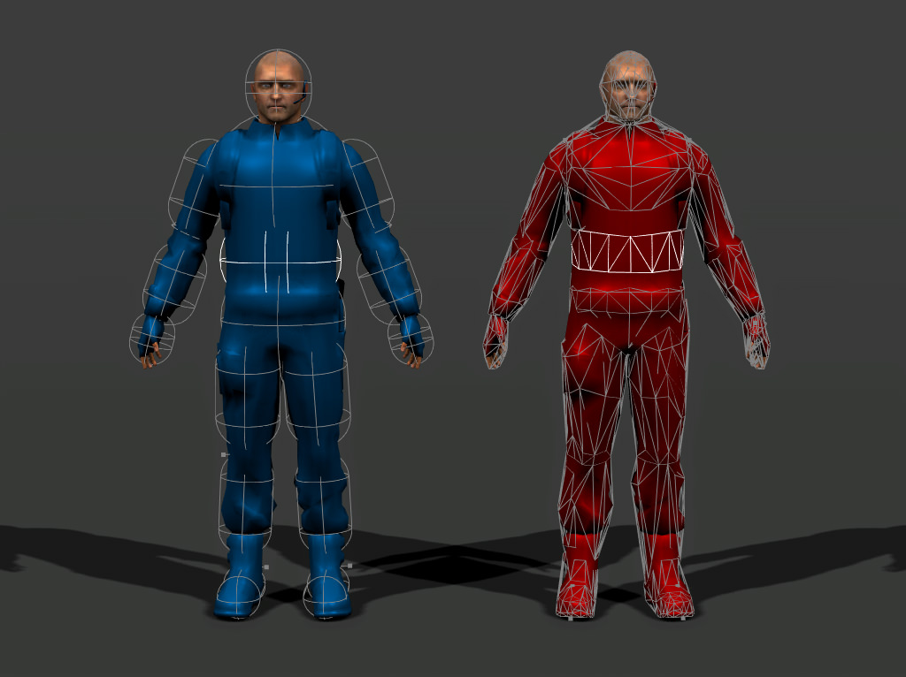

Approximation Shape#

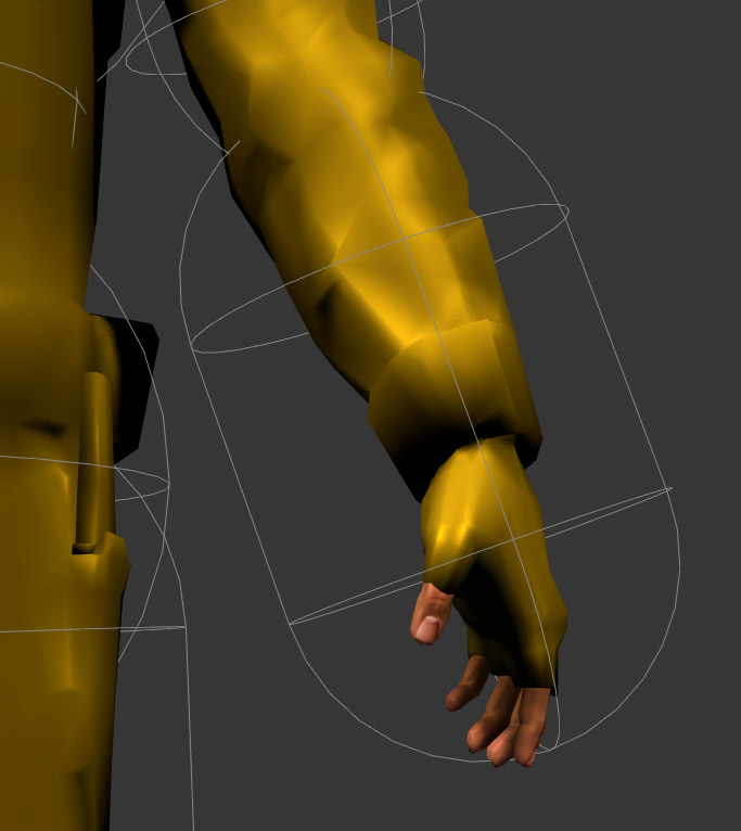

Bones can be approximated either with Convex hulls or Capsules, if Capsule shape box is checked:
  • Capsules provide very fast physics simulation and continuous collision detection.
  • Convex hulls provide more accurate approximation.
If any other shape is required, approximation is to be done manually.

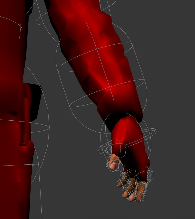

Approximation with capsules and convex hulls
Remember, physical shapes need not reproduce the mesh precisely. Rough approximation provides physical interaction that is realistic and convincing enough.

When creating a ragdoll, small bones (like finger bones, for example) are rarely simulated. They are too insignificant to change the motion of the whole object, as their mass and volume is not sufficient for that. Volume threshold allows to merge all small adjacent bones, the volume of which is too small, into one shape:
  • By the minimum value of 0, all the bones without exception are represented in rigid bodies and hence shapes.
  • By the maximum value of 1, approximation shapes are big and follow only the major bones. Small bones are included in this volume, but their individual transformations are not considered in physical simulation.
Minimum volume threshold     Maximum volume threshold
Volume threshold defines whether all bones up to the smallest one should be simulated separately or merged into bigger shapes

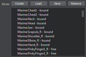

Body Hierarchy for Bones#
After a ragdoll has been created, all the bones that are represented in rigid bodies and shapes and specify their movement are marked as bound in the hierarchy. All the small bones not participating in physical body movement, stay marked as free. If automatically generated shapes are too loose, they can be tuned manually till approximation is satisfying enough.
Hierarchy of bodies and shapes that approximate bones can be saved into a .node and loaded from one. The set hierarchy can as well be removed from the ragdoll body and created anew.

Enabling Ragdoll Animation#
When the character hits some obstacle or, for example, he is shot and dies, it is necessary to turn off bone-based animation playback and simulate the character realistically falling according to the physical laws. When the Frame-based animation box is unchecked, ragdoll body is no longer driven by the bone transformations. It collapses according to rigid body dynamics (masses of all rigid bodies, that represent parts of a ragdoll, velocity damping, etc.), joint constraints and rigidity of motion.
Enabling ragdoll animation influences only those bones that were physically approximated. For example, small bones that were discarded due to volume threshold, will still move. To prevent this from happening, mesh animation should be stopped explicitly.

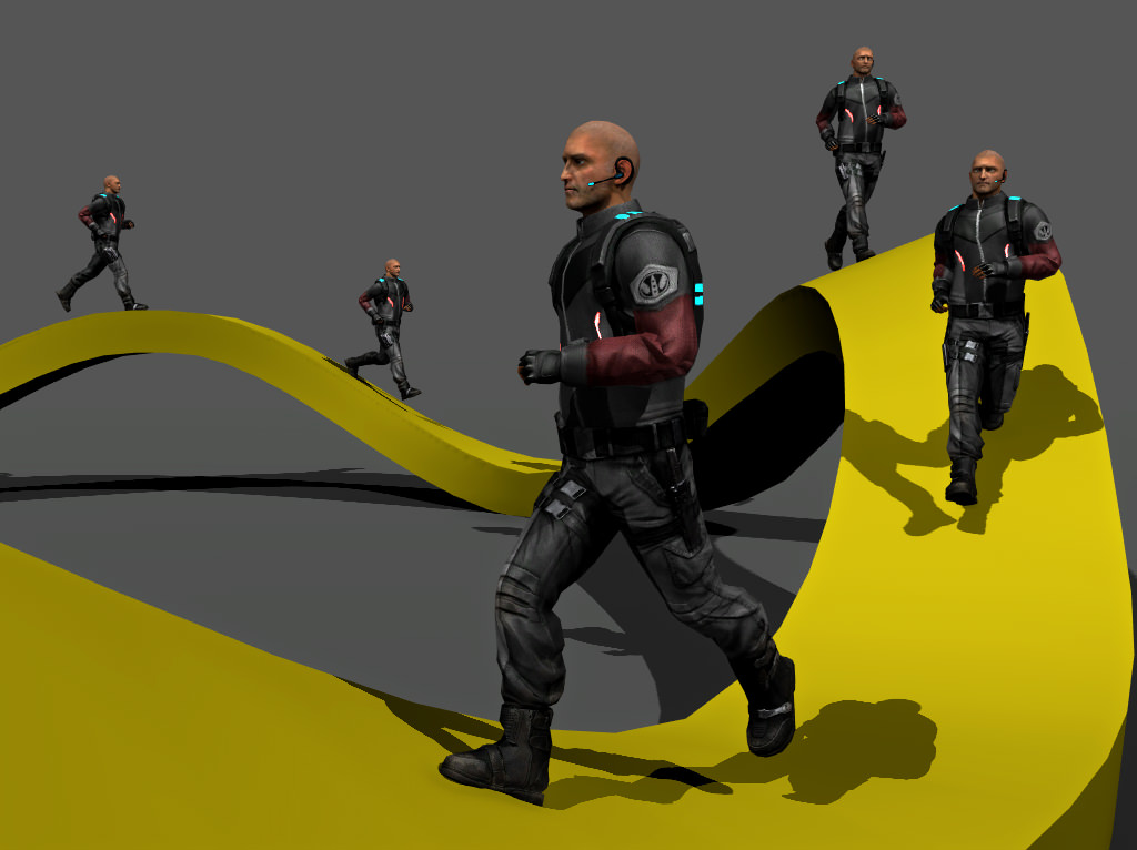

Combined Animation and Inverse Kinematics#
The problem with pre-backed animation is that it does not offer proper environmental interaction. For example, when walking up or down the hill, character's feet do not land firmly on terrain. Or as he climbs the ladder, the hands have to tightly grab the rungs. This effect is achieved with combined animation: motion animation is played for the basic bones, while smaller bones (feet or hands, for example) are simulated physically.
Frame-based animation can be disabled for each of the rigid bodies that approximate bones. Instead of following specific bone transformation, rigid body sags loose under its own weight and connects to collider objects underneath it.
For instance, physically-driven motion of the leg requires disabling bone animation of the whole limb: thigh, calf and foot. Inverse kinematics allows to properly position the chain of bones given the position of the lowest bone in the hierarchy, the foot. So when the character walks or runs, his foot collides with the ground, while the knee bends and straightens according to the joint constrain.
