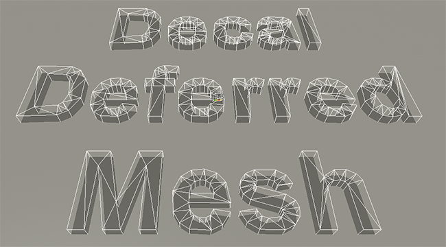

Mesh Decal
A mesh decal is a decal based on the arbitrary .mesh file and projected onto a surface by means of the orthographic projection.
  • The mesh that is used for projection should contain a single surface. In case if the mesh contains several surfaces, only the one with the 0 index will be used. Thus, the area of the decal will differ from the initial mesh.
  • The decals are always of the same size regardless of the projection box location relatively to the projection surface.

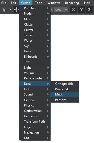

To create a mesh decal:
  1. On the Menu bar, choose Create -> Decal -> Mesh.

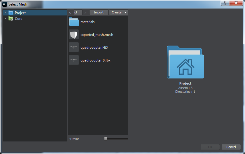

  2. In the file dialog window that opens, choose a mesh for the decal:
    An exported mesh should have less than 10000 polygons.

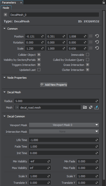

Editing a Mesh Decal#
In the Node tab of the Parameters window, you can adjust the following parameters of the mesh decal:
Node tab
Decal Mesh#
Projection parameters of the mesh decal:
Radius The height of the projection box along the Z axis, in units.
Radius = 10
Radius = 20
Mesh Path to the .mesh file on which the decal is based.
