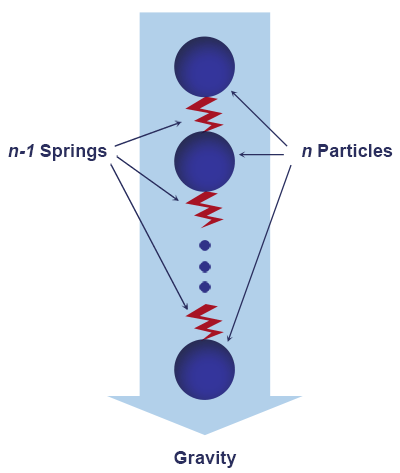

Mass-Spring Simulation Model#
A rope body is modeled as set of point masses (particles) located in the mesh vertices. Each particle is represented with a sphere shape and is linked together with other particles by inner spring joints that are located along the mesh edges. Inner joints allow to recreate mesh topology, on the one hand, and constrain stretching and folding, on the other.
Each particle is characterized by a position, mass and velocity and has a constant spherical shape with a set radius. The total mass of the whole body is equally distributed among them. In accordance with Newton's second law particles can be acted upon by a force or an impulse applied by inner joints and external forces (collision, gravity, air resistance, wind, etc.).
Self-collision of the particles and collisions between different cloth bodies are not calculated. However, the cloth interacts with environment by colliding with other physical bodies if Collision box is checked. Its behavior in case of contact is controlled by such parameters as friction and restitution. Selective physical interaction is available via corresponding bitmasks
Thus, rope body can be regarded as constrained system of rigid particles and therefore shares some parameters with rigid bodies:

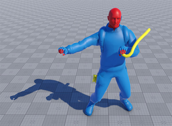

Attaching a Rope#
Rope attached to a skinned mesh
Rope attached to animated character
Ropes can be attached to the following types of bodies:
To attach a rope to a body use a particles joint. In case of rigid bodies (either static or dynamic) and dummy bodies, pinned particles stay fixed in their position and follow transformations of attached objects pulling the rope with it.
  1. Select a rigid body, a ragdoll body or a dummy body.
  2. Add a particles joint.
  3. Specify a rope body.
  4. Adjust the pinning area using threshold and size parameters of the particles joint.
To ensure stable simulation it is important to set appropriate masses of the rope and the attached body. Unbalanced masses may cause twitching of rope joints.
Attachment to Skinned Mesh#
Convincing simulation of the rope on a skinned character requires a different approach. To follow bones transformations, each vertex of the rope that is found in the particles joint area is mapped to the nearest skinned mesh vertex (up to the distance specified by the Threshold parameter of the particles joint).
It is not recommended to attach the rope directly to the skinned character, because difference in topologies may result in visual artifacts. Instead of it, it is better to create an identical rope surface on the skinned mesh character, make it invisible and attach a physical rope to it.
For example, we need to create a rope that is glued to the hand of a skinned character while the rest of the rope hangs and moves loosely. It is done in the following steps:
  1. When creating a skinned mesh, add a rope segment surface identical to the clipped part that needs to be pinned. In our case, it's rope part in a hand.
  2. Add skinned mesh that has a ragdoll body assigned. Make sure that the rope segment surface is enabled.
  3. Add a separate dynamic rope mesh and synchronize its position with skinned character. Turn off physical simulation (CTRL + SPACE) and assign a rope body.
  4. Attach rope body to ragdoll body. If the Threshold distance of the particles joint is set low enough, the physical rope will be automatically attached only to the rope segment surface (i.e. hand). After that, the rope segment surface is simply disabled and does not provide any load at all.
